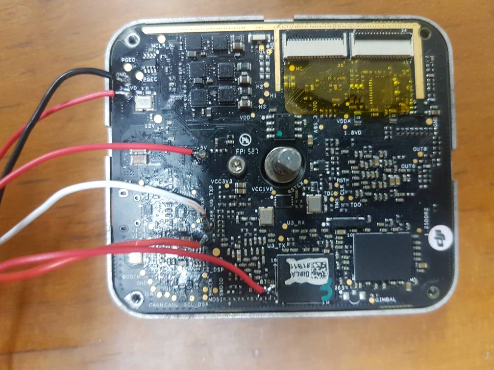

I try replace with another P3P gimbal borrow from my fried it's can work normaly and showing the video on display. How to check the mainboard gimbal is broken?
Reactions: JoBe

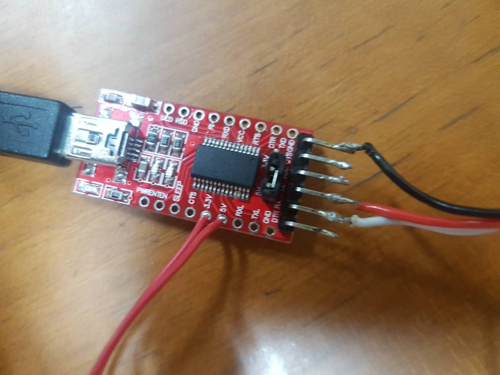

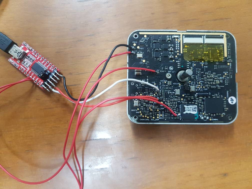

please any one can share video with this problem.. and how to flash and what's the software tools, need full help. my gimble is not showing video.. please help me.
