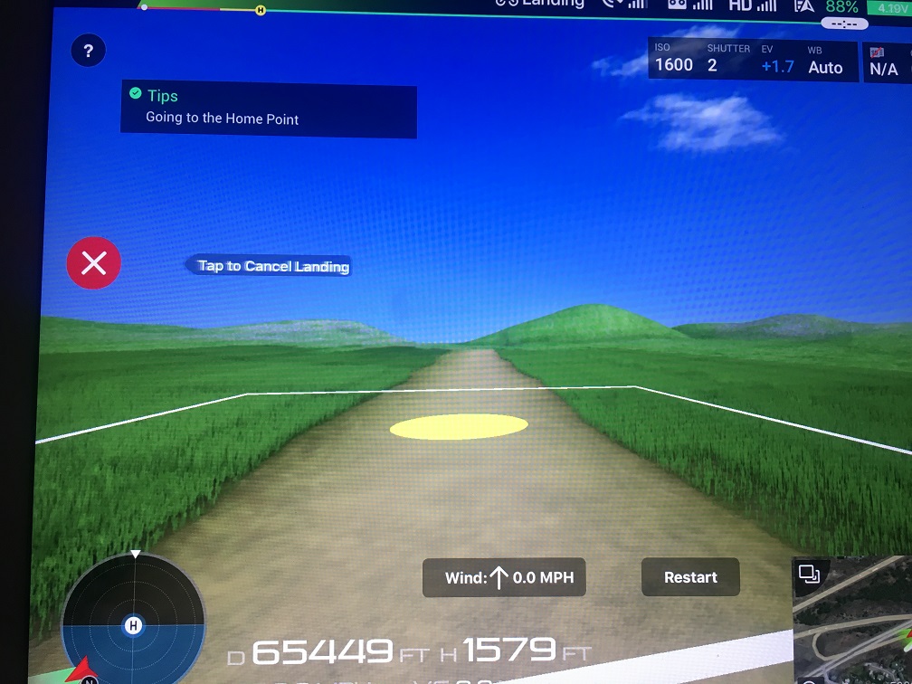

I was testing the 65449 landing issue in the simulator and couldn't get it to stop. not smart enough..That's another issue id like fixed....

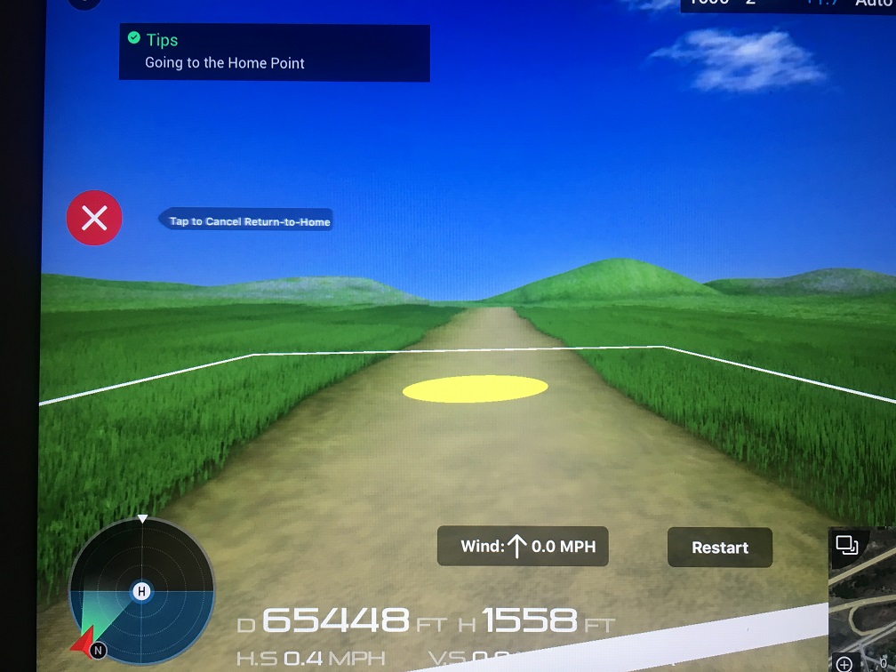

Yeah that was the first one I tried and it didn't work...I even found the exact distance it changes from go home to land in the simulator to see if i could find it in there ...65449 = land and 65448 = go home...
View attachment 80846 View attachment 80847

This number(65449) seems too close to 2 ^ 16 (int32) to be a case.
Maybe there is an overflow problem in the code....

If you look at the pics i posted it says under "tips" Going to home point even though its landing that's a little odd...
