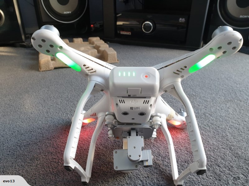

It shows solid red and slow flashing geen.Motors wont start.

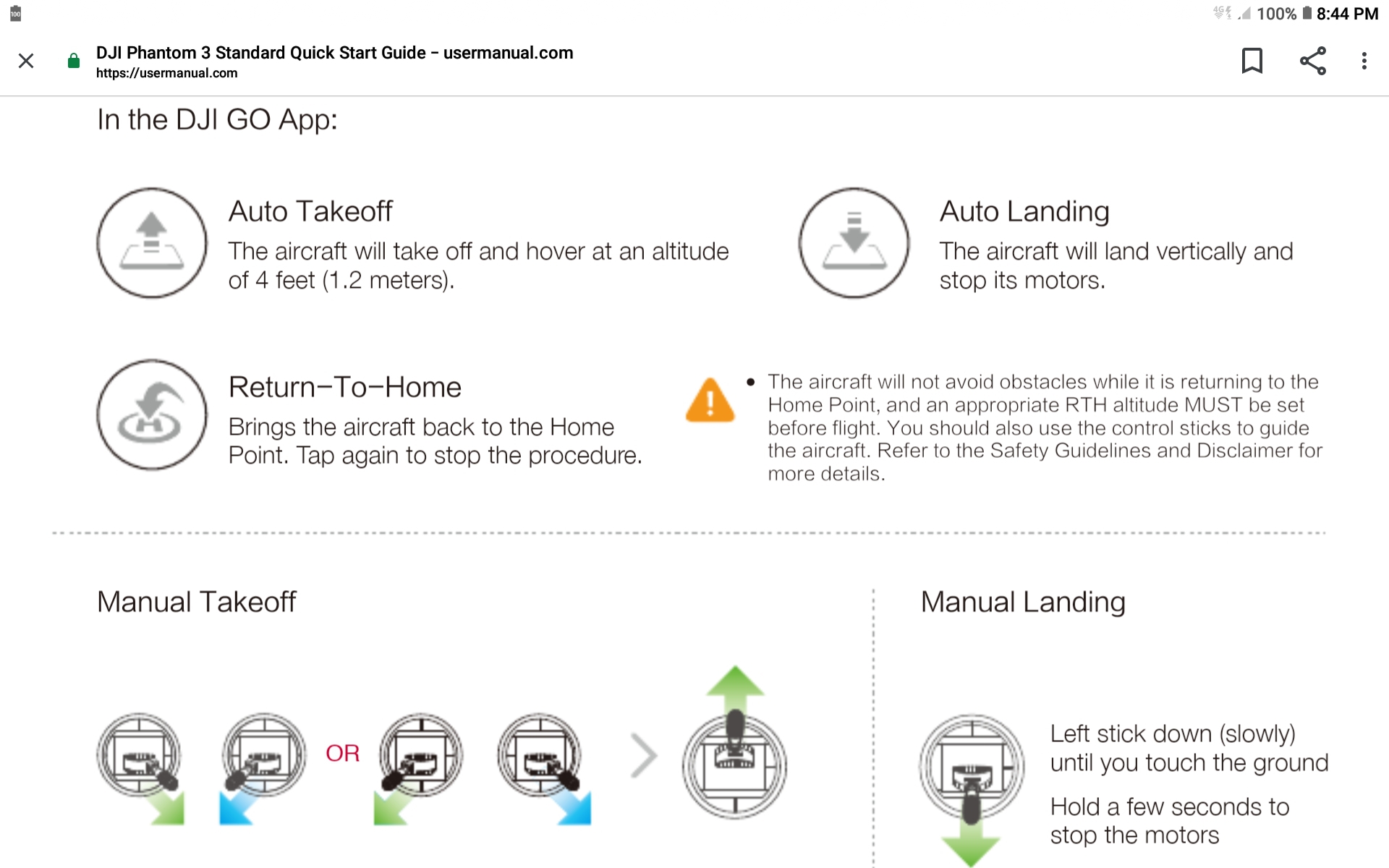

Ok front lights are always red,slow flashing green is GPS and ready to go,,did you get any book with it,,it should have come with quick start guide,,,,are you trying to start correct way....

Have solid reds front and slow double green at rear.
Does everything but power up the motors at this stage.

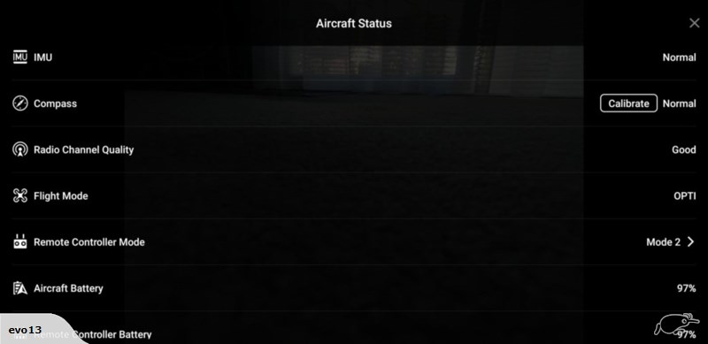

Its all back together and all systems are go except take off lol. 'GPS unconnected' message pops up when I try to start the engines.
Would the drone normally fly without the gps or is this a definate non starter ?
I think he means switch it to ATTI on the remote?
But, I'm sure you can start the motors no matter what the remote setting is, of coarse not auto take off.
But #2,
'GPS unconnected' could be different then no GPS signal, when starting the motors?
Anybody else got some thoughts?
