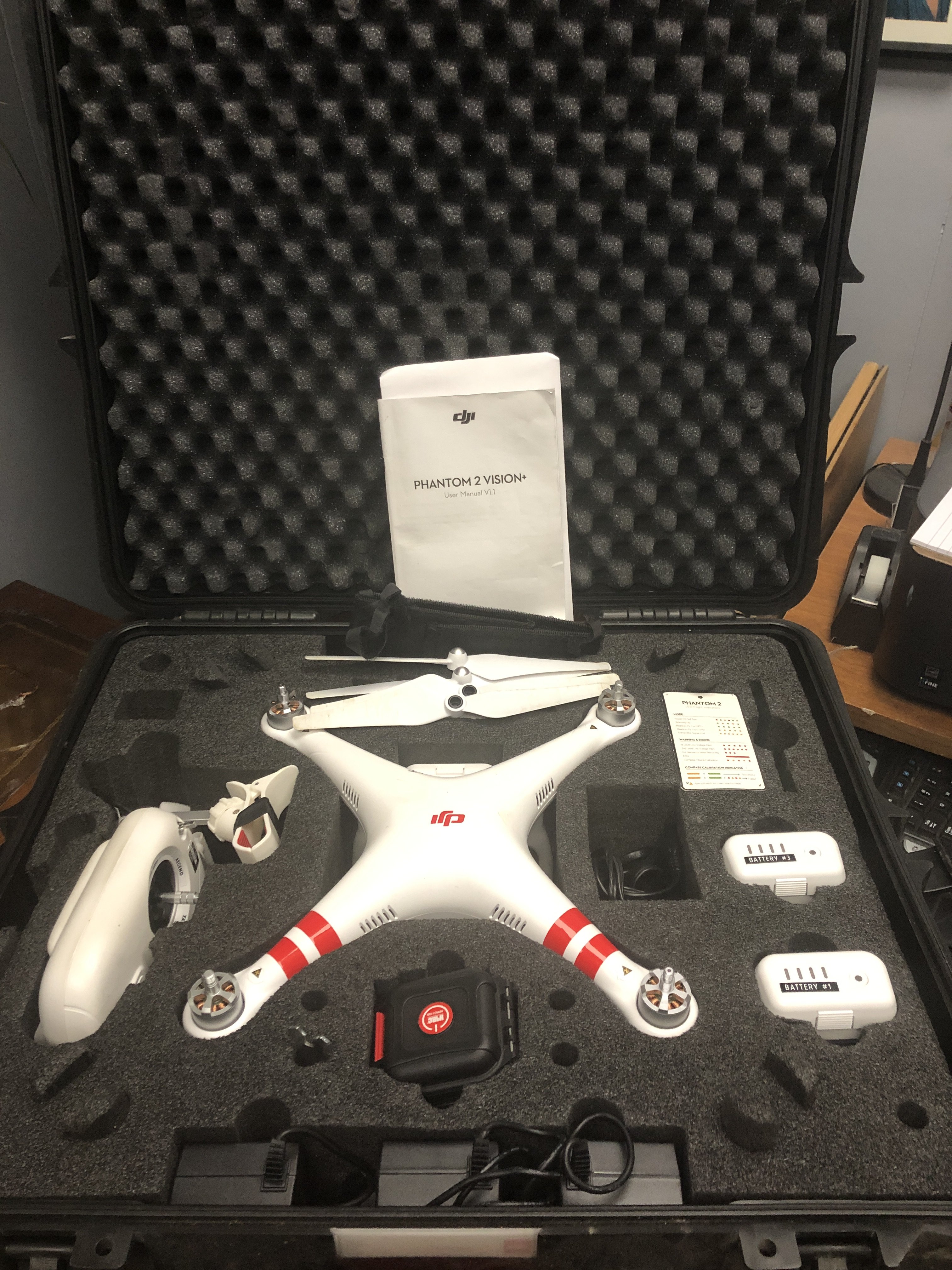

Hi, I was given a p2v+ recently but there is no wifi signal to connect to. When I try to power on the wifi extender, the power light comes on but not the system light and I was wondering if that had anything to do with the issue involving the wifi signal.
Any help would be appreciated
