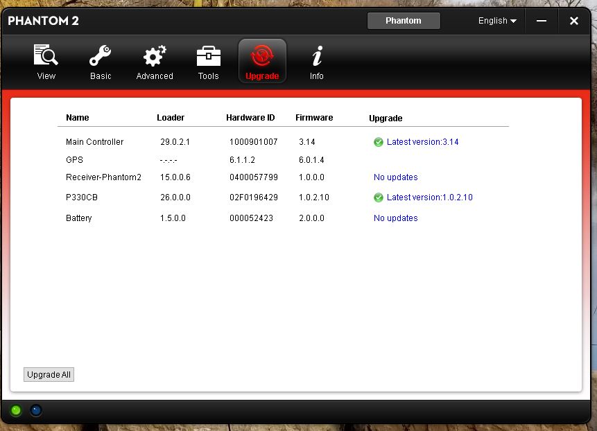

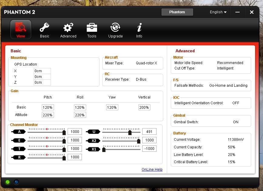

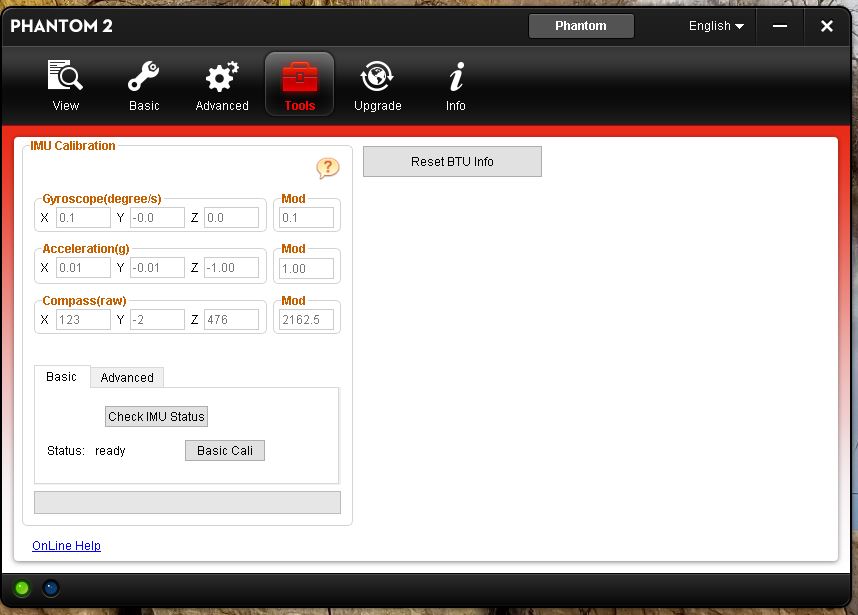

Bought a used (crashed) Phantom 2 and looking for help to get it back in the air again. No structural damage – previous owner said it just didn’t fly right. The gimbal would not initialize so I unplugged and removed it – I’ll tackle that later. I installed batteries in controller/drone and controller binds with drone and motors spin up (no props).
I loaded DJI RC System Assistant and checked and calibrated the R/C stick movement – everything worked fine. Loaded Phantom 2 Vision Assistant and the P2 system software is up-to-date and stick movement looks fine. I downloaded the P2 manual and read it (more than once). I opened Drone up and looked at all connections to make sure everything is connected – it is.
The Drone’s previous location was about 300 miles from me so I want to do a Compass calculation before I fly it. Compass calculation is failing (I think) because I can’t get a GPS lock on condo second floor balcony so I will try tomorrow in a wide open space.
I’m also including Vision Assistant screen shots. IMU Cal numbers are not great but I didn’t want to change too many things all at once. I clicked on the Check IMU Status button and the DJI message is ‘no calibration necessary’.
So, I’m looking for suggestions on what else I should do before taking this out for a first flight.
Thank you.

The first thing you need to do is an advanced IMU calibration as the compass MOD is off the scales and should be between 1300 - 1600 no higher or lower. This should be done on a level surface. GPS has nothing to do with not being to get a green LED when you've completed the compass calibration and it may be due to the high compass MOD reading of 2162.5 causing the problem. If you're trying to do compass cal is not a good idea and even if you to complete the cal you will not get a GPS lock inside.
Another reason you may not be able to complete a compass cal is that the magnetic compass on the leg of the P2 is magnetized and therefore the reason for the high compass MOD number. The following video should help with that:

The Compass MOD numbers of 2162.5 have no relationship to the GPS and are strictly a compass problem. That is why I sent you the video on how to demagnetize the compass if you cannot lower the number between 1300 - 1600 by doing the advanced IMU.
After watching that video I purposely magnetized the compass on my own P2 while connected to its software just to see how actuate the process was. Well, it wasn't easy but it does work in being the compass numbers back to normal.
I have owned my P2 since March of 2014 and have had it apart more than once to help others with one problem or another. With over 20 years repairing electronic equipment I have 95% track record of helping others put theirs back in the air,

The 2162.5 MOD numbers are for the Phantom 2 shown at the beginning of this thread. I had a compass problem but I did the IMU and Compass cal out in a grassy field. Everything is good with the Phantom mentioned in this thread.
