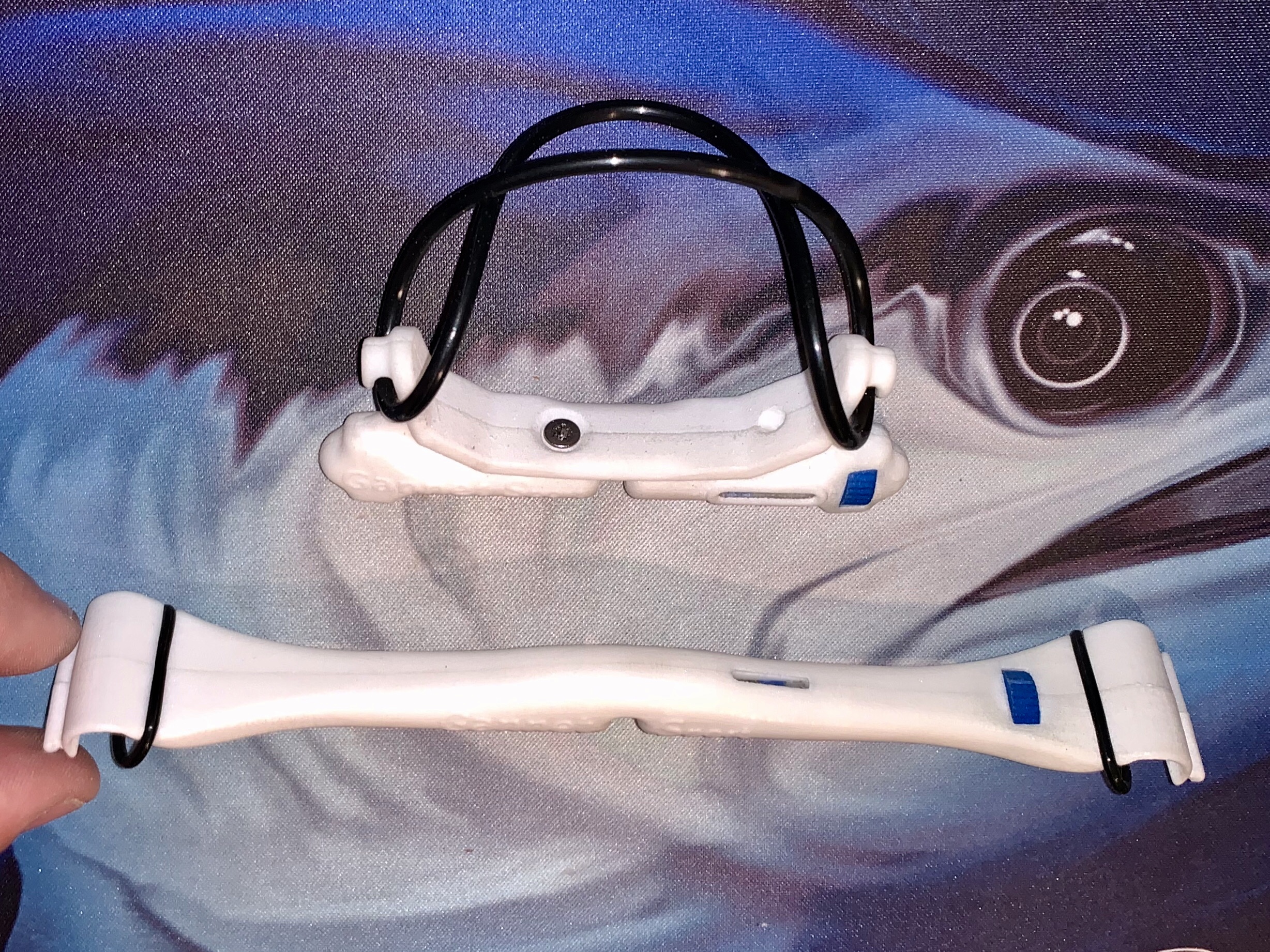

IIRC, the ones offered commercially used underarm LEDS to actuate. The P2s did not have an option to switch the (front) LEDs on/off to actuate these systems.
