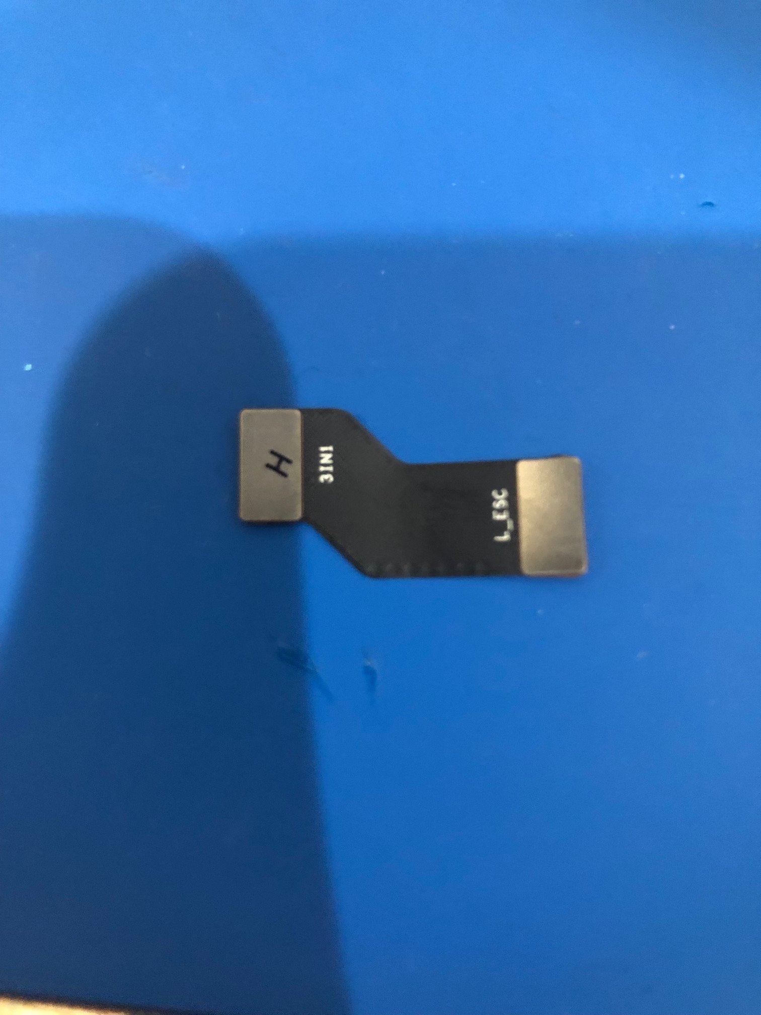

that is a great way to solve the problem. Here is a photo of the cable I was talking about
My ESC does not have that cable That one has a plug on each end and i have seen them on boards that are supposed to work with my drone but mine has a ribbon cable and a ribbon end on it not a plug on.
here is a photo of the esc with the cable attached. I would check this cable
My bad, for some unknown reason I thought you had a P4P. The P4 is different. You have an amber colored ribbon. I would still check that ribbon but it is probably the ESC board. I would replace the ribbon first. I have lots, Can I send you one?
