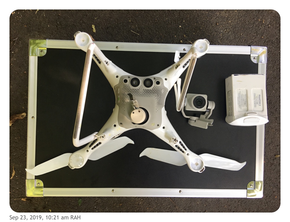

My Phantom 4 pro version 2 fell from the sky while hovering. How can I get the data needed to determine the cause?

TXT file is attached. Thank you for your help.Post the .txt file here.
Perhaps someone can spot something in there.
In cases of sudden loss of power, it can be difficult to find the smoking gun evidence, but at least it might help to dismiss some possibilities.
