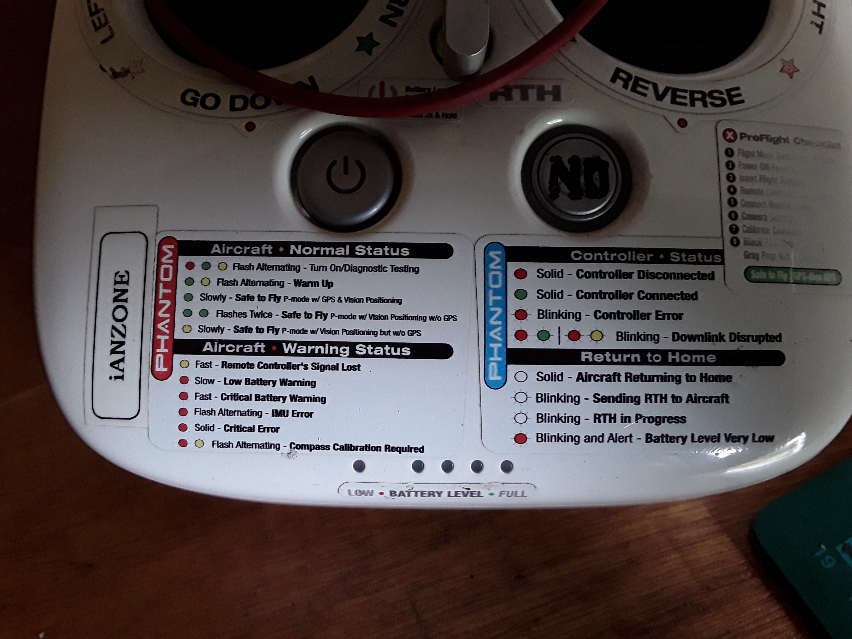

The LED on the front of my controller, left of the battery status lights, is red and the two P4P rear lights are both blinking fast in a white-ish color.

Fast yellow flashing lights mean "Remote controller signal lost."

I had tried re-linking as shown on pp 42-43 of the user manual, and even saw the confirmation message that said, "aircraft linked," but still showed aircraft disconnected. But after rebooting both the P4P and th RC they connected! I'm not sure what caused them to lose the connection, but happy that they are connected now!
