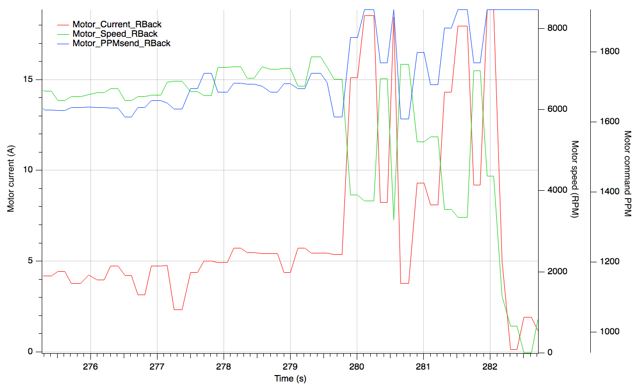

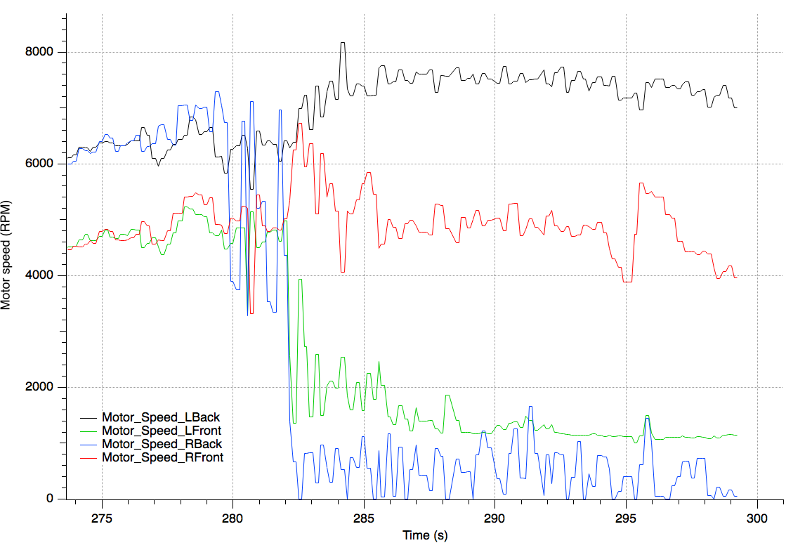

Interesting. It was the rightBack that had the propulsion issue though. MotorCommanded went to 100% and motor Speed was reduced.
Reactions: sar104
Agreed, but that is not one I've seen before:
Looking at the right rear motor in more detail:
The problem appears to start at 279.77 s, with simultaneous drop in motor speed, increase in motor command and increase in motor current. That suggests a motor obstruction of some kind.

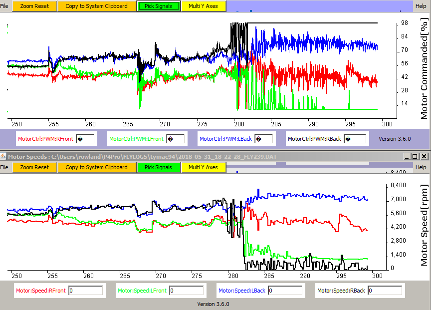

The aircraft DAT file with much faster logging would be more useful here.
Dropbox - MCDatFlightRecords.rar
That's all of my DAT files from today and I only flew once today

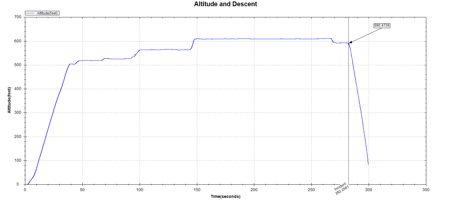

You mentioned that you were at 600 ft so wind did become a factor. So if you were flying fast , there is a chance that the one of the props swept down and hit the top of the drone, That would be enough for it to crack.
But for that to happen you would have to been maybe in sport mode and heading into the wind. Just a thought being as high as you were .

Battery Disconnect is more likely than a BB Gun shooting it, Did it actually drop from 600 ft or was it on its way down ?

You really need to read the thread - you are just confusing the issue. The motor data clearly show that the problem was the right rear motor. The photo in post #8 shows that the rear right prop was intact; the only broken prop was front right, which therefore must have happened on impact. This was not a propeller problem.
I am just not a big fan of the crash being a motor problem as they fluctuate all the time, so this is why I look at the Props and the battery so closely. I also have to keep in mind that Motor failure means Zero Propulsion and that is not the case either so I am looking and reading between the lines. Good luck.
