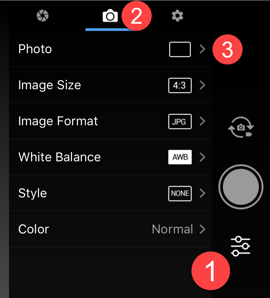

It's actually a little tricksy. It isn't a "Flight Mode" it is actually a "Shooting Mode." i.e. you'll find it in the same place as you find "AEB" or "HDR" shooting modes.
Go to-
  1. Camera Settings
  2. Camera icon tab
  3. Photo type
  4. Choose Pano and select type
I just updated DJI Go 4, and I don't see this option. Is it only available when connected to the AC?
Lefty, did you update the firmware as well as the app? The functionality was added to the Phantom 4 Pro in the firmware upgrade, so you need that as well as the latest DJI Go 4.
Which version firmware? I just bought a P4P off ebay, and updated the firmware to V 01.05.0600, I think. The remote was updated too. Now reading about this Pano mode, I wanted to give it a try. So I updated my app last night, and nothing.
Hmm, that firmware should be good, it is Firmware v1.05.0300 added the mode.

Turns out, I just had to be connected to the AC. Once I was connected, then everything was all good as far as the pano mode. Just waiting for the weather to break before flying it.
