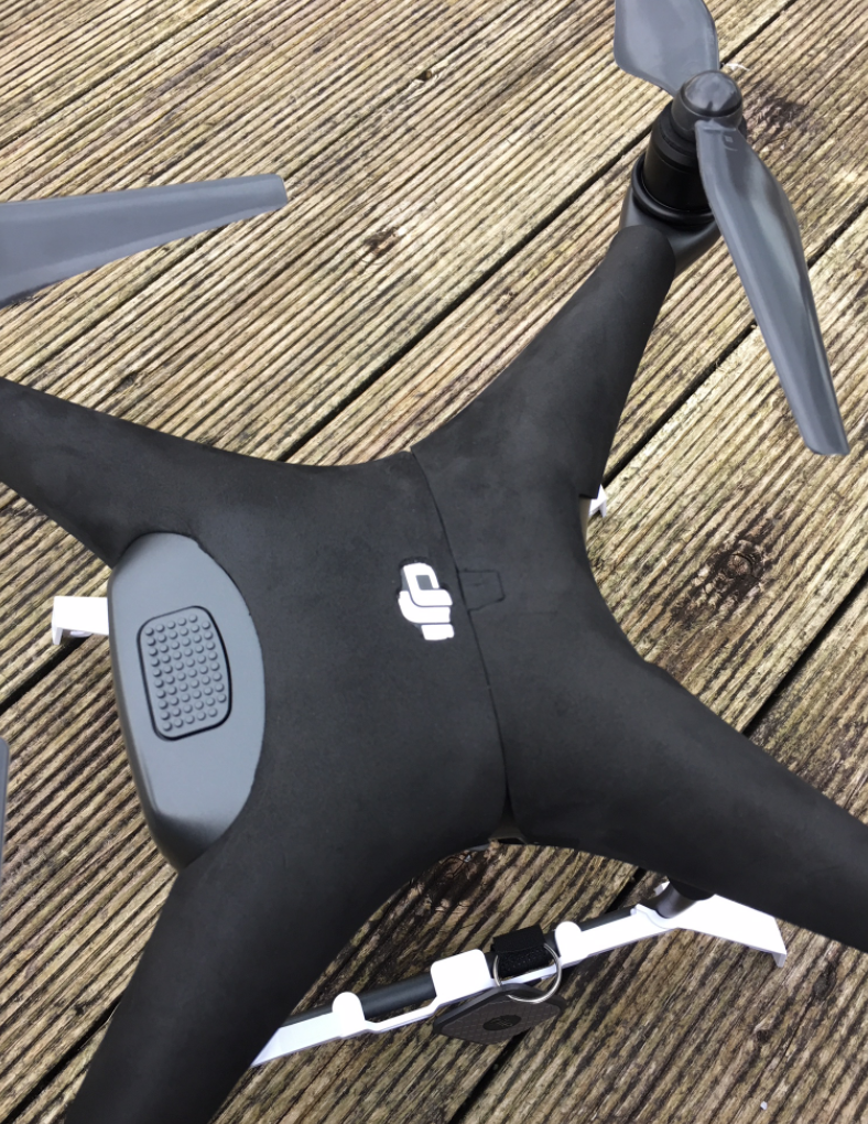

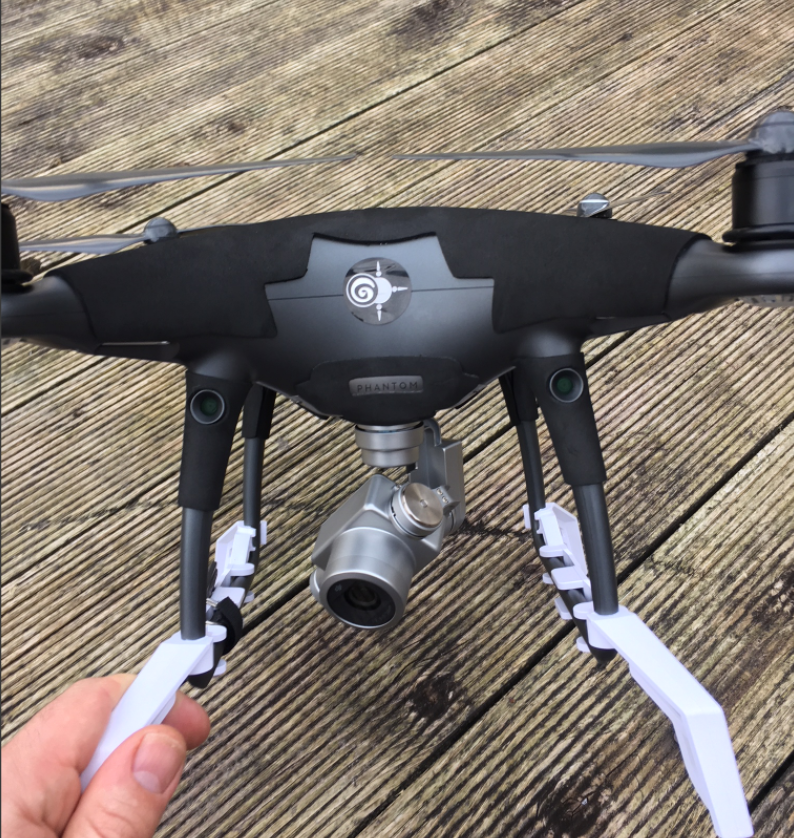

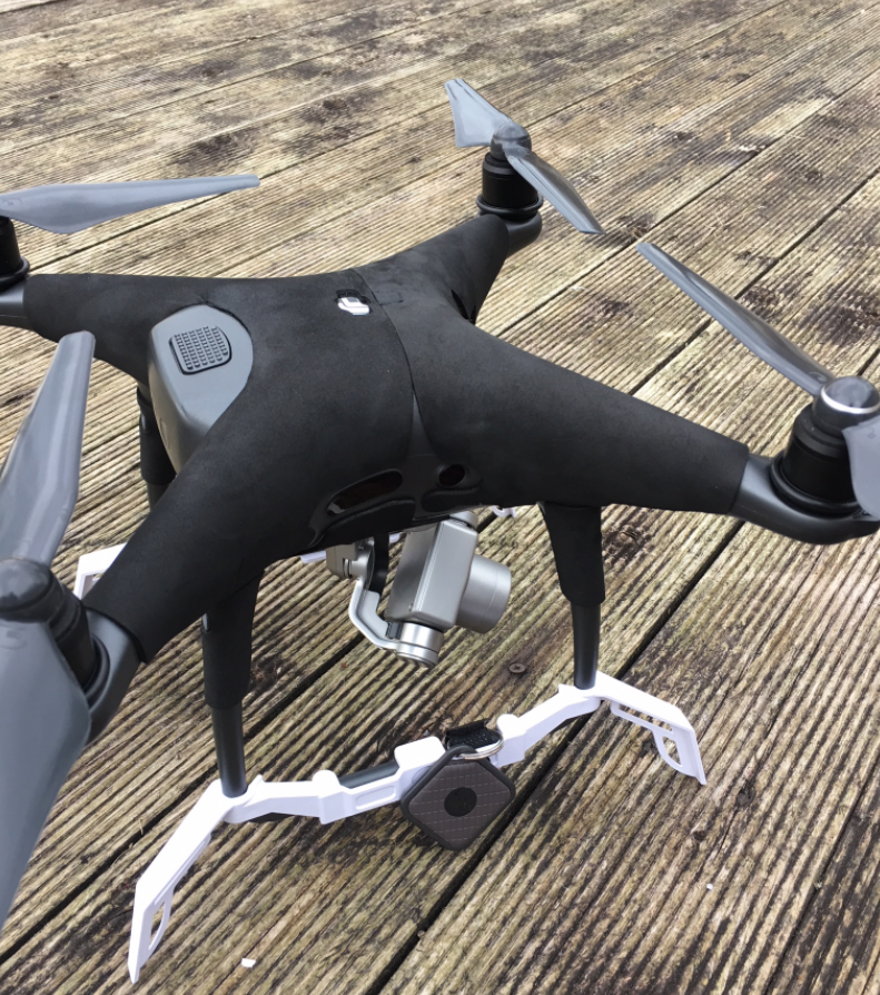

You mentioned that the drone sunk 40 ft and so take a look at the New Tile App now 100 % water proof and now good up to 200ft away using the blue tooth app.
You can check it out in the picture below geared up with the Wet Suit , looks stunning I think. Black on Black with a loud beep to help you find it if you remote land or go in the drink.
I hope DJI gives you the 100% replacement coupon to get another one.
Once we add the Light to this one , we are ready for search and rescue , lol
Getting that battery secure is top priority when flying fast and furious , as i have read some people claiming that when the come to a quick stop in sport mode
that it can crack the frame at times, and many pictures have been posted .
So stress on the frame seems very possible and likely a cause for the battery disconnect,
