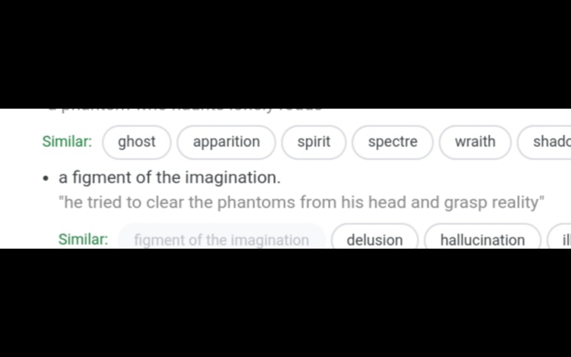

Yeh phantom ,,,until we grasp reality it's a guessing game,,still working on a prize lol
