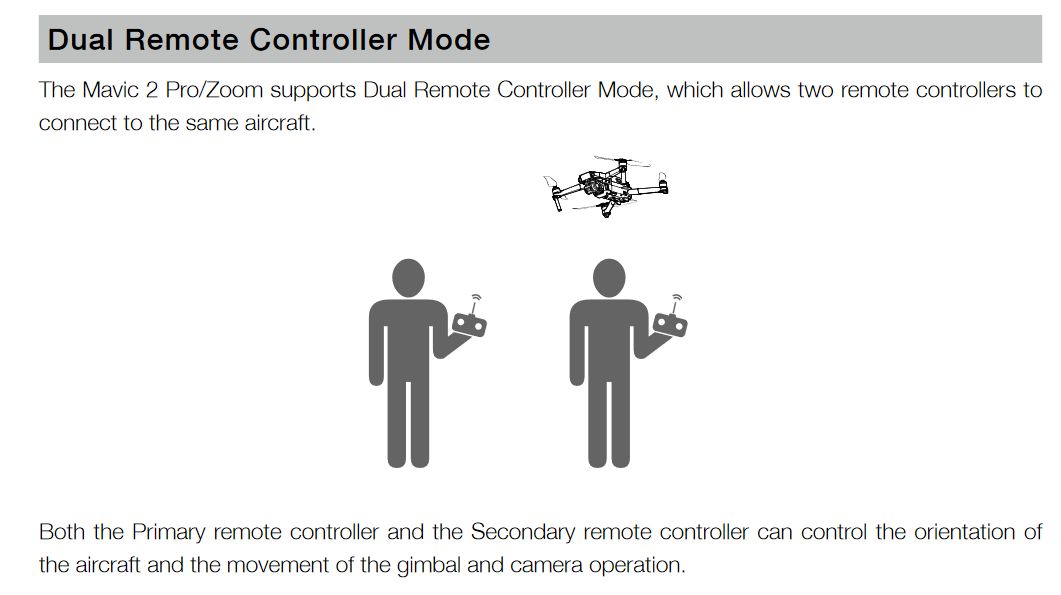

I suspect the same behavior as the Mavic 2. Have a read in the manual at page 46.
As suspected. The V2 does have these abilities similar to the other dual controll DJI systems. Primary is just that. It overrides controll inputs from the secondary. Camera functions are available through the secondary. If there are controls that are not available, I’m not aware.
I did all this by myself, so I could have missed something.
