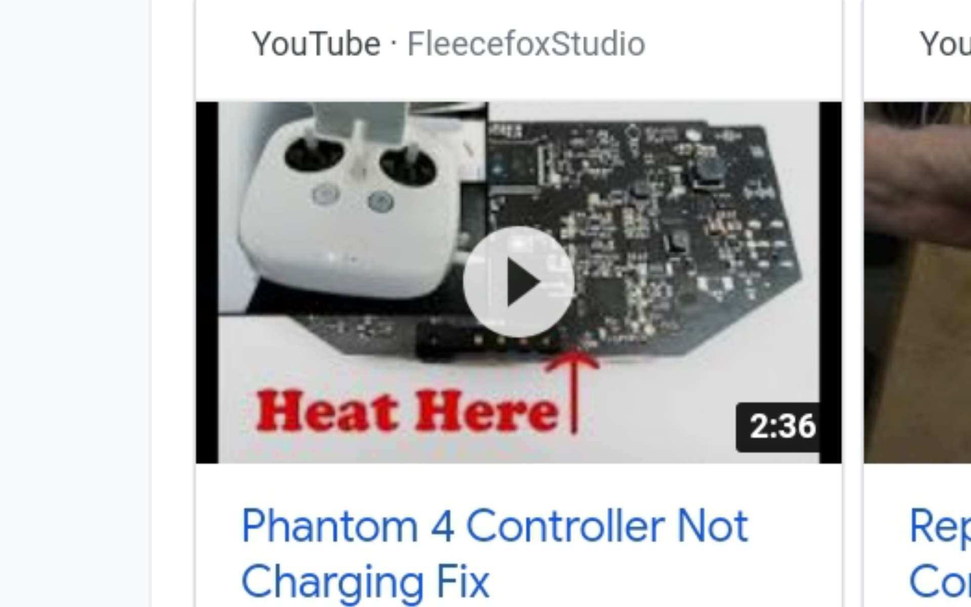

As above it sound like charging board in remote,,if open again check with multimeter on battery ,,fully charge I think is 8.4 volt ,,its 7.4 volt battery but reads 8.4 fully charged ,,utube clip shows which area of board to heat,,below shows area ,,search this on utube

As above it sound like charging board in remote,,if open again check with multimeter on battery ,,fully charge I think is 8.4 volt ,,its 7.4 volt battery but reads 8.4 fully charged ,,utube clip shows which area of board to heat,,below shows area ,,search this on utube View attachment 122659
That's the spot. I just used a little cardboard to block the heat from getting beyond the area I needed to heat. I adapted my heat gun with metal tape and a concentric pipe. It went perfectly.
How long has your reflow lasted? Mine would work for a while and then back to charging to just 76%...and although it said it was charged to 76%, I could only fly 4 batteries and then the RC would be dead. I reflowed 4 times. I finally sent it back to DJI, and even though it was purchased in '17 they replaced it with a new one for $90.
