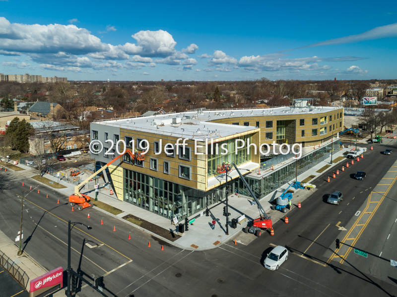

Further update. Took the P4P 1/2 mile from my house to shoot the nearly finished construction of a new neighborhood library.
No errors. GPS locked in under 30 sec. flew just fine.
