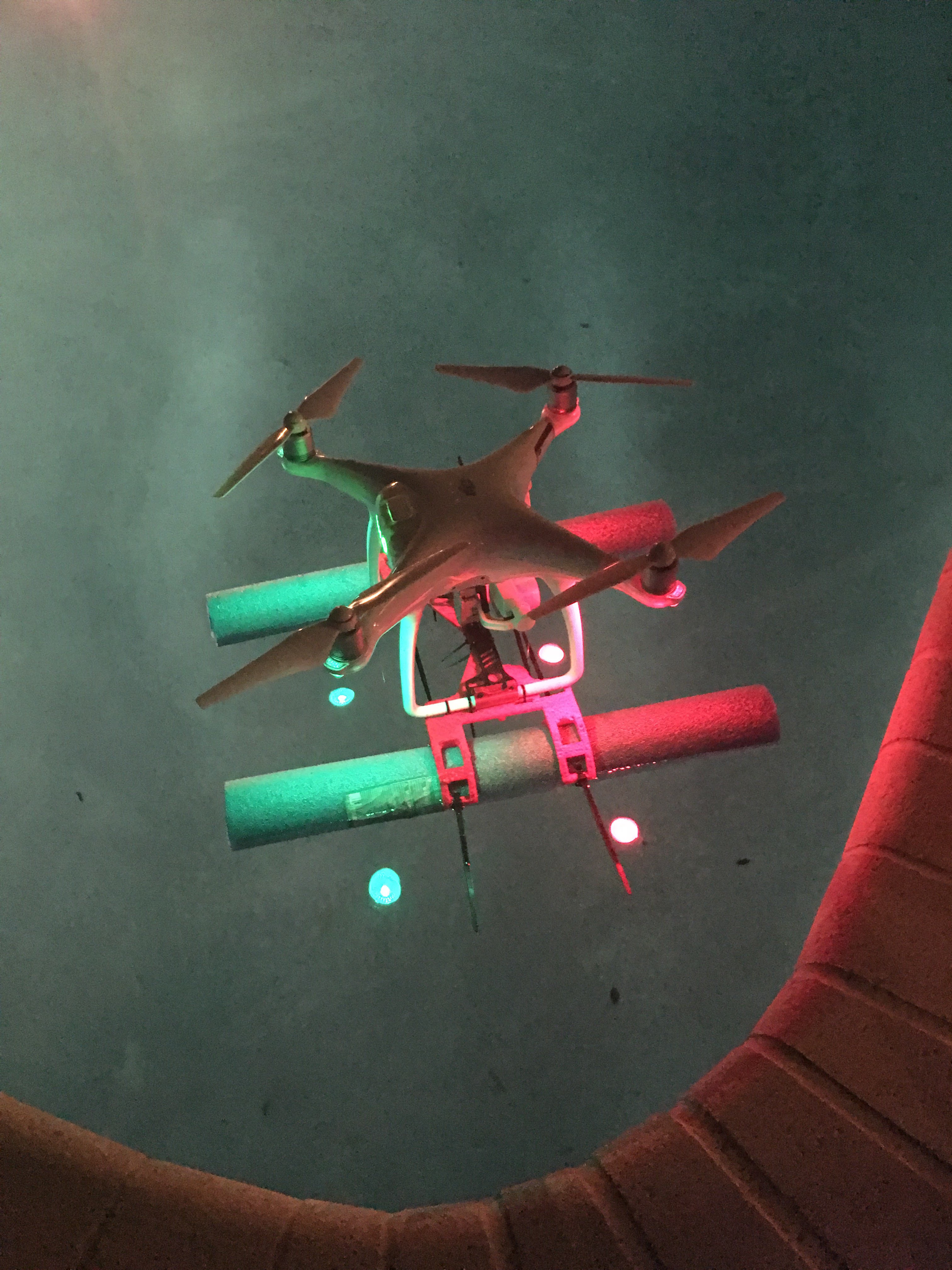

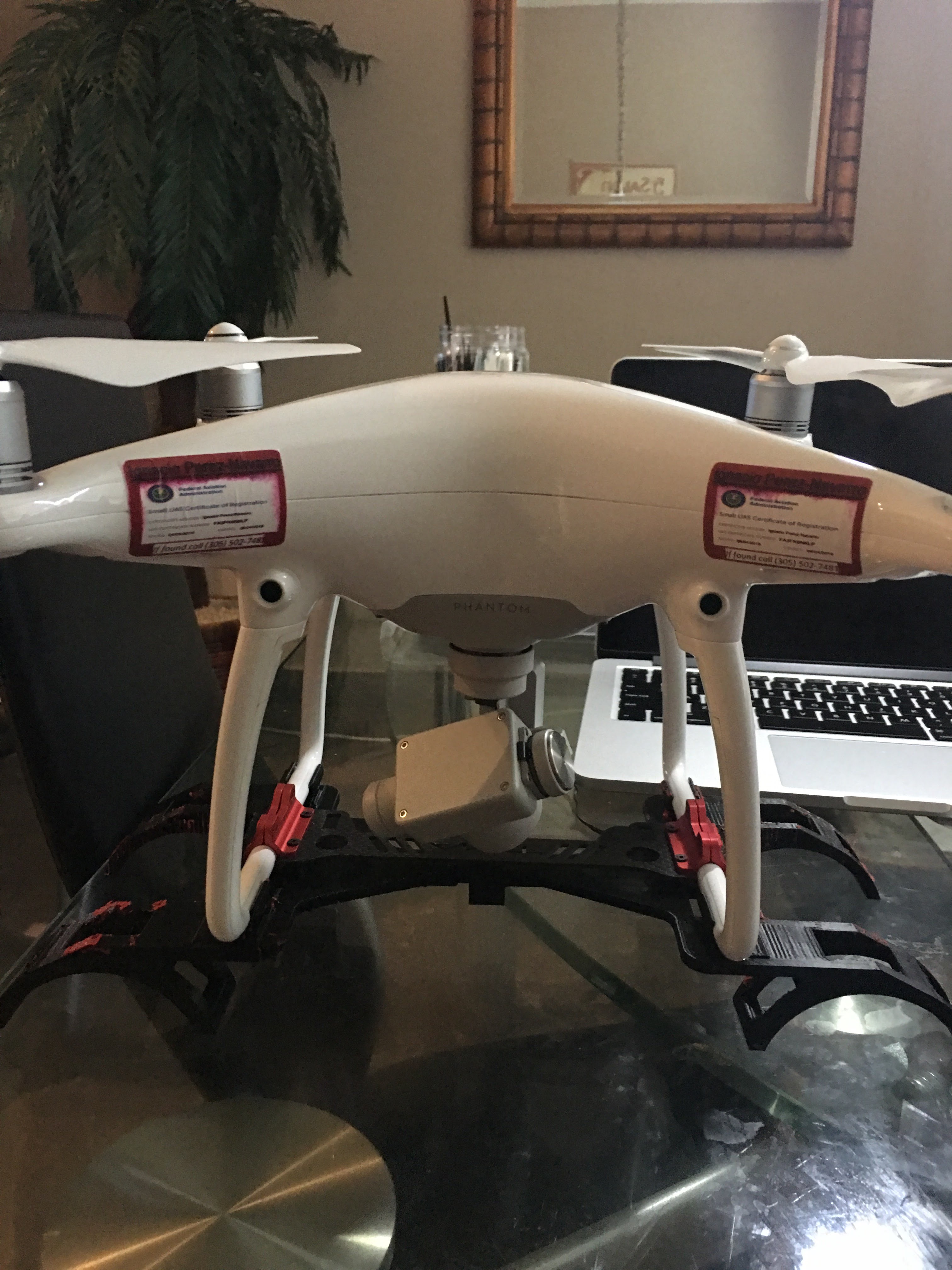

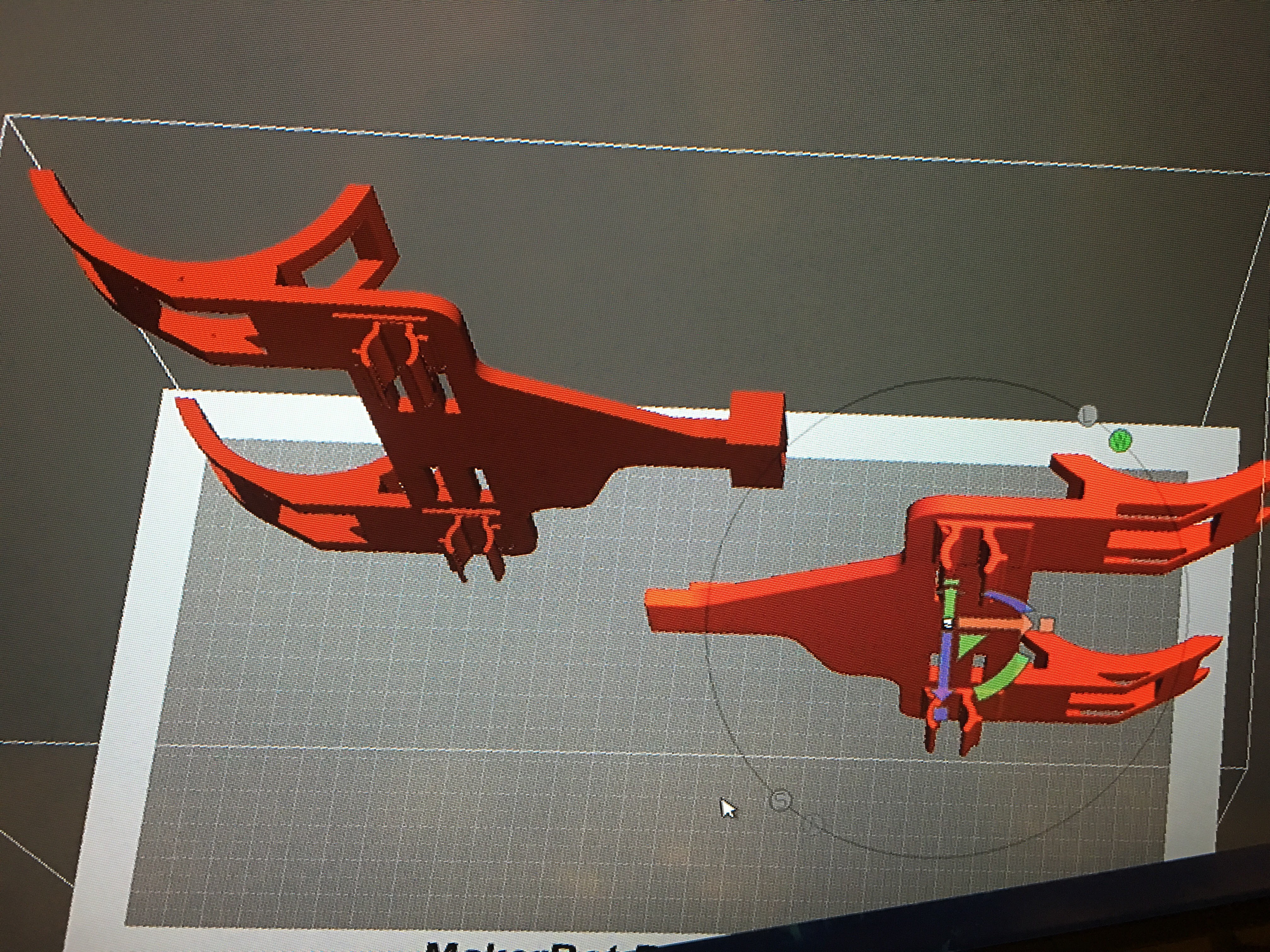

i printed this bad boy w. the 3D printer, attached some foam pool noodles and it worked great. however, personally, if i was launching from a boat, i would still hand release and catch .
View attachment 70590 View attachment 70591 View attachment 70592
