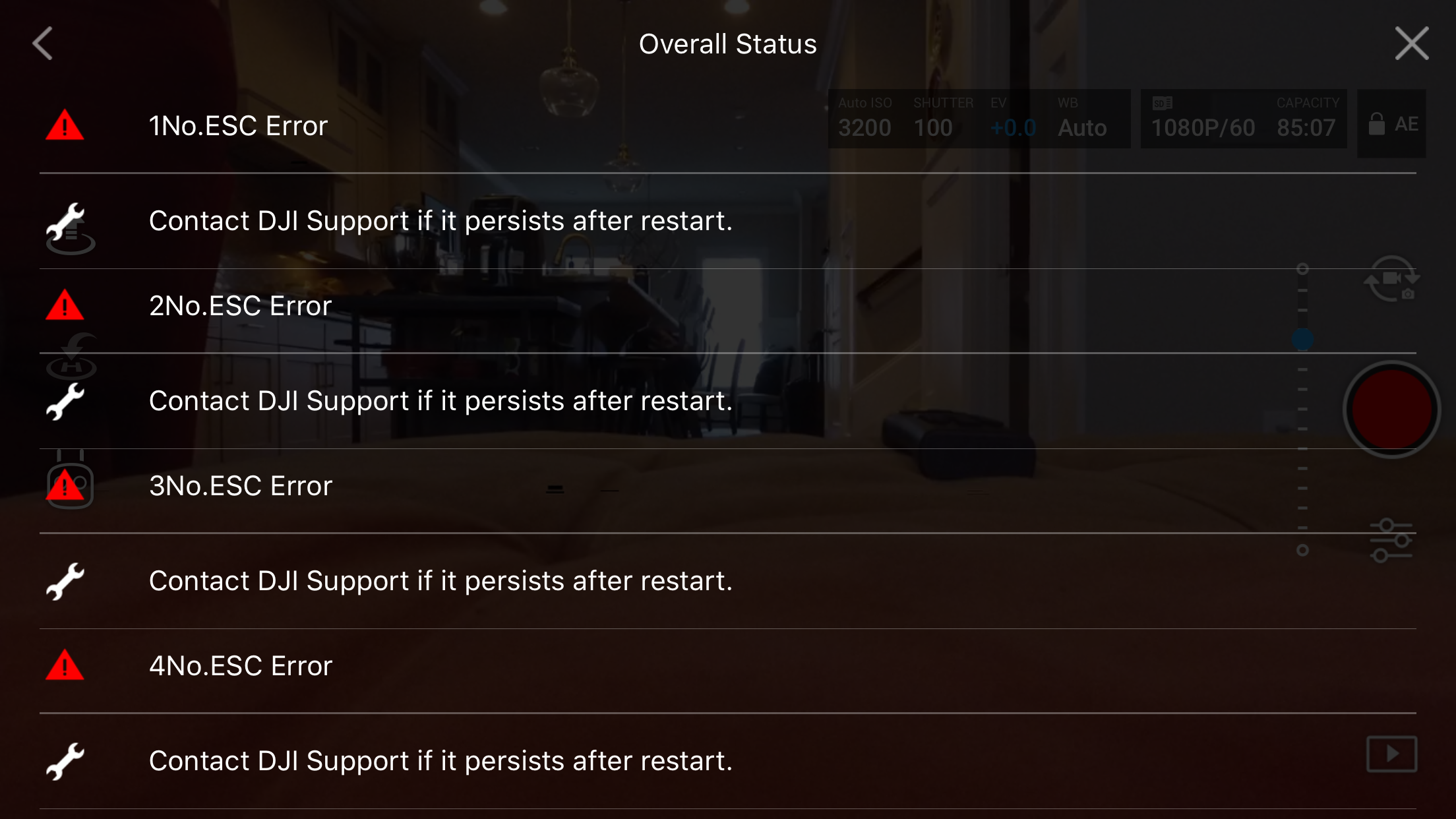

so just now I fired it up inside the house, no props, just to see on screen if errors pop up and ESC errors popped up, after quick search here it seems like these are less understood and restarting may or may not clear the issue?

re -reading my original post I see one detail I forgot, when the bird activated the props while I was calibrating, one of the props flew off. I have no idea if I didn't "lock" it in properly, usually very **** about that. Would that be related to the ESC errors?
the props need to be on, with no resistance you will get a error message
ok, good to know, kind of afraid to put props on though without knowing if I accidentally hit auto take off (never have used it) while doing the calibration
guess I will bite the bullet and put props on while outside, thx
