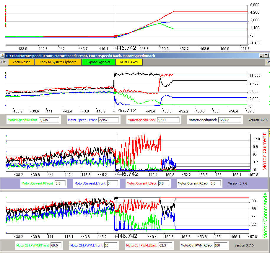

Looks to me like the righttBack propeller went missing. At time 447 secs the time integrated gyro data shows the P4P began to tumble by rolling CW, pitching up end over end, and rotating CW about the z axis. These are all consistent with the rightBack losing propulsion. Also, the right back was being commanded 100%. The motor current data shows that the rightBack was drawing close to 0.0 amps indicating there was no propeller

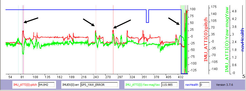

Actually I came across a discussion on dji forum where you took part and explained in detail how flight data is derived from set of sensors and how a navhealth can be behaving in case of f.i. not properly calibrated magnetometers. Very usefult and substantive one. I realized how a compass calibration affected by additional factors can impact a drone behaviour. In a log I attached, like 15 seconds before it began rolling, navhealth went south. are you able to assess what was the reason of it?

I don't see a link to the uploaded .DAT. Am I missing something?
OK, I get it. The .DAT in your original post also contained an example of the navHealth problem you were describing. There were other parts of this flight where a Yaw/magYaw separation caused problems. They just weren't bad enough to cause the FC to set navHealth to 0. I like to look at IMUEX:err that will sometimes show problems the FC sees but doesn't decrease navHealth.
These seem to be associated with the higher pitch angles. There also seems to be some correlation with Yaw as well. I'm gonna ask @sar104 to take a look. The analysis software he uses can better tease out the relation between attitude and the Yaw/magYaw separation. Have you calibrated the compass?

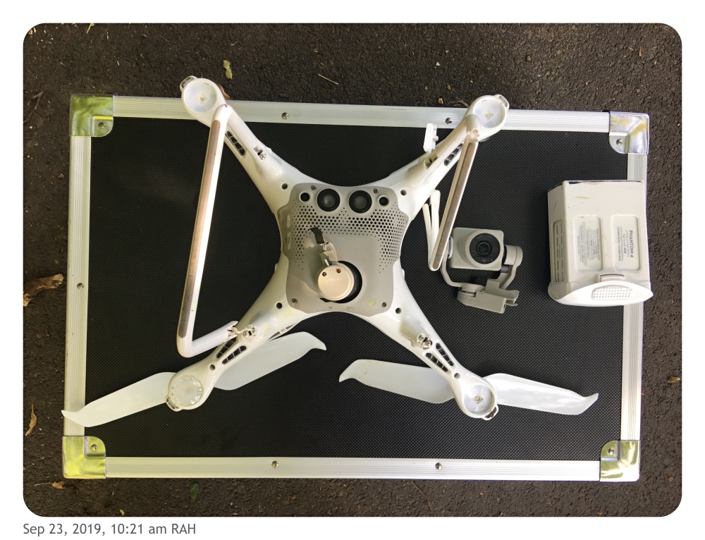

Had a similar problem last September.
