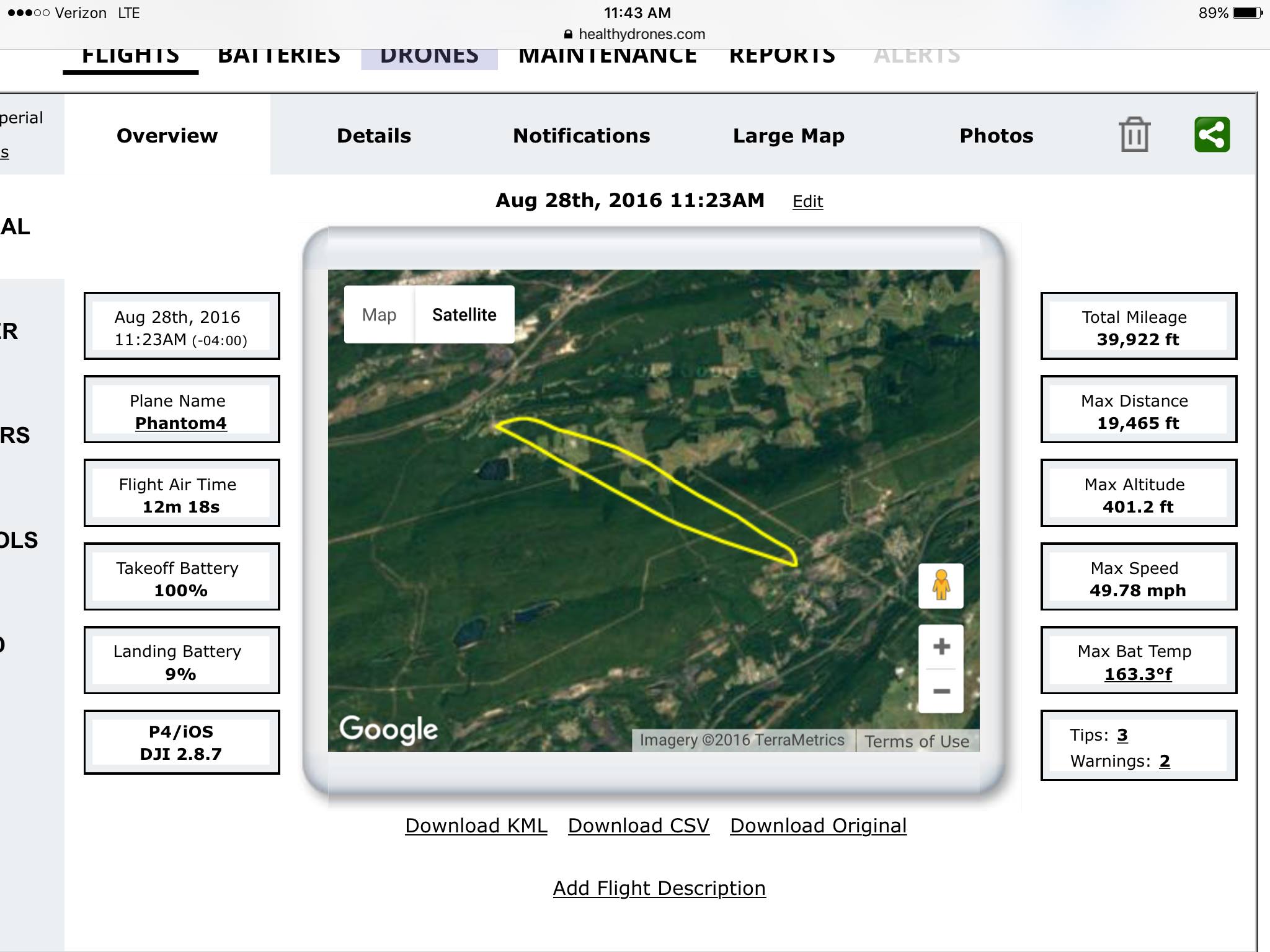

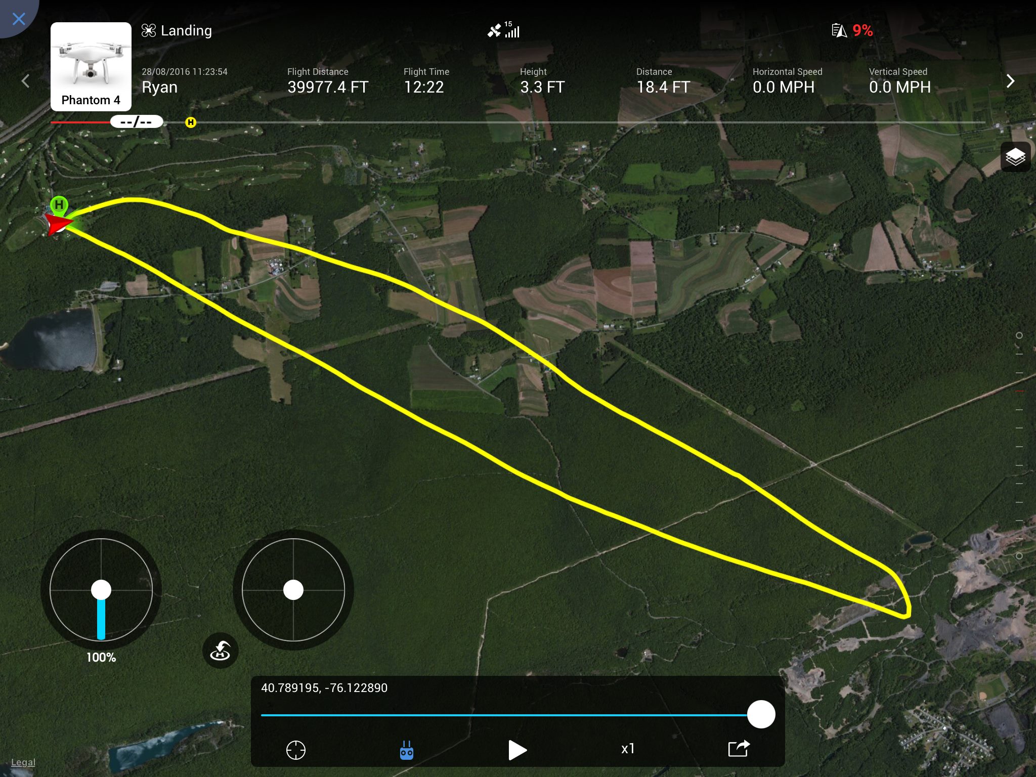

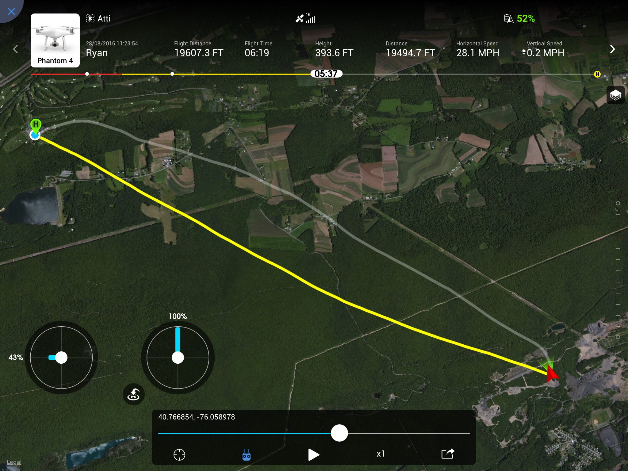

Testing distance after antenna mod to my controller. I am using omni directional wifi antenna.
Distance from takeoff: 19,494ft (3.69 miles)
Total flight distance: 39,997 (7.58 miles)
Landed with 9% battery

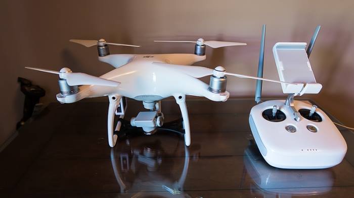

I don't know about you guys, but there's something comforting to me with the omnidirectional aspect of this setup. I have hesitated in doing a mod mostly because the unidirectional nature of all the other mods scared the bejesus out of me. This one I'll do.
...Wilson, and any1 else considering this mod, the 7dBi 'Grey' antenna is NOT APPLICABLE for this setup (see image below), will it work, yes, but not well,
I will post details and data including (Long & Short) Field Tests using this antenna and using another much better choice on my web-site, this just FYI...
