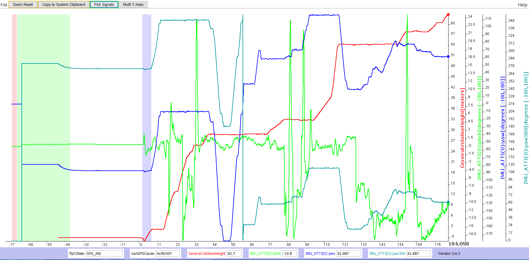

Ok, I was finally able to pull the .dat files off the internal SD card of the drone. I was unable to connect the drone back to the RC so I just took apart the drone and removed the internal SD card and it mount fine in my Mac that way. There were a total of 9 .DAT files with the same timestamp but varying sizes. I think this is likely due to the fact that the drone continued to run even after the crash and it started creating new files after about 300MB. I zipped them all up to make sure all data is available. I'm going to try to look at the logs later today myself but would be interested in your guy's inputs and assessment.

It appears that only 1 of the 9 files is an actual flight. FLY 102. The data ends basically the same way the RC data did. I don't see anything that "jumps" out as a direct cause and unfortunately the P3S does not report motor data. The data stops at 62 meters in altitude.
Wow, this is still a puzzle. It is almost like it suffered a complete loss of power but then again, it was still powered on when I found it.

FLY102.DAT (the flight in question) ends abruptly at 20:23:55Z as noted above. The next log, FLY103.DAT starts with an aircraft boot sequence at 20:24:00Z, i.e. 5 seconds later, with the aircraft on the ground and tipped over on its right side. That strongly suggests the FC crashed and rebooted rather than simply suffered power loss, although a brief power interruption could, conceivably, have caused the reboot.
Was wondering about that. Looked at FLY103 as well....
Thanks for extracting and providing the details from the logs. The drone was sitting as you stated when I found it although I can't remember if it was left or right side but either way the logs are likely accurate. After looking at the data and recalling what things looked like while flying in that brief instant I saw the drone quickly dip to the left and then video frozen, I'm beginning to rule out a large bird as this log data seems to suggest something more drone related. We may never know for sure what exactly caused this incident but I appreciate everyone's time in trying to identify a root cause.
