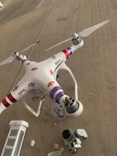

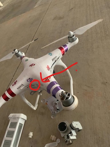

My P3S crashed yesterday. It was flying a waypoint mission through Litchi it had flown at least a dozen other times. I had recently attached a small gps tracker to it knowing i lose communication given the trees surrounding my home. This proved invaluable. It began the mission normally, flew 1400-1500 feet and lost connection. This is normal. from that point it flies the remaining mission and returns within about 7 minutes. Monday it did not. I was able to recover it. It was within a grassy area several feet from the closed road. Front left arm is severely buckled, front left propeller was not recovered, camera arm broken and wires severed. all other props were present with minor dings. case is separated in several areas. Notable: red clay was found in the top side of the front left motor, including on the threads. I don't see how that could happen if it hit the ground with a propellor attached. Leads me to speculate a propellor was lost in flight. I want to confirm.
I have viewed the txt and csv flight logs. those do not help as they stop when the craft lost signal. I really need the .DAT file. I have been unsuccessful retrieving. I have searched the posts here and have not found troubleshooting for the data download. My pc "acknowledges" when i plug it in after setting flight data mode in DJIGO by making a windows sound. However the drive does not mount anywhere i can see. I have looked in device manager at the USB ports and none reflect they are connected.
Any thoughts on establishing a connections would be helpful. To cover bases I have done the following:
Fresh battery used, craft will turn on and motors will spin. Lights on the arms change color when put in flight data mode, so I know there is communication. When i plug into computer through USB and micro USB the lights extinguish. Craft still seems to be on, battery is definitely on.DJI app definitely in flight data mode.

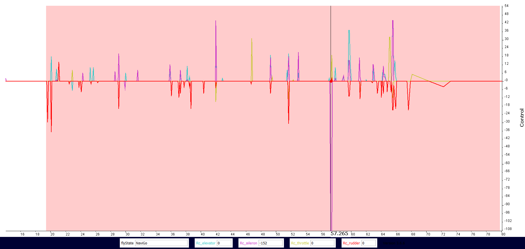

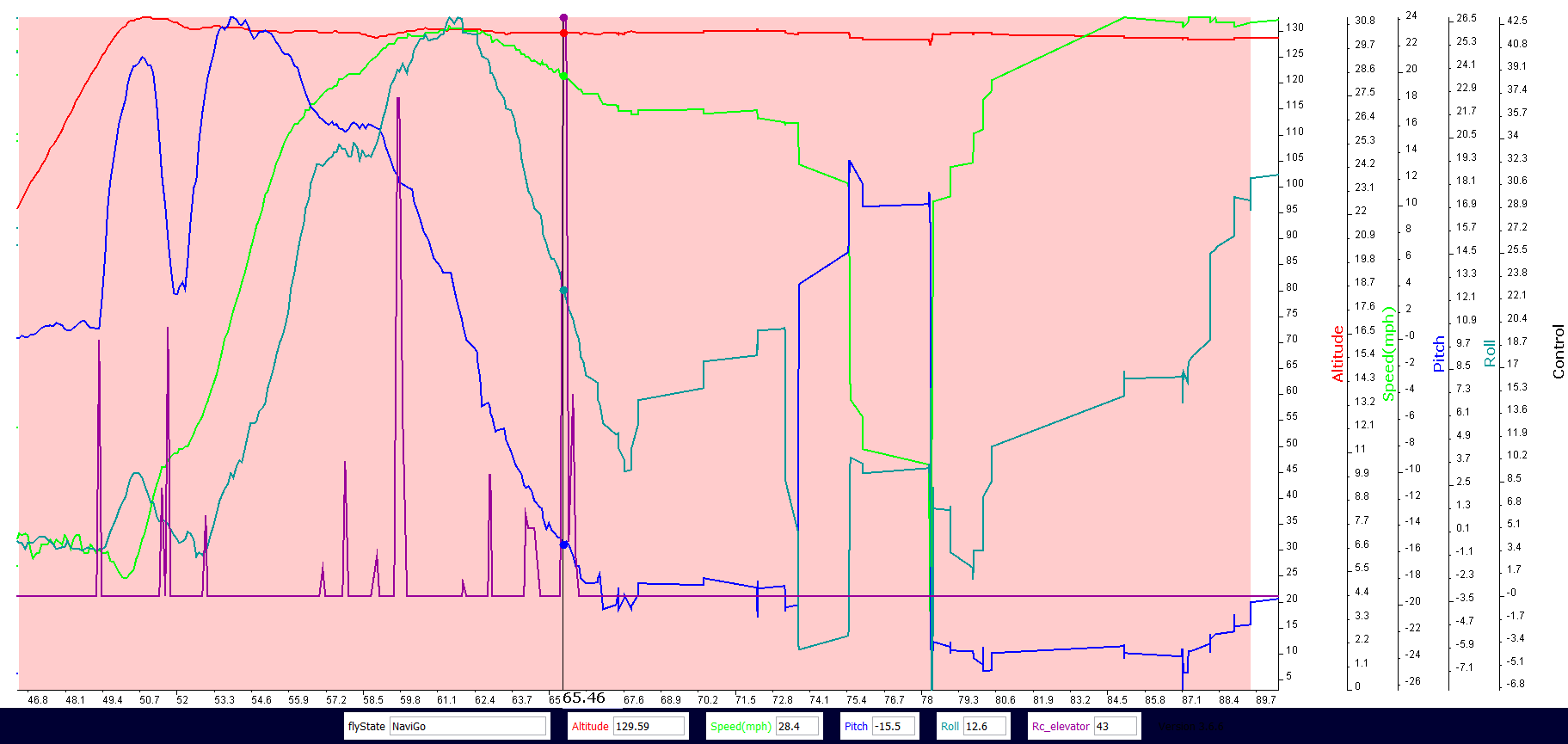

Yes, I think you do as well, but I do have a question. Although these inputs are minimal, is there some reason you were issuing elevator commands during a mission? Also, are you following the instructions as shown in the link below to retrieve the .dat?

Below are the inputs I am referring to:
Your are not stating where you are hooking up the USB cable on the Phantom. Its on the front, not on the gimbal.
This my not be the cause, but it is important. You may have needed to do a compass calibration after you added your tracker and if you remove the tracker on another flight.

Very unusual for RC commands to be issued during a mission. As I mentioned, these are minimal I grant you, but odd none the less. With the only exception being very slight altitude adjustments, which were basically irrelevant here. Unfortunately the P3S does not record motor speed data, so the .dat may not help in that regard, but it will be much more information than the Litchi log provides.

And no, once i engage the mission i only watch the video until it goes away and it flies back in range.

Definitely on the nose of the craft. The gimbal and camera are damaged and separated from the aircraft

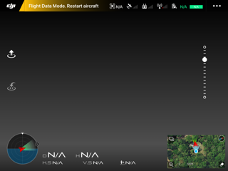

@gmonatl,
"DJI app definitely in flight data mode."
"The gimbal and camera are damaged and separated from the aircraft "
I really stumped on these two statements.
The DJI app needs to have a two way communication to let you know it you can connect to it.
With out a gimbal, the communication would not be confirmed, basically it say Cannot enter flight data mode.
Your Thoughts?

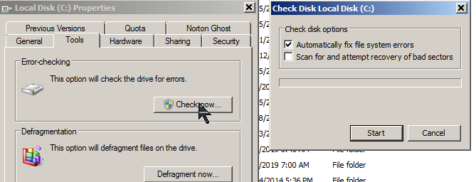

You can open the case and manually remove the SD card. There is a chance that the SD file system is corrupted and the FLYnnn.DAT you want doesn't appear. To fix that you can use something like the Windows disk repair utility.
@gmonatl,
Rod-
I attached a screenshot showing the flight data mode in the upper title bar. It's definitely entering FDM but it's definitely not mounting its internal HD on my pc in windows explorer

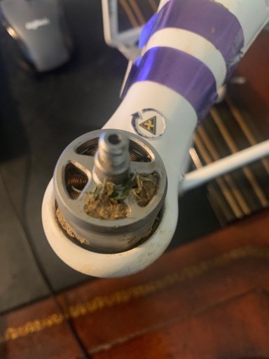

While watching a video of the exact same mission flown a few days before I noticed something i wouldn't normally notice. The AC did this weird hitch. The coincidence is it happened exactly where the ac likely lost its blade and arced down to the crash site. I don't know if they are related. Still trying to get DAT file. Video link attached

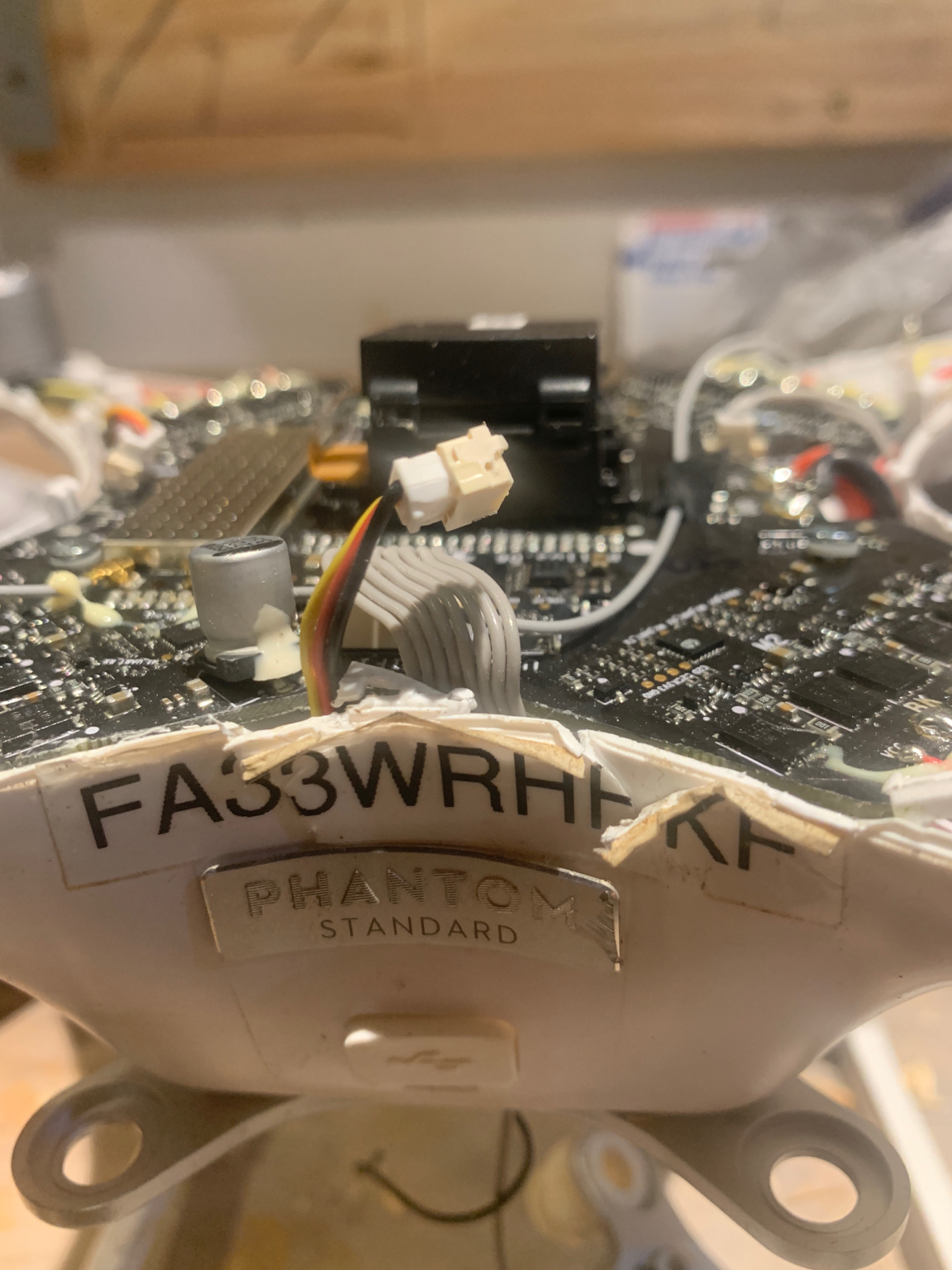

Also found why the data download would not work....see pic. Several components are knocked loose from circuit board. Bummer

There are but I’m well above. If you watch the video clip I attached a link for above, you’ll see the crash area. I have decent obstacle clearance. I’m almost certain the propeller on the front left departed the aircraft for some reason. I have accessed my DAT files by taking the SD card out of the aircraft and I’m afraid that will provide no answers. I guess I tried to download too many times and created a bunch of new DAT files that must have crowded out the accident dat file. That is disappointing as I’ll never know for sure why it crashed.

Have you tried the Windows Disk Repair tool? When my flying buddy crashed his P3 we removed the SD card and the .DAT didn't appear. Normally, the FC will close a .DAT as the AC powers down but was unable to do so because of the abrupt power loss. After the SD card is mounted right mouse click the SD disk, select Tools then Error Checking, then Check Now and, finally, select the Automatically fix file system errors.
Have you tried the Windows Disk Repair tool? When my flying buddy crashed his P3 we removed the SD card and the .DAT didn't appear. Normally, the FC will close a .DAT as the AC powers down but was unable to do so because of the abrupt power loss. After the SD card is mounted right mouse click the SD disk, select Tools then Error Checking, then Check Now and, finally, select the Automatically fix file system errors.View attachment 113527
Bud thank you. Will try that. I only have about 8 .dat files on the SD card. The oldest started the day after the crash and the rest very obviously are reflecting each time I powered on trying to download through the disconnected micro USB port.
In retrospect I should have opened the shell and retrieved the SD the first time the download failed. But, I figured I was doing something wrong being new to the analysis side of the ac.
