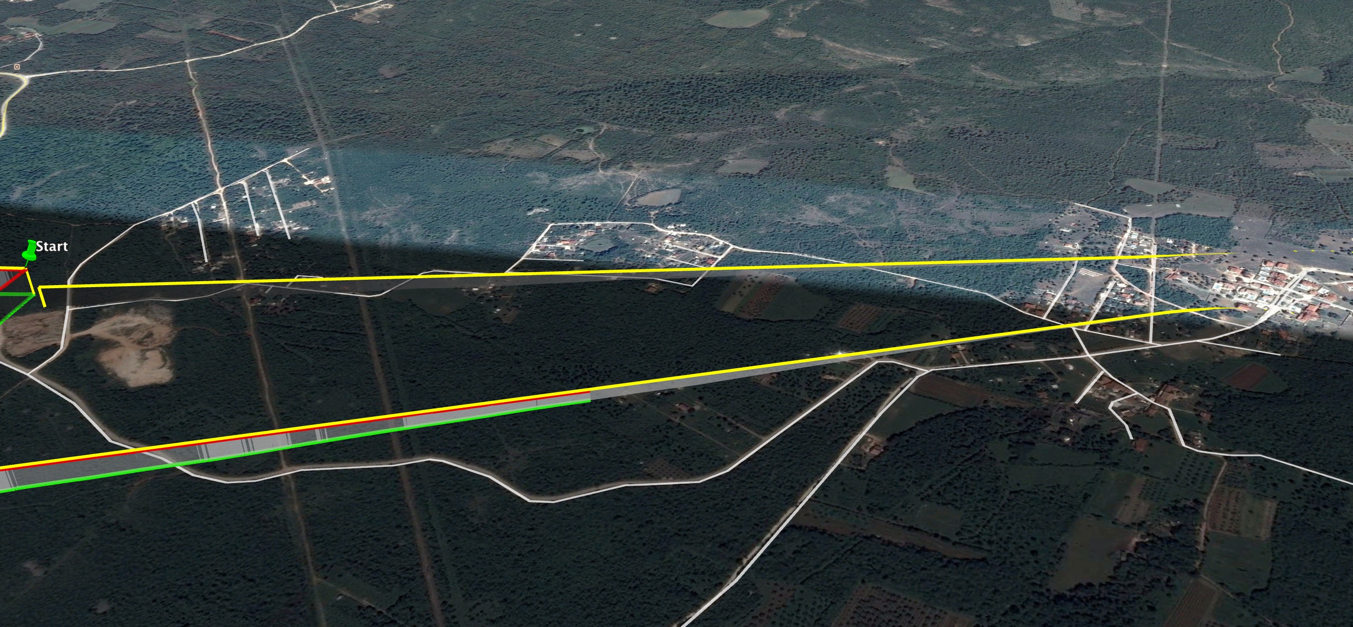

That mission profile was flawed - take another look at the waypoint elevations. If you plot the 3-D profile on GE, you will find that you flew it into the ground not long after it lost downlink. Yellow is the profile, red is the recorded flight track, and green is the recorded ground track.

Litchi exports a 3-D mission KML file that you can open in Google Earth. As for why the altitude profile was wrong - I have no idea. A common problem seen in other cases like this, however, is that the operator forgets that the waypoint altitudes are relative to the takeoff point (unless the above ground option is chosen) and fails to take into account the change in ground elevation.
@dblagic Your question to Sar104 answered above. His 3D .kml was taken from your mission plan. The one's I posted were taken from your actual flight, though I did not go in great detail the elevation profile as that was prior to you providing the mission link.
