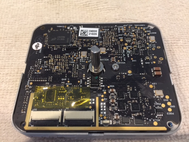

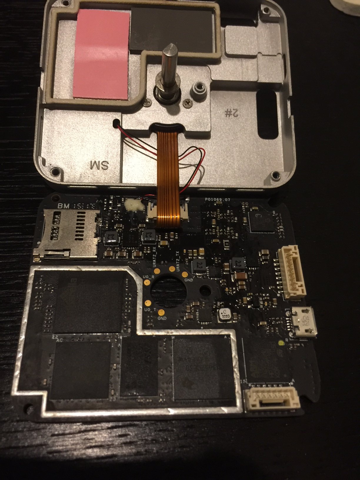

Hi All,
I need to purchase the circuit board for the gimbal on my phantom 3 professional. I prefer to buy a new circuit board but secondhand is okay too providing it has no issues or problems. My phantom constantly gives me a "No image transmission signal" and I have no video feed to my ipad/iphone. The P3P flies and takes videos and photos, I just do not see anything.
The reason I do not want to buy an entire camera/gimbal set-up is because my P3P is old stock but less than 1hr flight time and that is all flying within line of site. The error I have had since its purchase as a secondhand buy, so no comback on the previous owner.
Any help or advise will be appreciated.
thanks Rob

I do appreciate your help, this forum and other members input. I am open to anybodies valued advice but days and many many hours of reading all sources of info on my issue all relate to the circuit board. A few threads did discuss the ribbon cable but I replaced that first with no change. I am almost ready to give up on this thing because Hani emailed me direct and informed me I should replace the entire gimbal. Well I am going to hold off doing that until I exhaust all other options sourcing just the part I need. My obsession with flying has fast deminished to now being happy just looking at the expensive waterproof drone case sitting on the floor. At least when I sell this thing, it will be in pristine condition with still less than 1hr use.

Crashed cameras are often seen on ebay. It is kind of lottery to buy such gimbal, but often only mechanic part is damaged. But they are usually not as cheap as you would expect.
Also, these boards can be repaired by a skilled electronic technician. Unfortunately there is no full schematic, so it's time consuming to repair it. But many info is available on the wiki made by Github guys, and simplified conceptual schematic is there:
WM320 Gimbal top board · mefistotelis/phantom-firmware-tools Wiki · GitHub
