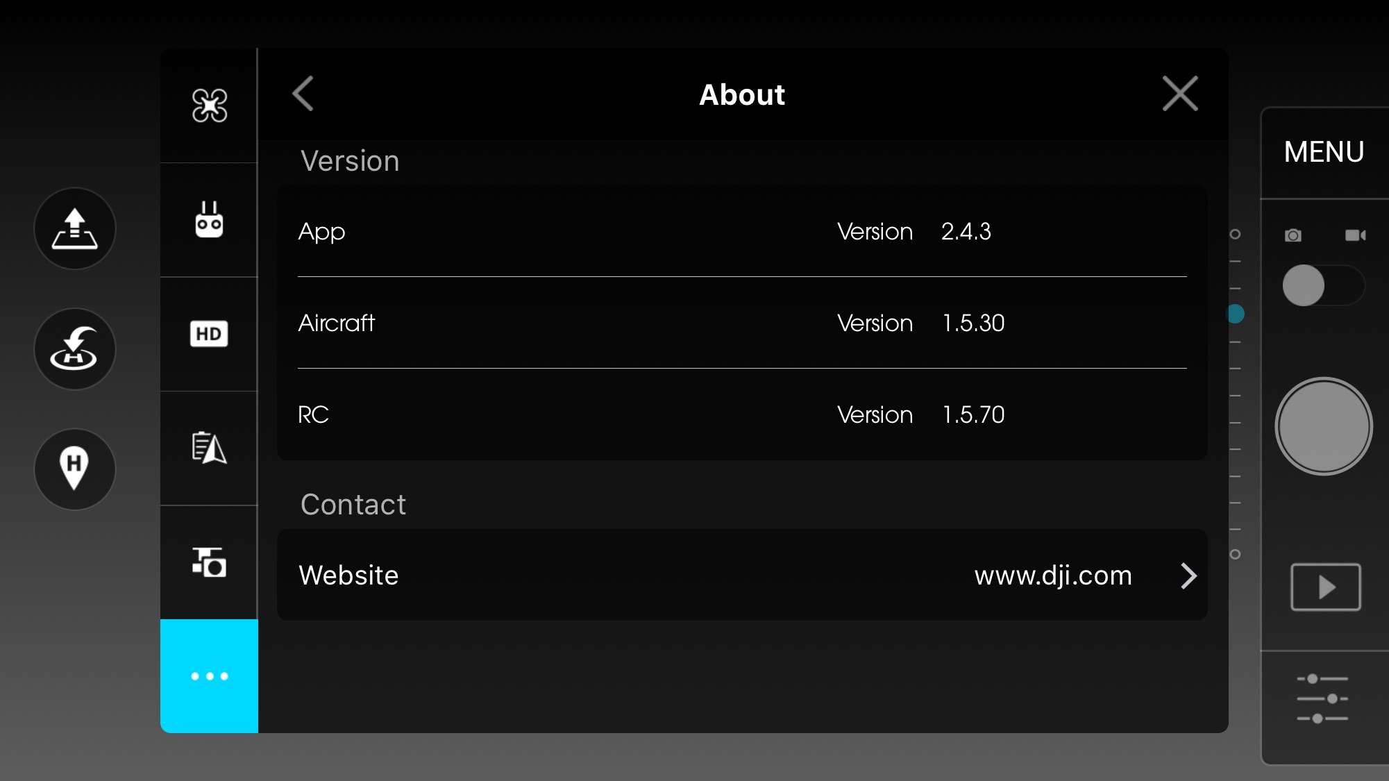

I have a month old P3P and trying to update the firmware from my current 1.5.30 to the 1.6. I have three SD cards a 64gb SandDisk micro xc1, SanDisk Extreme Pro micro xc1, and the manu Panasonic 16gb. I have formatted all three cards via the aircraft module. I have uploaded the latest 1.6 bin file from the DJI website and placed it in its own root file.
I stick the card into the aircraft and turn it on. I do not get any beeps and the gimbal platform light is a solid green. I have left the card in the aircraft for 30 minutes for each SD card, trying all three SD cards with the same results. I do not get any TXT files either or a failure/success message. I am at a loss....
My versions are:
App 2.4.3
Aircraft 1.5.30
RC 1.5.70
Any suggestions are welcome...

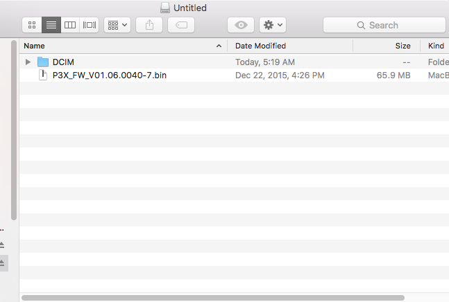

Here is what I have on all of my SD cards as well as my P3P versions. Thanks for your help!!
Is the .bin file in a folder? It should just be on the SD card without anything else.
Holt, here is the .bin file in its own directory. When I formatted each SD card, the DCIM folder is placed in its own directory. Thanks for your help!!!

Your file name is wrong, P3X_FW_V01.06.0040-7.bin should just be P3X_FW_V01.06.0040.bin
Thanks Stujol!! I have no clue how the 7 got in there as it was downloaded directly from DJI's website. I will get rid of it when I get home tonight and try again. Thanks a bunch!!
Im new to all this ... how to I check the current version of what is installed ... i have new phantom just out of the box and have update required warnings for everything
in the dji go app click on general settings (top right) and scroll on the way to the bottom and click on about.
Update....Its UPDATED:-) Thanks for your help...something so simple I overlooked. Apparently each time I deleted and downloaded the bin file, the MAC created a version number so to speak at the end of the file. Lesson learned...now for this snow to go away!!
