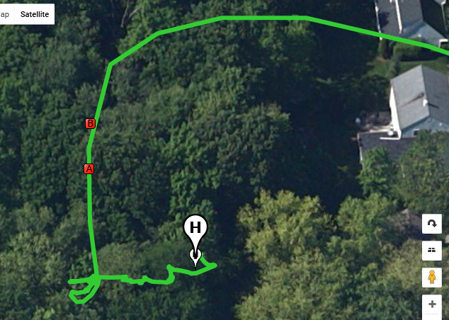

Here's a screen shot of the final few seconds.

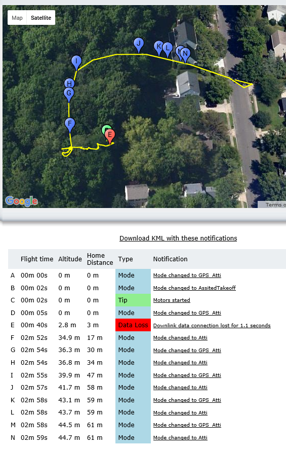

I uploaded your log to healthydrones and see the compass showing a high turn rate at two points:
I noticed you already got the first Atti error a bit before this:
If you play back in your app, at what point did it really start to get out of control? With the first Atti error, or after the compass errors?
I actually lost control BEFORE the first atti error. I saw the aircraft bank hard right, uncommanded by me, and then a second or so later I heard my app say "atti mode". I knew something had gone terribly wrong at that point and I was in trouble. I lost sight of it quickly, my bad for flying in such a tight spot, and all I could think of to do was to try to gain altitude, but obviously to no avail.
I'm thinking maybe at those points of compass error, the aircraft first struck to top of the trees, spinning it around rapidly. Thinking this has nothing to do with compass error or atti error, and that the wild out of control attitudes put the aircraft into atti mode and back several times. I guess there's really no way of knowing. But my theory is I threw a propeller blade. I know for sure that it wasn't wind drift in atti mode - I saw the thing bank hard right uncommanded. It didn't just drift right.

>>I was upload dataflight record to HealthyDrones.com - Innovative flight data analysis that matters. Your speed DOWN to ground are "normal". Witch not are normal are you compass calibration. Several times in flight, you cominication view toggle between SAFE P-GPS and Atti-mode. Report:
A 00m 00s 0.0 ft 0 ft Mode Mode changed to GPS_Atti
B 00m 02s 0.0 ft 1 ft Mode Mode changed to AssitedTakeoff
C 00m 02s 0.0 ft 1 ft Tip Motors started
D 00m 05s 0.0 ft 2 ft Mode Mode changed to GPS_Atti
E 00m 40s 9.2 ft 9 ft Data Loss Downlink data connection lost for 1.1 seconds
F 02m 52s 114.5 ft 57 ft Mode Mode changed to Atti
G 02m 54s 119.1 ft 97 ft Mode Mode changed to GPS_Atti
H 02m 54s 120.7 ft 113 ft Mode Mode changed to Atti
I 02m 55s 130.9 ft 153 ft Mode Mode changed to GPS_Atti
J 02m 57s 136.8 ft 189 ft Mode Mode changed to Atti
K 02m 58s 141.4 ft 192 ft Mode Mode changed to GPS_Atti
L 02m 58s 143.4 ft 195 ft Mode Mode changed to Atti
M 02m 58s 146.0 ft 199 ft Mode Mode changed to GPS_Atti
N 02m 59s 146.7 ft 199 ft Mode Mode changed to Atti

Compass note from flight data: "
Found rate of change in the compass of 25 degrees or more per 0.1 seconds.
That's about a 90 degree turn in a third of a second, which is not normal.
This can be a result of extremly strong winds, a crash into an object or a bad compass".
Your trip have compass changes (it's your bird moving/make fast changes) are above 30.2 to 56.5 degree. The maximum "normal" are 25 degree change within 0.1 sec.
This data ended at BAD COMPASS/NOT CALIBRATED.
