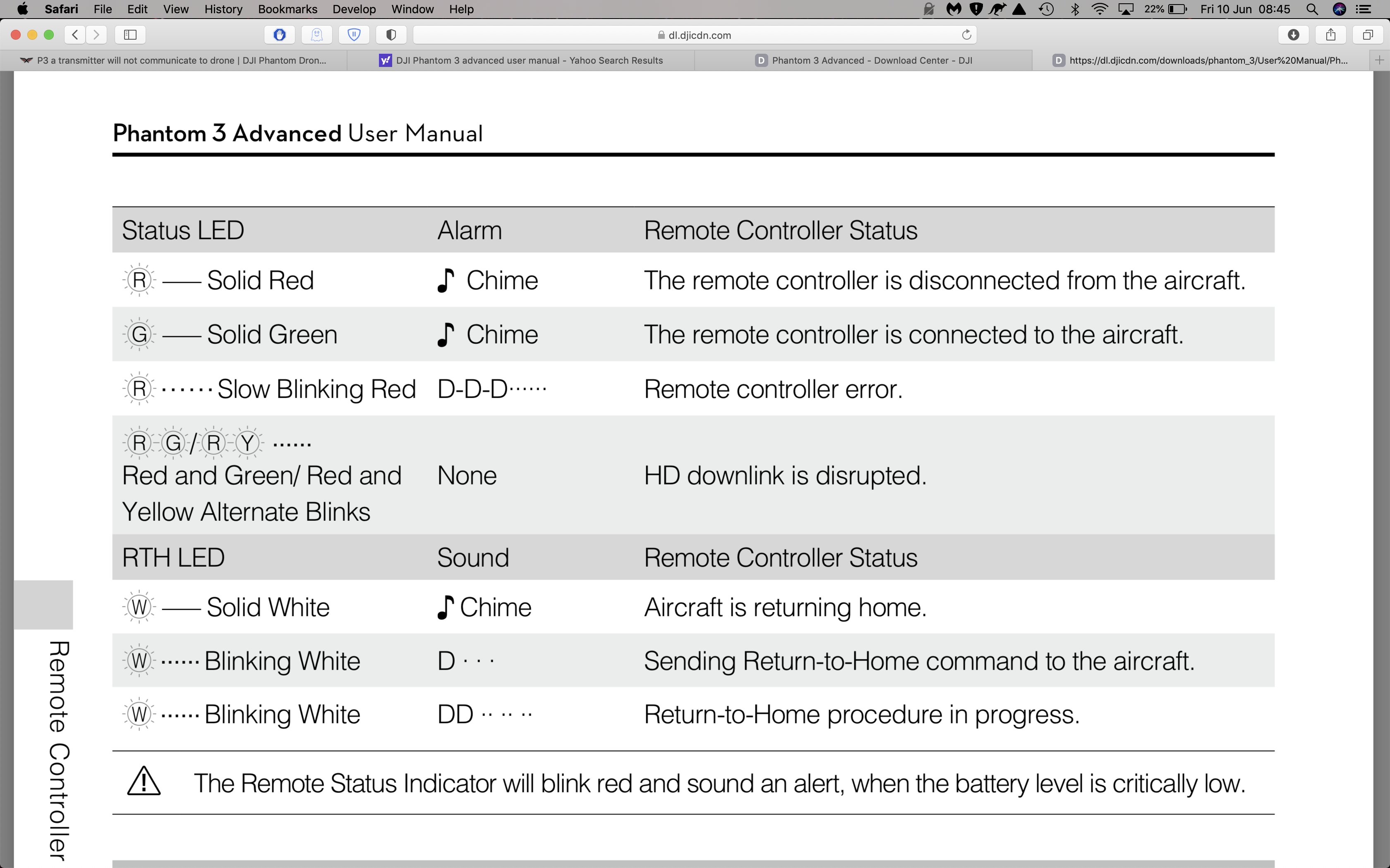

I presume these flashing lights are on the RC? Look at the manual, page 27/28 where it explains all the LED's.

Never mind the drone lights, what are the lights on the RC doing, especially the L/H one.
