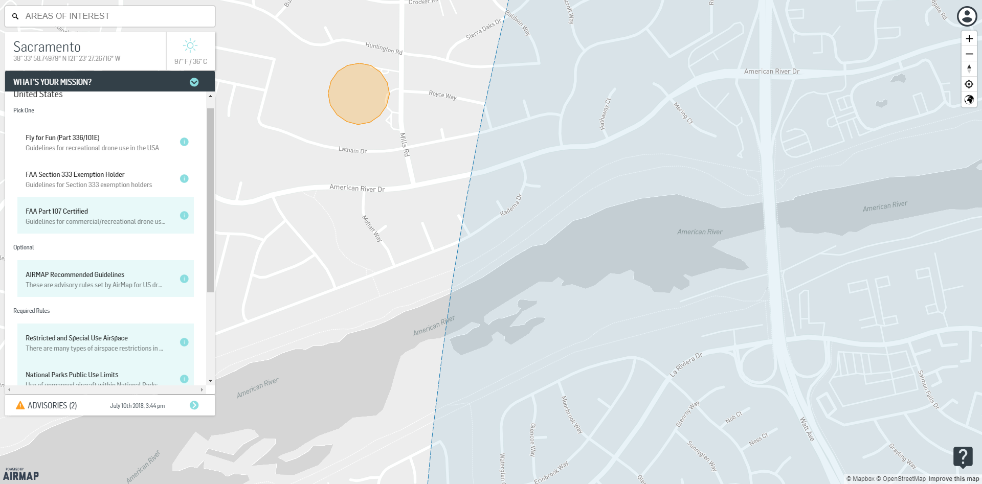

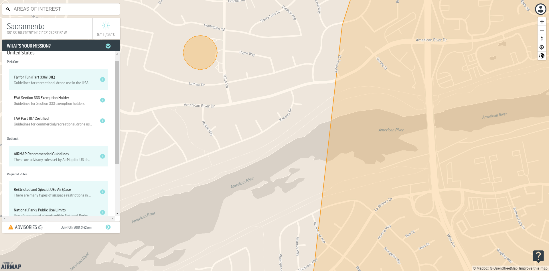

Yeah, I'm really suffering from a sort of "estimated information" overload with this one. For example, on AirMap if I put in "Fly for Fun" the circle restricts leaving the property available for drone work without any authorization. When I select FAA Part 107 the airspace expands slightly to include the property in question. I'm a bit of a rule follower, so the ambiguity is a little nerve-racking.
Awesome information and advice!

You clear this up by reading the sectional. At the end of the day it's the only thing you can really trust.
Also remember "fly for fun" (aka 336/hobby) does not have an Authorization process. The rules are you call and notify for each flying session if within 5M of the airport.
The reason why Part 107 and Hobby don't align in the apps is because hobby/336 is about distance from the airport and Part 107 is about the actual Airspace which is irrelevant to distance from the airport. Clear as mud at first but it eventually starts to sort of make sense LOL.
The local Sectional for your area is now your "sUAS Bible" for flying locations. It's right all the time if you read it right :)

There's no real ambiguity. "Fly For Fun" has a different set of rules than Part 107. So if you are flying a Part 107 job, then authorization is needed within the controlled airspace.
