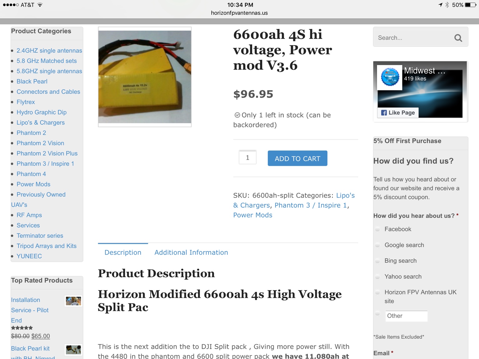

Hey db, was looking on horizon web site and saw this 6.6 battery, the site says it only weighs half a pound which is half the weight of the multi star 5.2. What do you think? Have you had any experience with this one?

I'm not so sure that battery is only half a pound, or 8oz (226g). The multi star 4s 6600 is about 530g, which is probably closer to the real weight.

Anytime they split a battery they're adding a little more weight, which shrinkwrap an extra wires. So while the 6.6 split I will handle fine, I found the single 6.6 to be too heavy because of it's awkward size and location. I sent my 6.6 that I was getting 39 minutes out of to be split, when I got it back because of the extra wires and resistance that comes with splitting a battery, I couldn't get more than 30 minutes out of it.
That being said, I'd be willing to try a 6.6 split again. But I don't have a lot of faith in split batteries versus single batteries

Got a reply back from horizon, the battery weighs 580g, the weight on web site is an estimate for shipping purposes

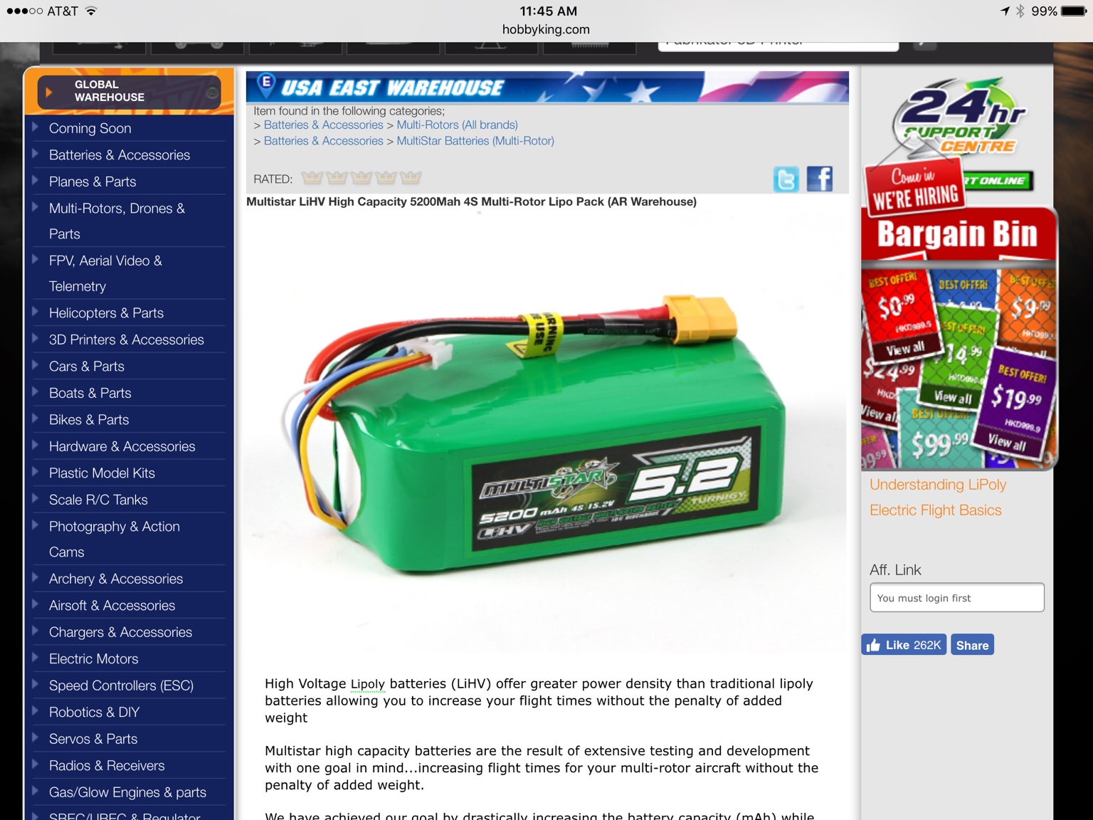

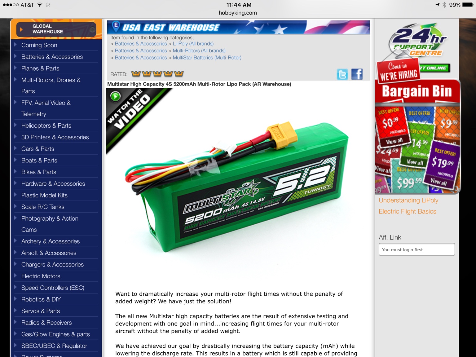

Lihv would be best(15.2) I believe Ed209 accidentally bought the 14.8 5.2 and before He sent it back concluded that they don't give as much flight time
