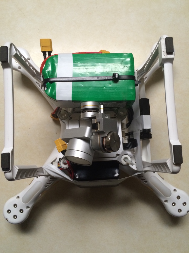

I taped the small battery to the front so the balance is better, makes for a more stable flightView attachment 56497
hey dirty bum can you post a pic from the back side so i can get a better idea on how u strapped in the battery.the battery on front is that hooked up as well.if your going to carry that battery might as well hook it up!!! Thax
hey dirty bum can you post a pic from the back side so i can get a better idea on how u strapped in the battery.the battery on front is that hooked up as well.thax

Thax dirtybum that's awesome that you have great details of your mod..do you also hook up the battery on the front this is what I am going todo going to use the venom fly 2300 or nanotech 1600.thoughts on this plez

Yes the bolts are Heavy the venom 2300 are 207gr...to bad they didn't make a 5200/6200 mah!!Unknowen caller first tried these that why I gave them a try!! Now I too have ordered the multistar 5200x2 + going to hook up the venom batt as well 7500mah external.
like this but with multistar 5200 but this set up is good 6900//3x2300 venoms 3x207gr 621 may try it soon!!! I do no a lot of weight here!!well this set up is busted 30 mins of fly time crap.I got 30 mins with nanotech 1600x2///33 mins with 2300x2 venoms landed with 7% still 5% in tank?this set up is to much weight.
Yes the bolts are Heavy the venom 2300 are 207gr...to bad they didn't make a 5200/6200 mah!!Unknowen caller first tried these that why I gave them a try!! Now I too have ordered the multistar 5200x2 + going to hook up the venom batt as well 7500mah externals yeeeeeeehaaaaaa ha www!!!

No just one!! 5200&one in front of quad maybe 1600or 2300 but the grams are getting up there!!

418 grams 5200 but I will cut the wire make it shorter and it might be 415gr...that will be same weight as my venomfly HV but 600 more mah.i flew 25,400 meters 27 mins landed 2% so this extra 600 mah well I guess I will find out!!

I'm trying to find the lightest weight 5200 + Lipo out there. But so far they are all around a pound in weight!!!
Do you think best place under the vps or high up the back part of the landing gear

Dirtybum has tried this he really knows more about it he has pics of his install great job he did!!!you will see it top of page the big green lipo!!

I don't think I've flown in a week, this is my busiest time of year for work and when I have time it's been windy, if it's over 4 mph I usually don't bother. So here's the story with strapping one on front, you either have to mod your battery with a 5 inch cable that'll make it up front (or do a whole other extension cable, which adds more weight) or if your aircraft is modded you can run a cable out the front leg instead of two out the back. I've done it 2000 maxamp up there @ 190 g , two of my aircraft don't like it and one of them handled it fine! So it may or may not work on yours. If it doesn't work you'll know because you'll get "Max motor speed errors" or it will yaw out of control and out of nowhere as you're flying forward which is scary[emoji41]
Adding an extra 700 g on to the aircraft is extreme, but you can try it
