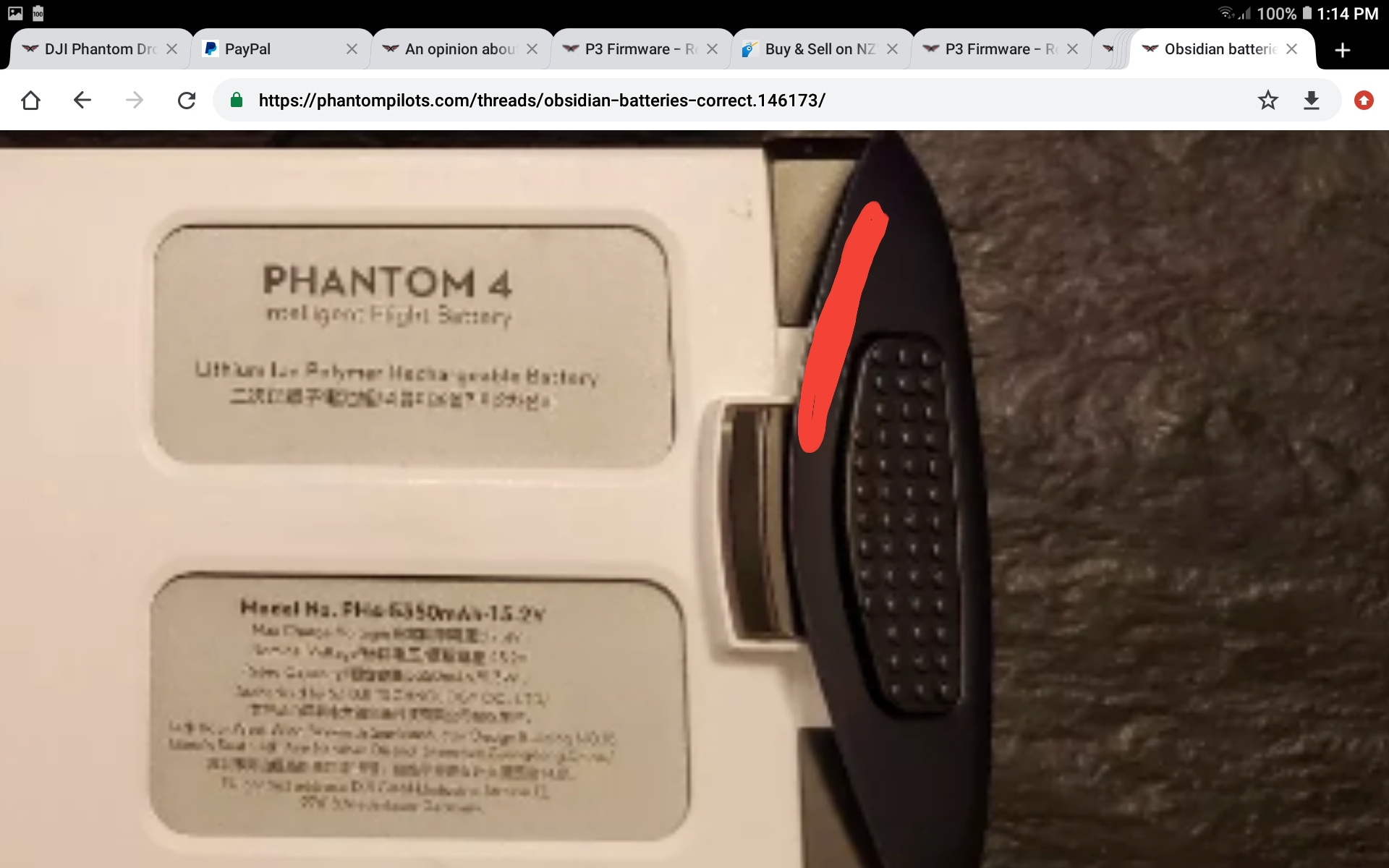

I just purchased an obsidian from eBay but I just noticed the batteries are white with black tops and are only 5350mha. Are these “1st edition” or something or am I being scammed?

Ok here's couple posts I find...bottom pic your batt,,I can see one side stratch back to white on the edge,,black batt should not do that,,,I can't even find a picture of a white obsidian battery,,,even in pics I look at the obsidian battery has black cover under case not a white,,,,you might have black drone but I don't think that original battery for it,,is remote black ? Any give away markings showing it been painted or does drone itself look original

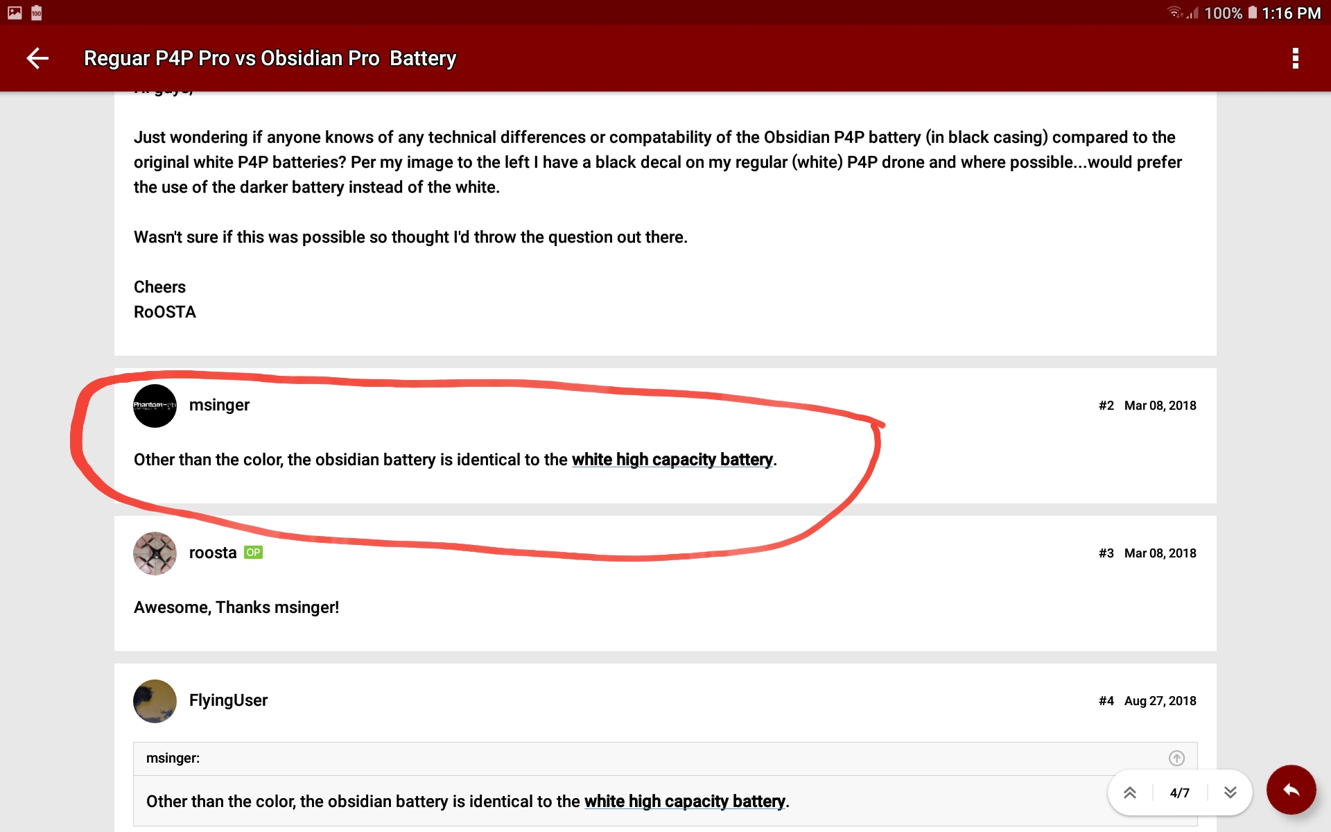

This one shows the 5350 mAh. I guess I'll know when it gets here.

Did the seller list it under the name obsidian (pro) or black, like the P4 limited? Sad, The seller or somebody painted the batteries. Ouch Could be arbitration with eBay if he listed it as an Obsidian to deceive. IMO

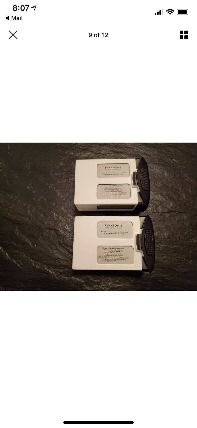

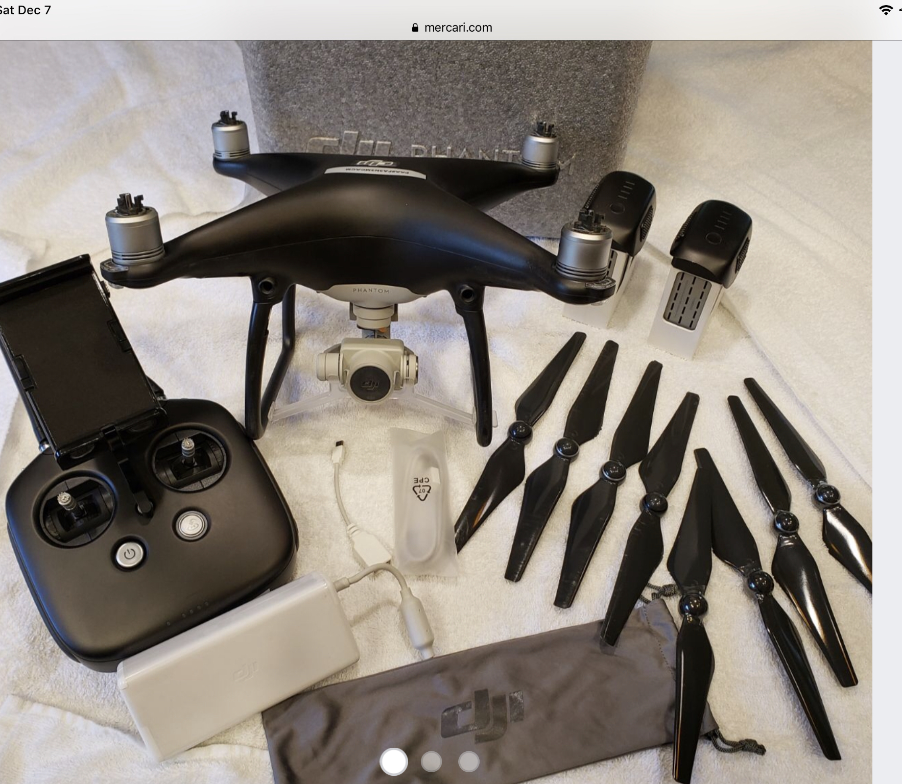

Found the listing on eBay. It does look like the Pro (sensors all sides). They are not
“authentic DJI obsidian batteries”
The batt covers are easy enough to change. Anyone’s guess on how they got that way.

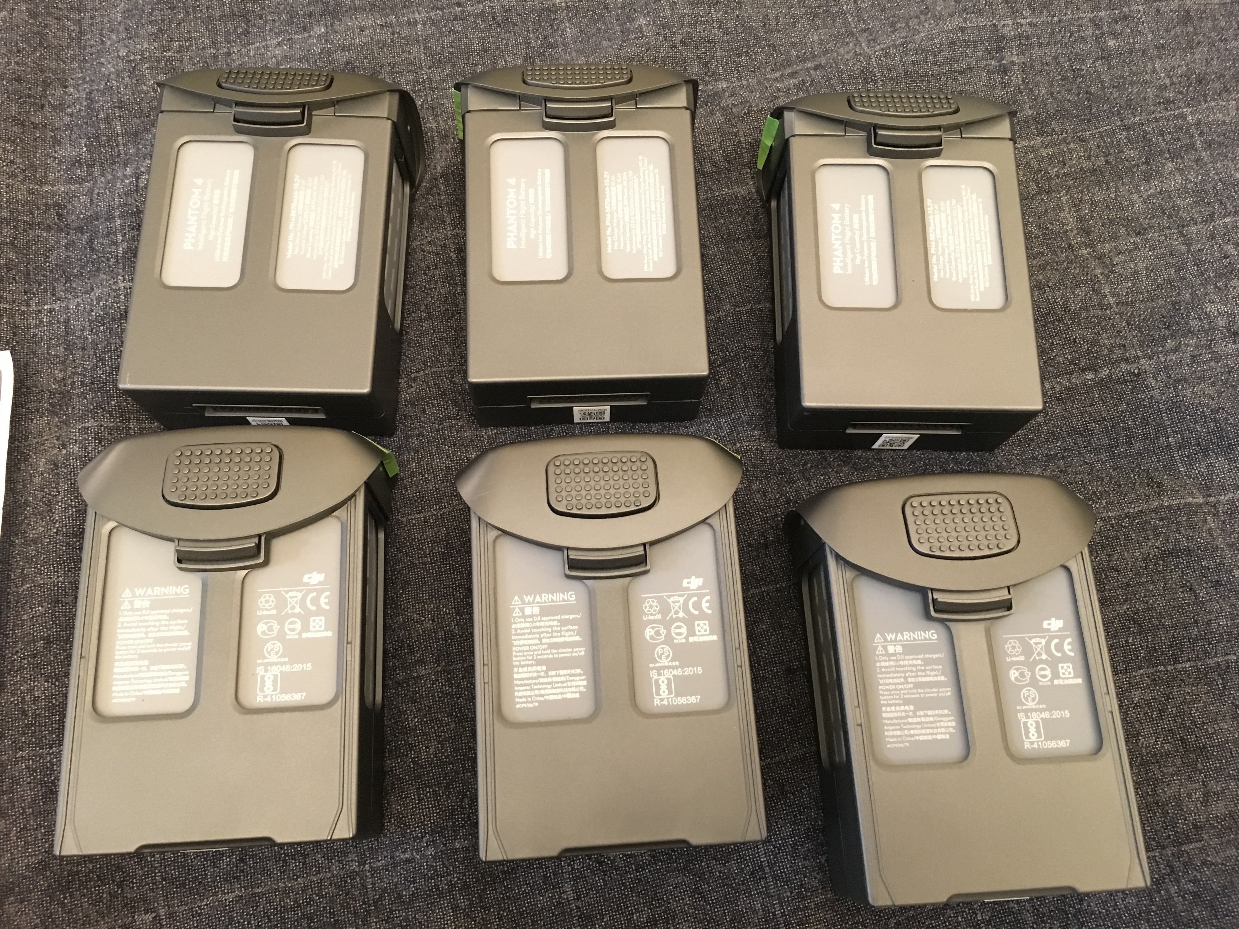

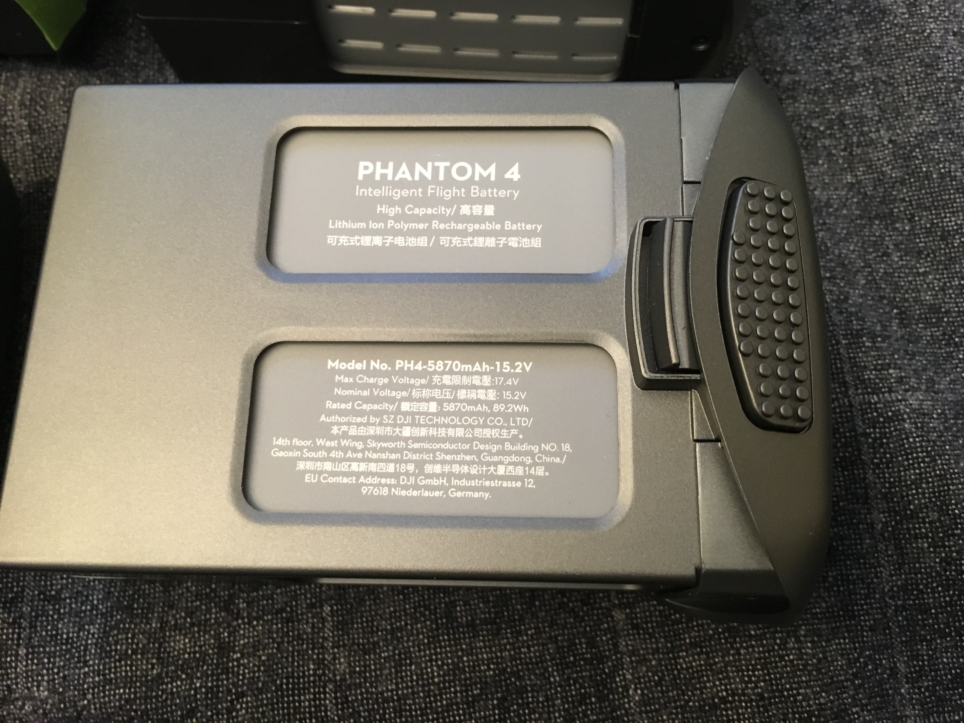

All obsidian batteries look like these...
You can see they are not black, they are Obsidian plastic thru to the center and when placed next to black obejects you can really see the difference.
Those ends seriously look black not obsidian.
