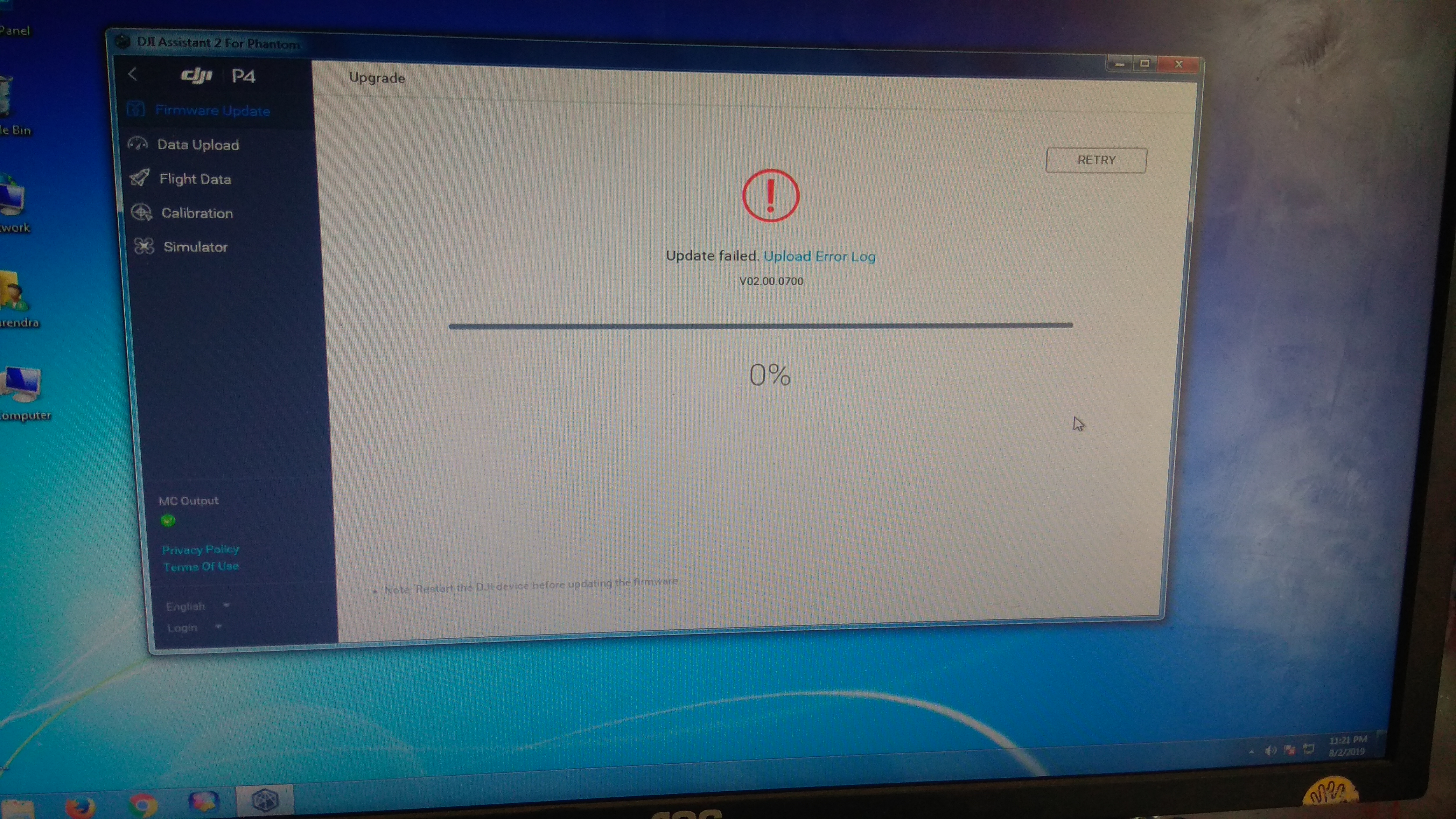

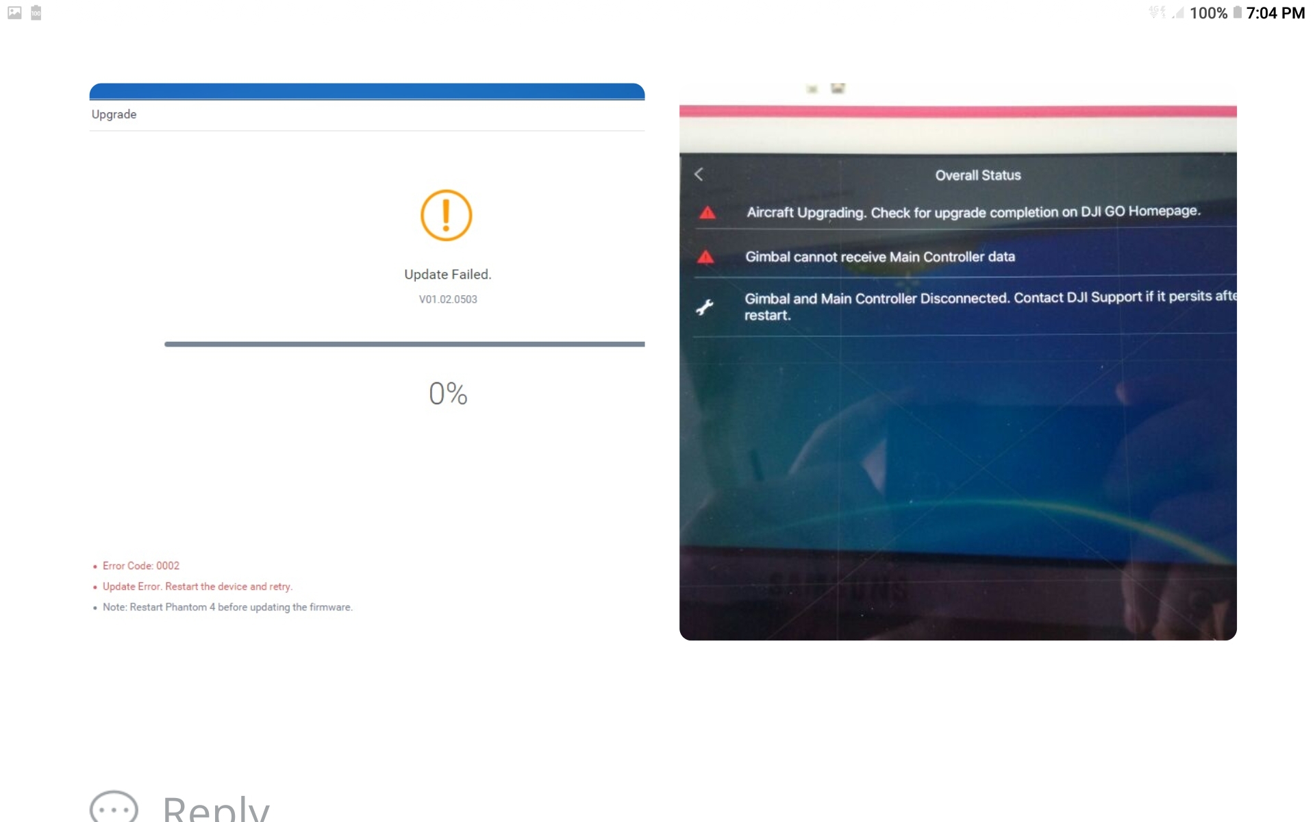

I update firmware phantom4 after updating camera view not seen my android mobile.
I try downgrade but every time update is failed. What can I do it
I try downgrade but every time update is failed. What can I do it View attachment 113943

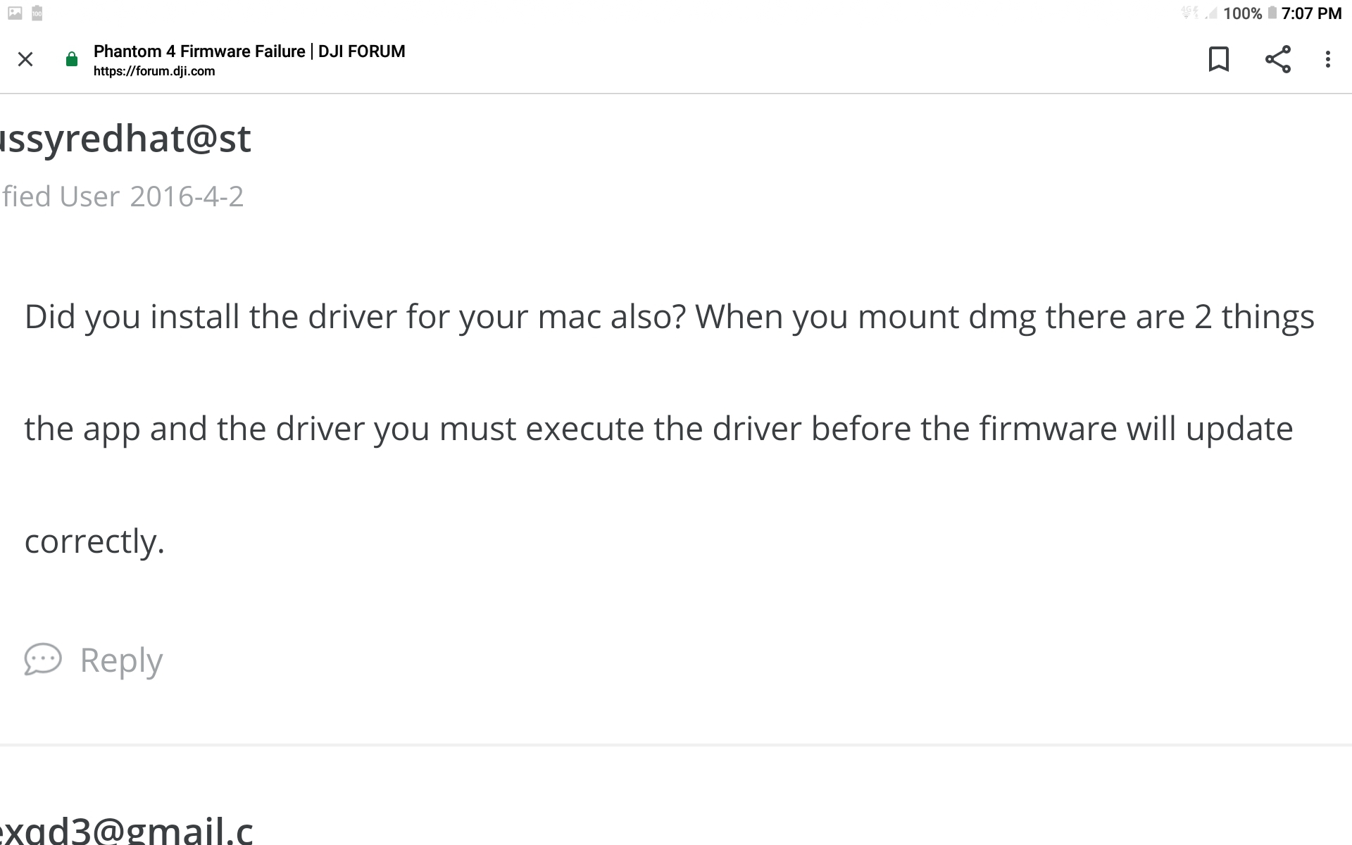

I think I try help before on this,still no cam view,,I know nothing about computers I always done mine with the app,,have you tried to delete all downloads and try load again ,,do you know what current version is that installed..sorry to reask that question ,I think I ask before

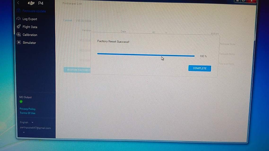

When not udate firmware I reset factory default so current version is 0.00

But update every time fail

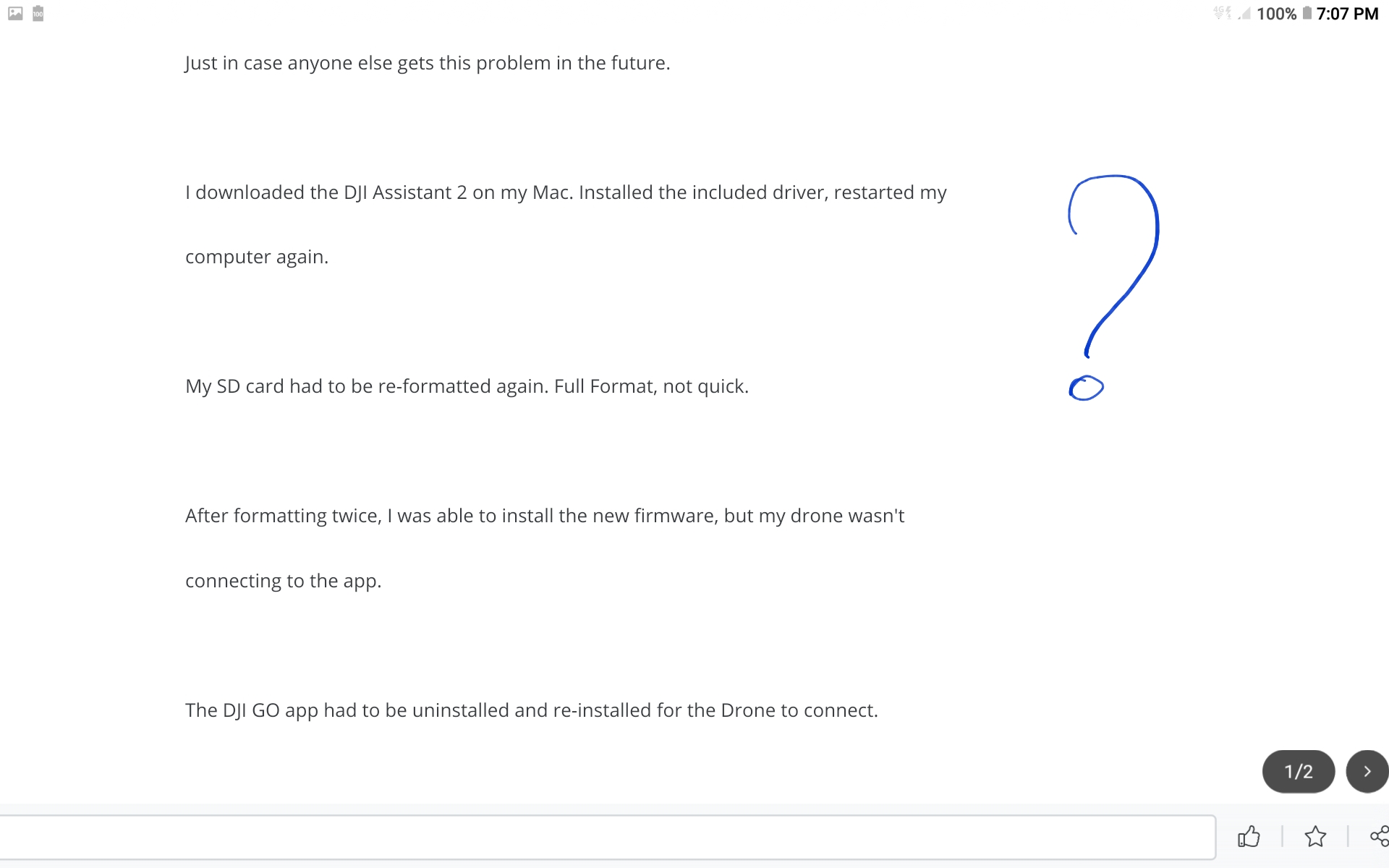

Ok me find these from other posts exactly the same,,,,,hope you have some joy here

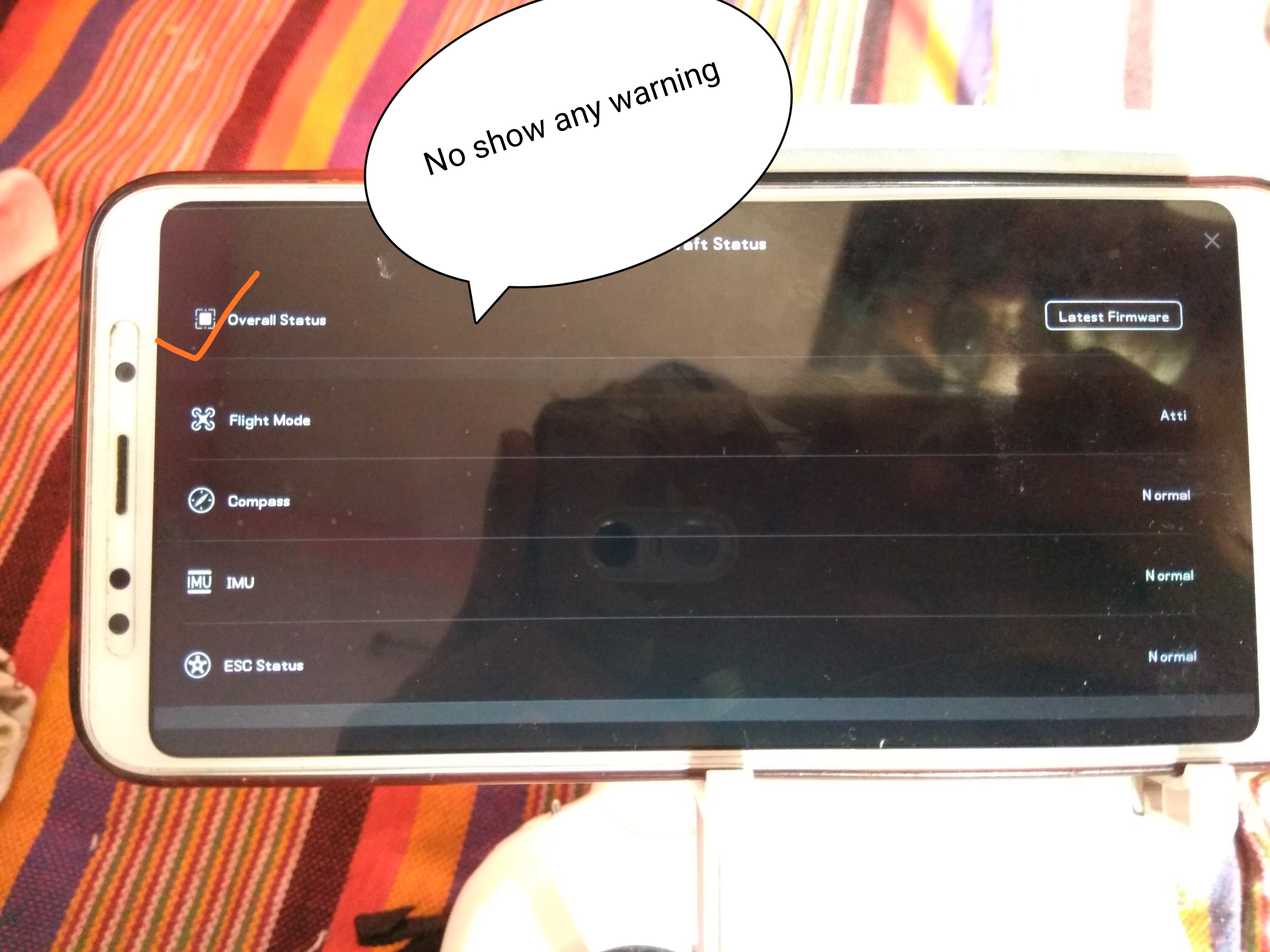

My Dji assistant 2 operating system is windows 7 and no show any warning in aircraft.
My problem is that no show camera view. Other functions is work properly.

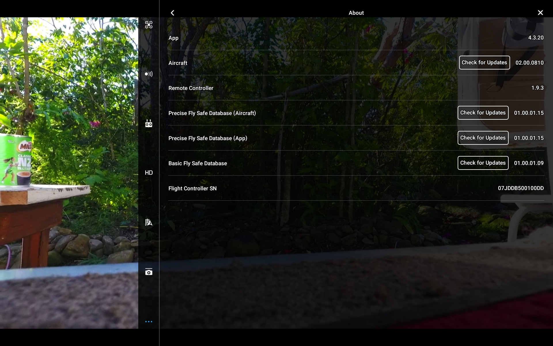

In settings aswell at bottom it says ABOUT..click on and it bring up versions like mine show,,,if your update worked should show like this,not 100% sure if p4p uses same firmware as p4s but gives the idea..if you have new firmware shown here it could be something else wrong,,could be bad ribbon cable or gimble board or video board,,again this hard to eliminate without parts to try and don't want to advise buying something you might not need,,,was this cam working before update ok ?you might need to look at assistant 2 again and search for previous version again,,
