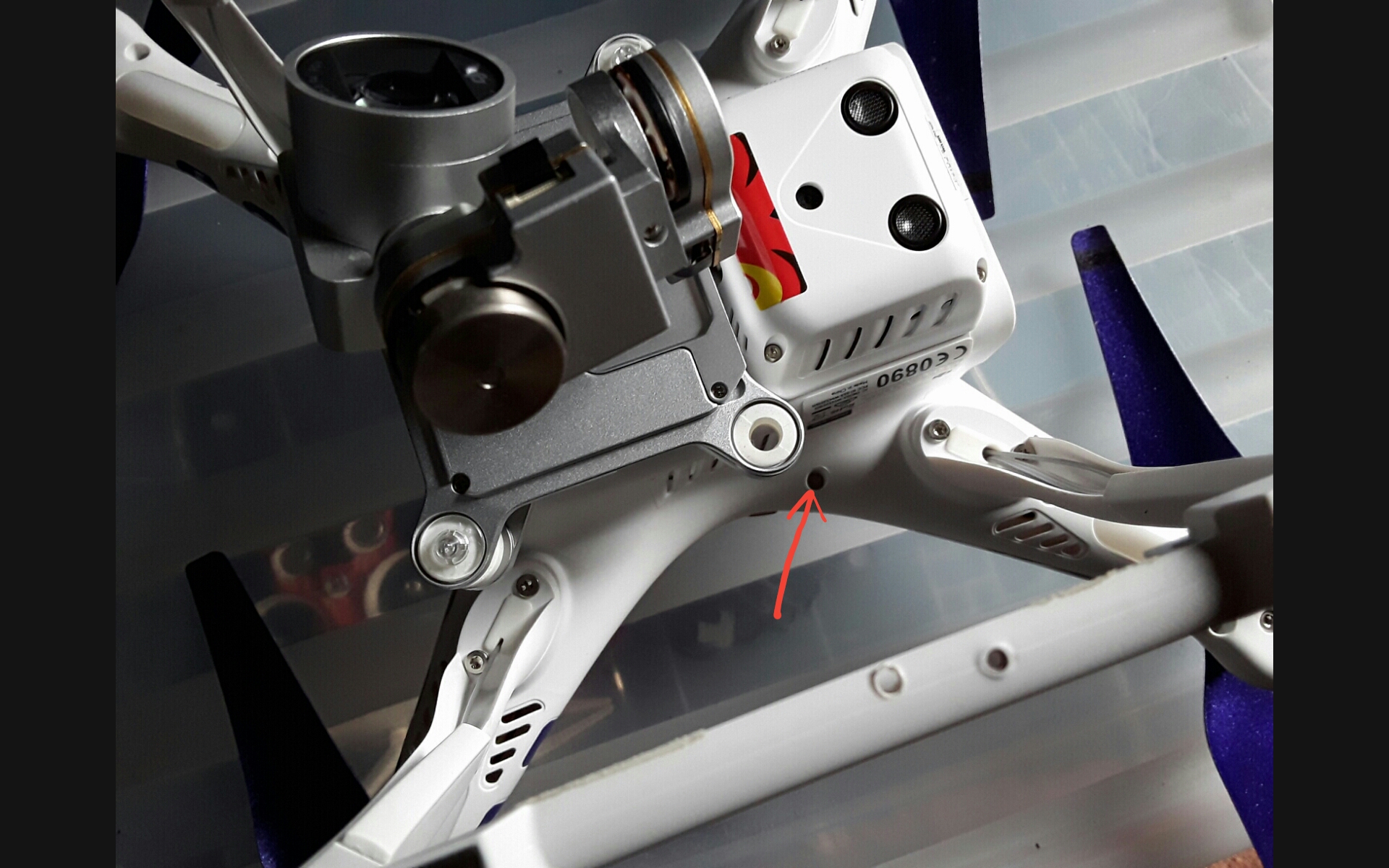

Tech support and the manual refer to a link button on the aircraft but I have now had 2 refurbed units from DJI and neither has this button. Is this normal?
I am new to this and picked up a refurbed unit to learn. Seemed like a good price and better than getting a cheap drone as a throw away ;-)
I am new to this and picked up a refurbed unit to learn. Seemed like a good price and better than getting a cheap drone as a throw away,,,,no should have link button here

Can you see this part where arrow direction shows,only way they could be missing is if broken ,from memory this does happen on occasion somehow,,and might hear a rattle inside

Wow, that is not where tech support said that it should be, nor where their photo showed it being, but by Golly, there it is! Thanks for that ianzone.
I have had them tell me to send the unit back to them twice as they were convinced that I was crazy that the button was not located on the side of the visual flight pod.
Glad to know where it is if and when I ever need to relink or replace the remote.

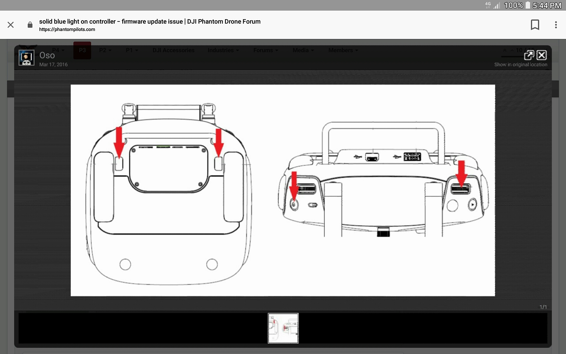

Found this post from @Oso
this method of holding in these buttons and then turn on remote might reset your remote,,,old dji ay couldn't put the link button back ,glad you found it,yes method above might be easy for you for someone to turn remote on for you,it's a bit finger stretching

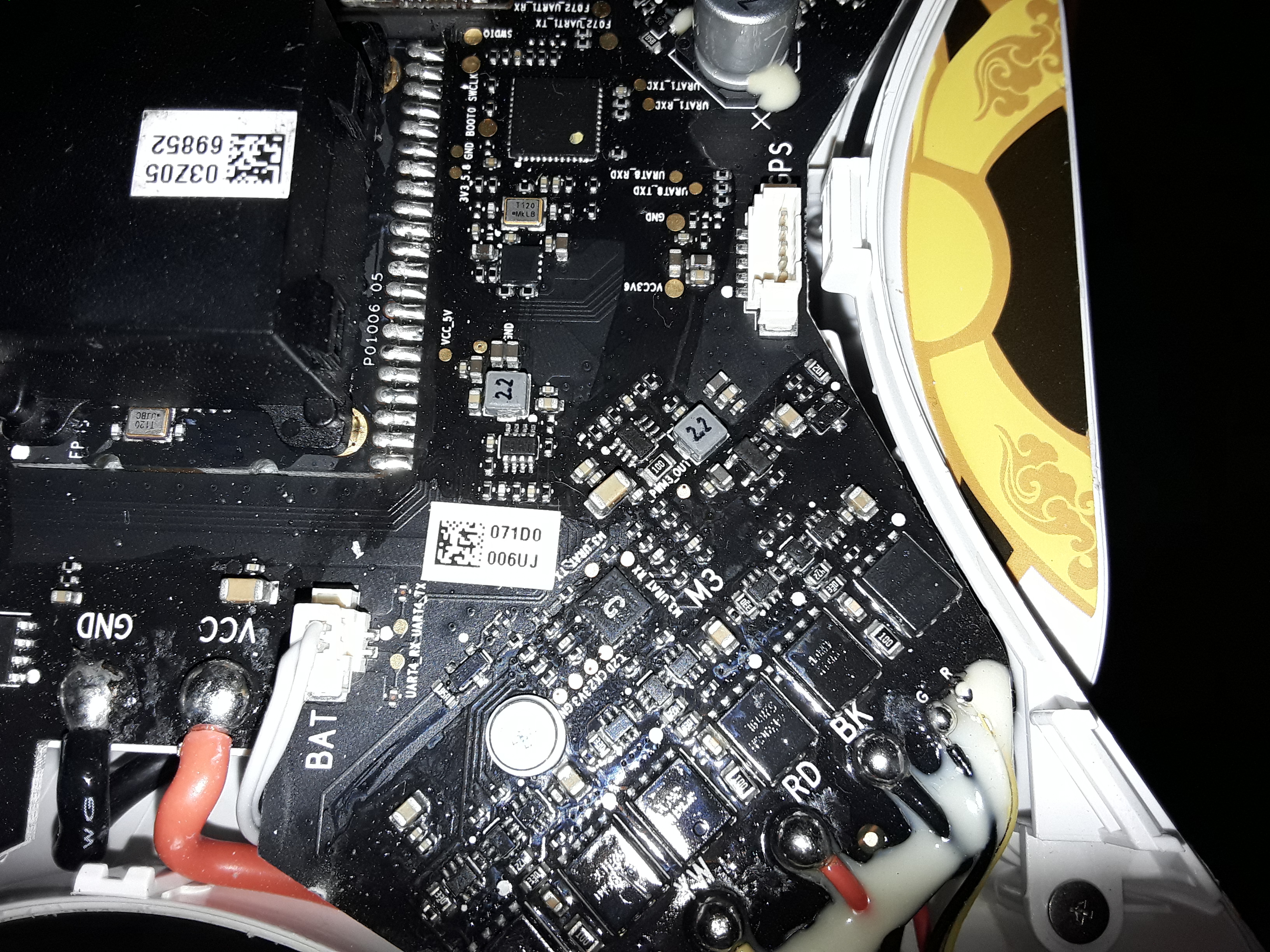

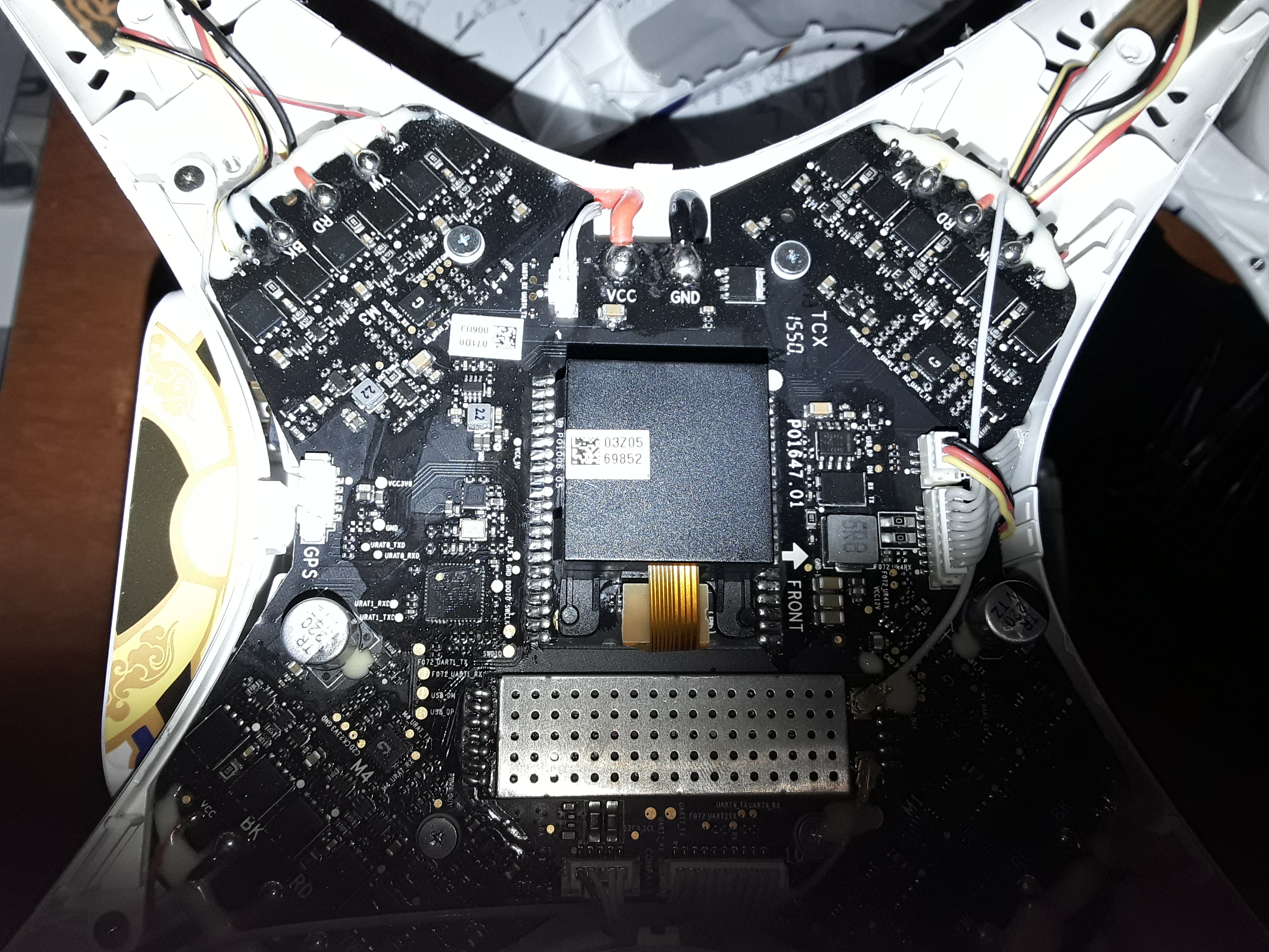

Revisiting the thread a bit later....never got the remote synced with the a/c. After replacing the main board with a new one supposedly for the 4K brings the question, did I really receive the correct board and/or processor? Saw many comments on line and from those selling the DJI parts that the board I bought should work on the 4K, Pro, etc as well. I have no idea if that is the case. I see the “processor” with the SIM card underneath. There are numbers on top of the plastic processor box that are different from the one replaced. Am I jumping at straws or the old one, 03Z06 77511, is different from the new one, 03Z06 21091 and not compatible? As you can see, I don’t know the proper id nomenclature. How about the old board numbers, 07100 00101, vs 007100 001YL. Can someone tell me if chasing rabbits or are these the equivalent components and I’m simply not smart enough to fly this thing again?

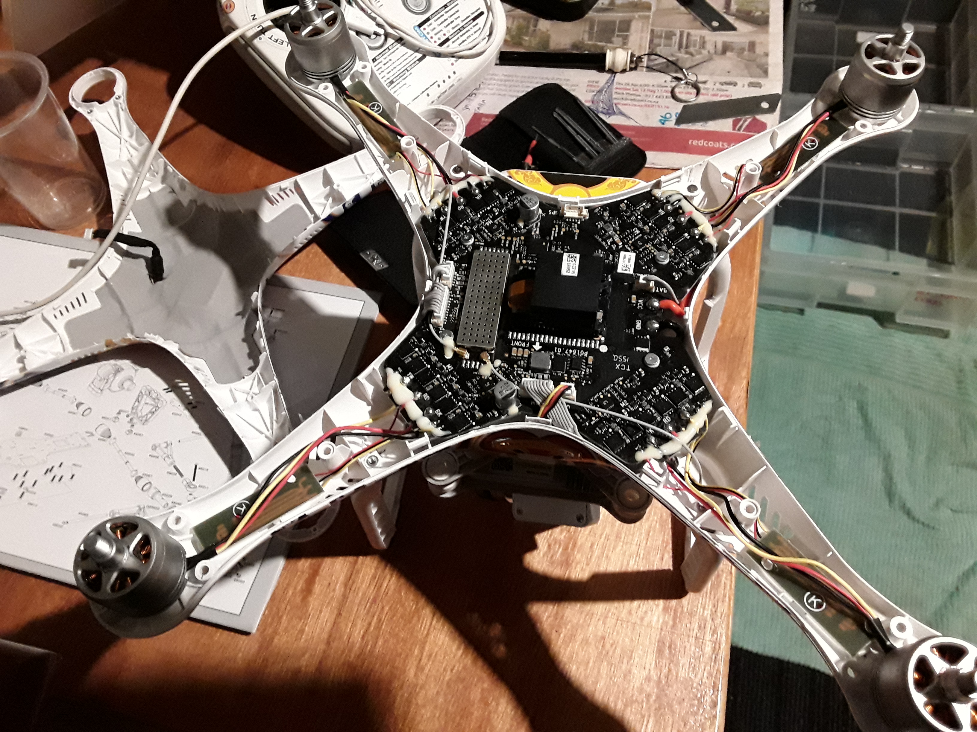

OK your drone give me a headache, my p34k got some stress cracks so I get Hamer and tools out to have a look inside mine,,will post picture when I'm in there :eek:the skillsaw work
...I just leave like this incase you want to see more,or if I not show the right part,
