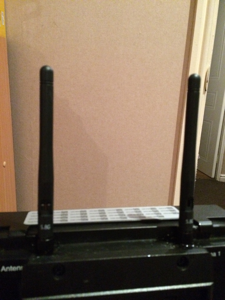

Apologies, i have wrote this completely, its loosing signal at very low range... I didnt have sun screen on as was a dark day. But the monitor was not receivinf the image very well as soon as i got 50M up. Its the Lilliput 329/DW. Cheers
Post photos of your antenna setup on the quad and monitor. It's necessarily the fault of the antennas but in how there being directed. Also watch this video on antennas.
For me, it was antennas. I have the Immersion with a Black Pearl, and it was awful until I spent about $100 on antennas... lol... now it's awesome. Check out the video that Jason posted above, gives a better understanding of how it all works...
Thanks lads... I will pop a photo of both on here to show you. But its just the standard antennas on it. Thanks for link Jason and Ken which ones did you install to them please? Cheers

These are the ones on my monitor and the one on my immersion is just the standard one. Will have a look about and get something ordered then :)
Just hope i can get a little bit more range. Many thanks
It should be a law that these things should be shipped with better antennas... lol... the "rubber ducks" are useless..
I am assuming that you are not in the States, so I hope you can get some decent antennas at a decent price. Heard they can be quite expensive out there...
The antenna on the P2 should be pointed straight down and those on the monitor should be set at 45° so the signal is received along the sides. You also have to realize that when the quad is directly over head the angle of its antenna is not optimum either as very little signal is emitted off the end. I am not saying that changing the type of antennas you use will not improve the quality or distance because to higher gain antennas will make a big improvement.
