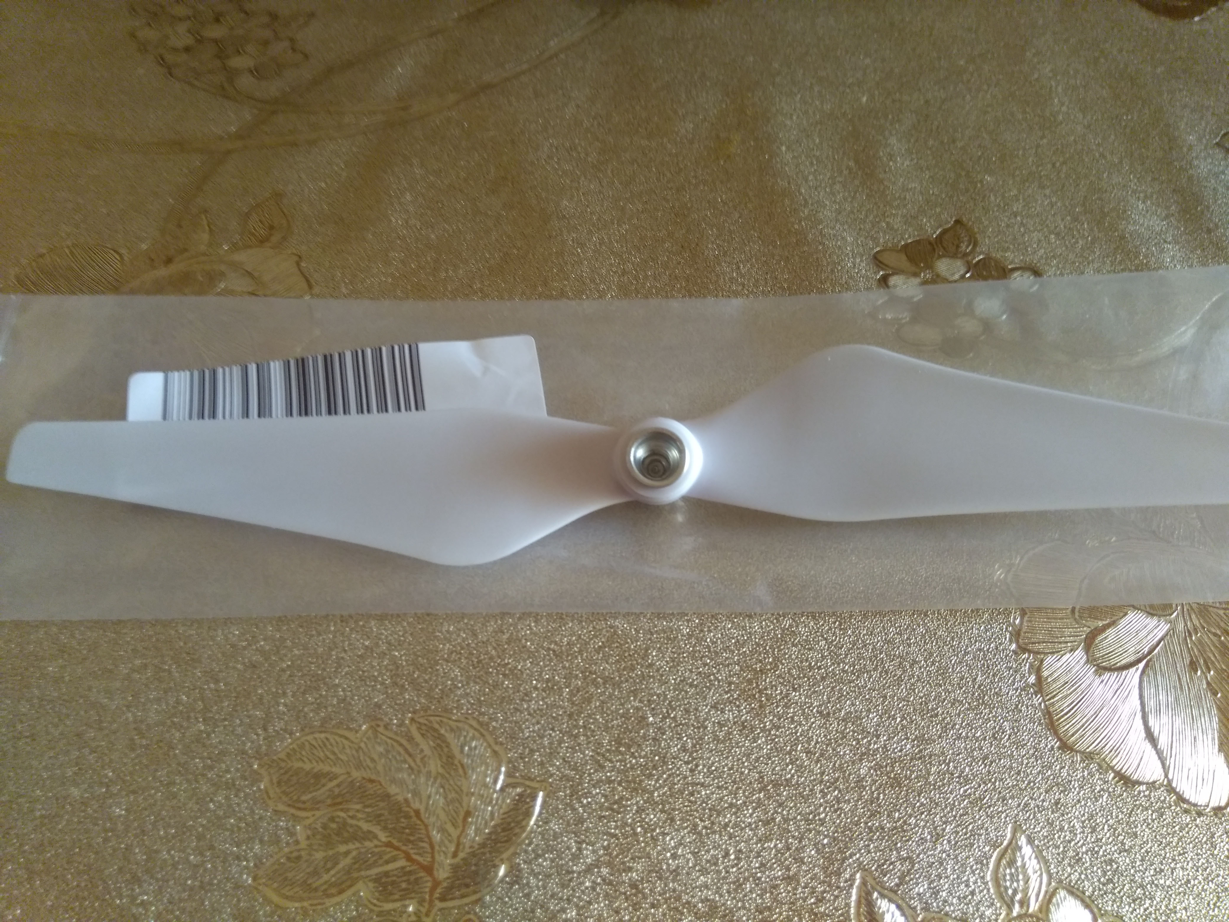

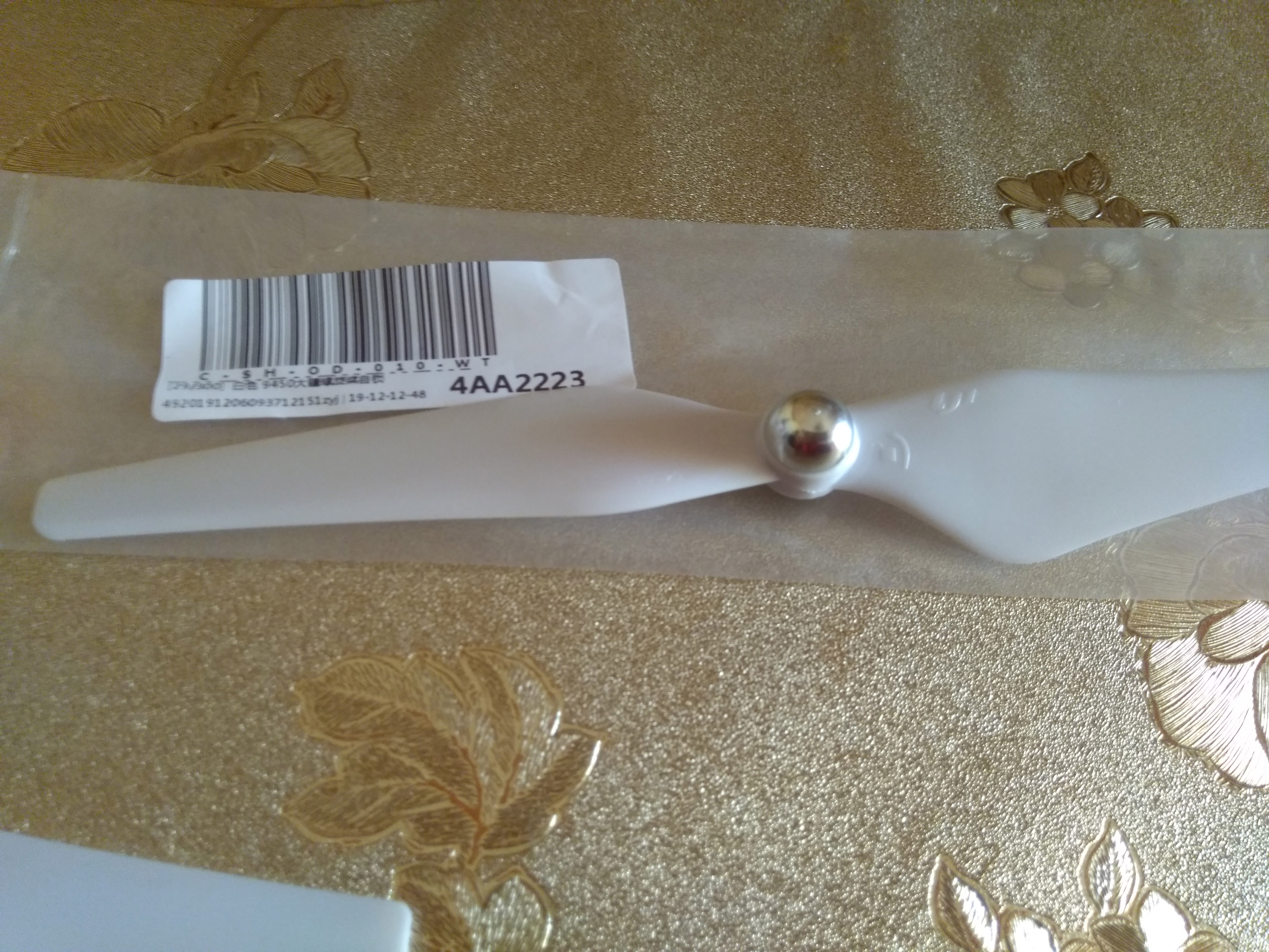

Hello I`ve got new propellers from ebay and it comes with metallic mount fillet. do you have troubles with it?

In summary, most people here will tell you NOT to use them and that's sensible advice because there is not enough friction between the metal of the motor shaft and the metal hub of the propeller and and they could spin off. They are designed for a Phantom 2 drone.
However, I bought a load of metal-hubbed P2 propellers by mistake a few years ago and my modification to enable me to use them has still never failed. (3.5 years now) If you decide to do it, it's at your own risk, of course. See my post about how I do it here
