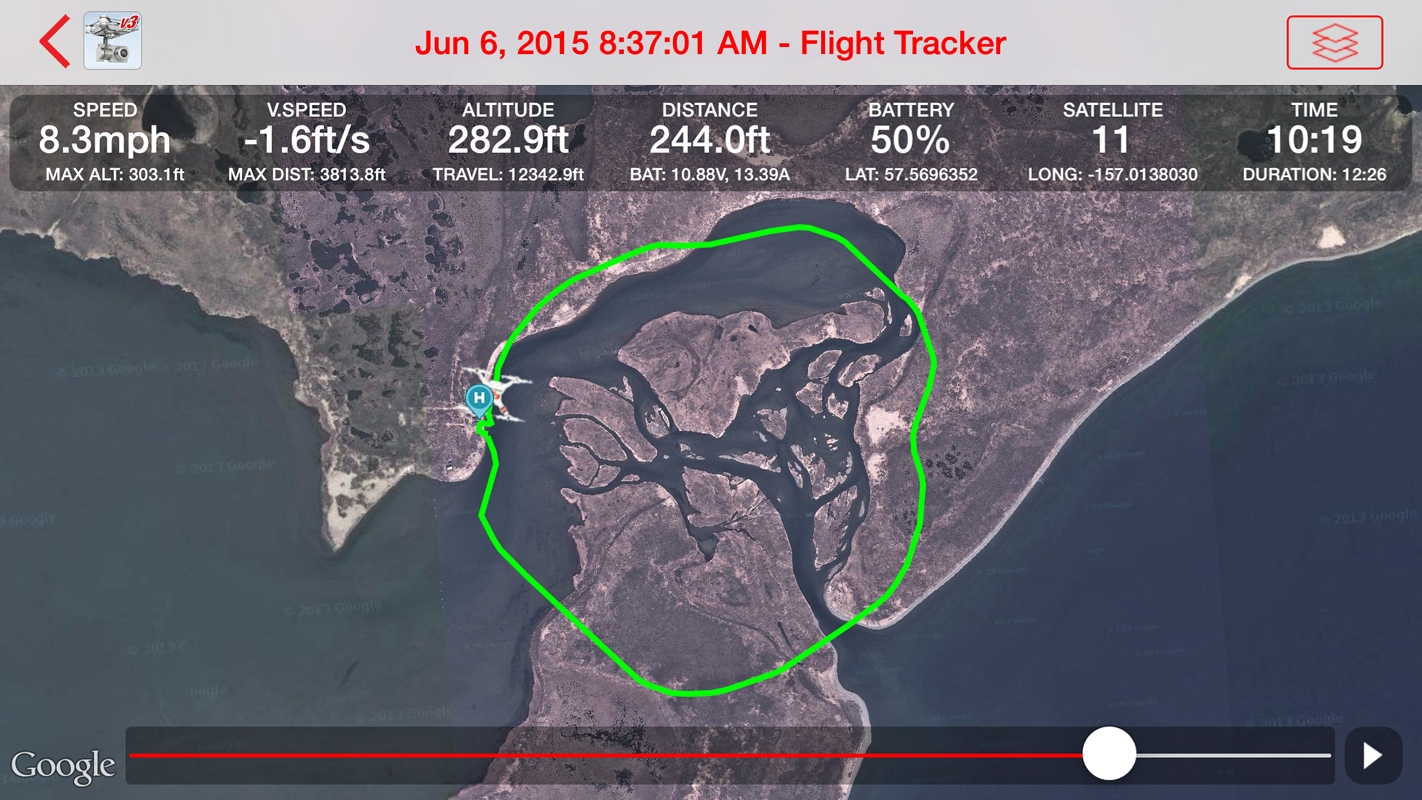

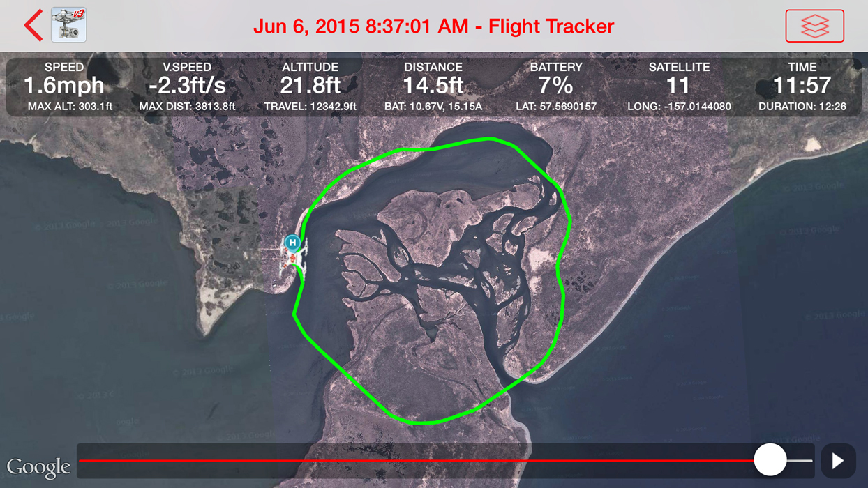

Thanks for the suggestion. I crashed my Phantom today with max damage from what I believe to be a battery failure. Thanks to your apps the two attached logs show battery level at 50% and a minute and something later at the time of the crash the battery is at 7%
Thanks for the suggestion. I crashed my Phantom today with max damage from what I believe to be a battery failure. Thanks to your apps the two attached logs show battery level at 50% and a minute and something later at the time of the crash the battery is at 7%View attachment 21263 View attachment 21264
I suspect the crash was due to bad battery. You may cycle such battery (discharge it to 0% then full charge) and do a hover test at low altitude to monitor the battery level vs. time.
