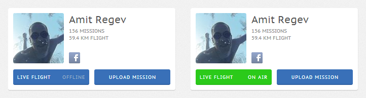

Regarding your question, at the moment we still don't have any button or link available on the user's account that takes you to your Live Flight Channel. This is something we're definitely working on and should have more news about it available shortly.
In the meantime, to enter your Live Flight Channel, enter your Flytrex Profile and add "/live/" at the end of the URL. This link will take you to your Live Flight Channel where you can see your flight telemetry in real time and share it with others.
Not placing a link on the profile page so users can easily access their Live Flight Channel is a HUGE mistake on Flytrex's behalf. Your company needs to realize that 99% of customers are only buying the Flytrex Live device because they want to track their aircraft's position in real time on Google Maps --- otherwise we'd be buying the cheaper Core 2 instead to get the flight data. Forgetting to tell them to type "/live/" after their profile's URL is a VERY important piece of information you left out and it caused me hours of aggravation while I assaulted your website trying to find out how to enable the Live Flight Channel. :oops:
I know you probably won't listen to me since I'm only one frustrated user but PLEASE, PLEASE, PLEASE put a huge button link in the profile page highlighted in neon red and flashing to indicate that's where users need to click to access their Live Flight Channel. Please do this, OK? I will spread much joy and approval of your product on discussion boards if you do this!
Hi MadMitch88 :)
Totally agree - adding a link/button and indication to pilot's profile is essential, can't go without. Development takes some time, but we're really doing our utmost to move forward as quickly as possible.
For some good news -- we just announced on our FB page new site updates. Among the new features we also added a new Live Flight button together with some UI refresh we did to the Profile View display.
Clicking the new Live Flight button takes you to the Live Flight Channel. Plus, the button itself changes color (to bright green) and updates its status to "ON AIR" whenever you fly with Flytrex Live, so others can easily join the Live Flight Channel whenever you take off.
This is of course just a start - much more in that direction is planned, but that's a fair start that should make it MUCH easier for pilots to find their Live Flight Channel and also make it possible for others to see when you're flying.
Sorry for the slight delay - I wanted to reply only after having some good news on that matter. :)
