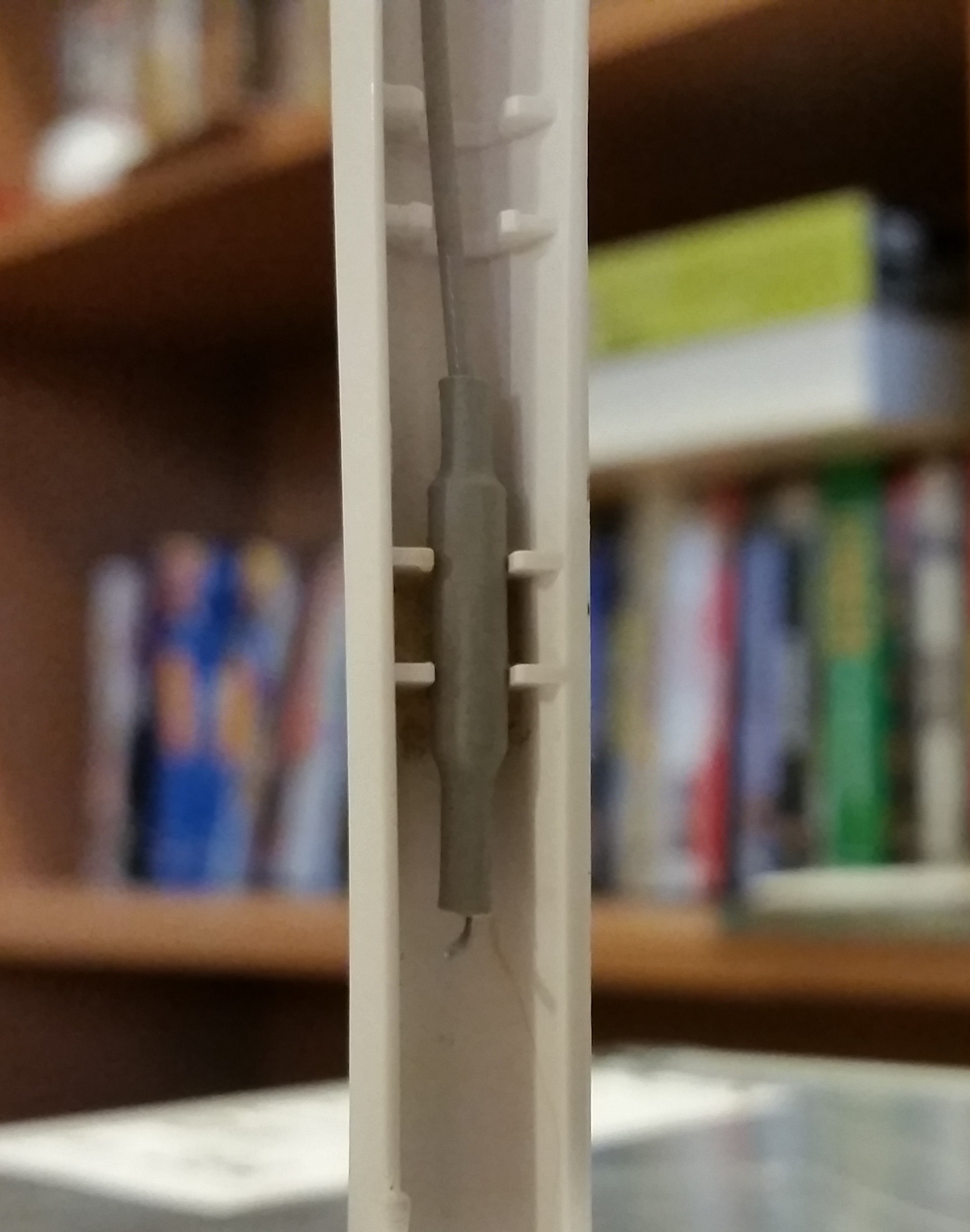

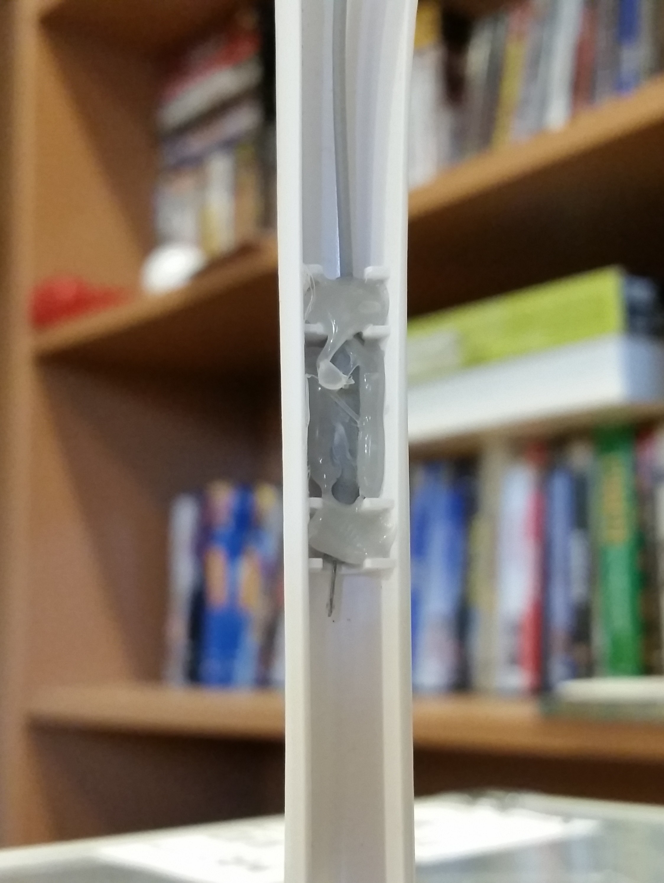

I recently had the bottom shell replaced on my P3 Standard after a mishap with a tree. Now I get no more than a 100m of distance before I lose my signal. Before the tree I had no problems. Is the issue with the antenna on the P3?

I lose the controller signal. I lose video and telemetry and any control. It will come back home and when it gets to 100m I regain control and can begin flying it again
Take it back if it's close enough. Something's not hooked up right. Sorry

I agree try not to cover the antenna with any substance as it could interfere with transmission but to replace the bottom shell I'm sure they unplugged everything from the motherboard you may want to check all your connections make sure none are loose.
Also may I note their are tons of videos on youtube showing you how to easily open up your drone and just watch what they disconnect and connect and make sure everything is exactly the same.
Hopefully, they used DJI OEM parts. Aftermarket don’t always work so good on the internals.
Did they give you the old parts back to compare? Usually there are tiny differences that you can tell them apart.
