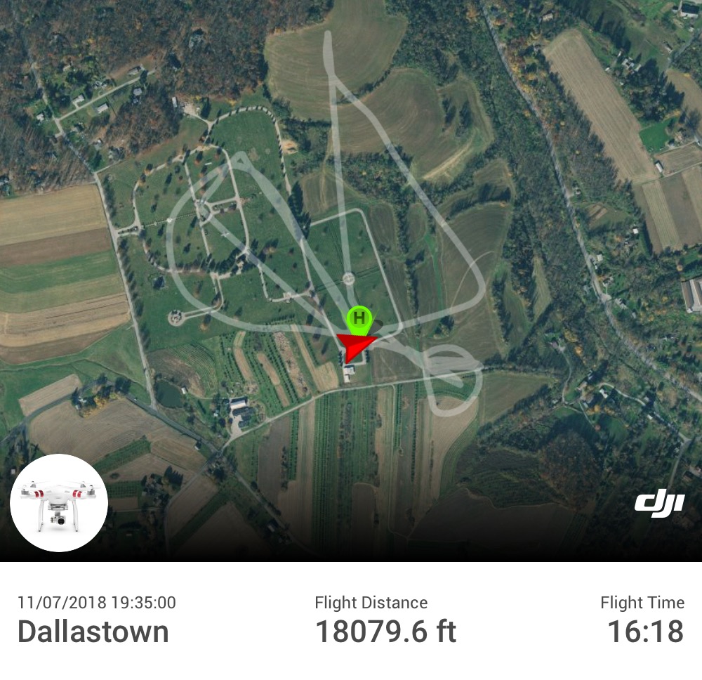

well,, My experience kinda sucked. I purchased 3 of these, ended up re installing the center pole type from the ArgTek original setup, the two alphas on the end 2.4's helped much better with the video feed, actually with all 3 alphas, the distance was WAY less, like 1600 ft, usually can get 2000-2200 ft, (850m range) when i went back to the center pole 5.8 it worked as normal, RTH kicked in at 2270 ft, you can see by the top flight line on my pic below, (cemetery flying) my height was about 350', and the hill it went up was about 150', so it ended up being at 150' high on a hill when i was 150' below. I fly this as my test length all the time and it still did not hit it. I was thinking of adding the power range boosters but too expensive

Check your internal connections. Most are consistently achieving +1 mile range with the Alfa panels. The Alfa APA-M25 out performs the Argtek blue proton antennas by a spectacular degree in my experience. The only setup that may outperform the Alfa panels without adding amplifiers might be a DBS mod.
