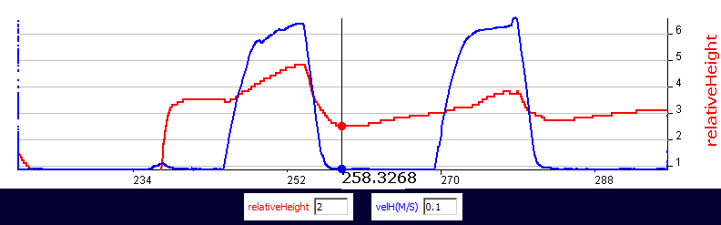

Neither P4P will maintain altitude
I also had a look. At the beginning of the run the AC gains altitude as it starts to increase speed. There is a descent, but it's not gradual; it's all at the end of the run where the AC slows down. After the run there is a gradual increase to get back to the proper altitude. Here is the first run out past the baseball diamond and the second run back to the home point.
The first run started at 244 where the speed started rising above 0. The AC had gained 1.5 meters in altitude by the end of the run and braking started. This is where the drop of 2.5 meters occurred. Finally, at 258 secs the AC had stopped, was hovering and the gradual ascent to home point altitude started. That gradual ascent was cut short by the beginning of the second run back to the home point.
My P3A, P3P, and Mavic do this. I've looked at a couple of P4P flights that I have data for and they do it as well. Doesn't matter if it's the .DAT file from the AC or the .txt from the App. In fact ,one of my flights used AutoPilot.
It's apparent from the videos that there is a gradual altitude increase after the run and the AC has stopped. But, to my eyes at least, an altitude change in the first part of the run isn't apparent. This means that, in my case at least, that I'm not able to see the drop while the AC is in motion. Without actually knowing the profile of that drop I would probably assume that it had to be gradual. I would also expect that if the AC were flying straight at me it would be very difficult to determine if the descent were gradual or occurred during the braking.

Good point but I'm not so sure the phantom is actually ignoring GPS elevation. Had a quick look at the data:
Right after he pitches full forward and the phantom begins its forward traverse, GPS altitude (erroneously) spikes up in altitude while his throttle remains neutral. Going by the assumption that the flight controller is not ignoring GPS data (P mode?), I'm thinking it's trying to compensate for the unwanted GPS elevation increase by attempting to descend.
Right after he stops, (and finally receives accurate GPS elevation data) you'll notice a sudden drop in elevation (lower than when he begun forward traverse, since he did infact loose altitude). So the FC corrects this discrepancy by commanding the motors to ascent until it reaches the user requested altitude.
The gradual descent during forward flight and the altitude correction after he stops is clear in the video.

FLY129 had 4 pairs of runs with an out and back in each pair. It appears to me that the behavior was exactly as I described for the previous flight and predicted for this test. I'll get to the video and vps/barometer later.
At the end of the 1st and 4th pair the altitude had returned to the altitude at the beginning of the pair. In the 2nd and 3rd pair there was not enough time for the AC to return to the home point altitude resulting in a gradually decreasing altitude.
The 3rd video was taken during the 4th pair. On the return run the props can be seen towards the end of the run indicating the elevator input had been removed and the AC was braking. This occurred before the pilot came into view. Therefore, the pilot can't be used as a reference when determining if the AC descended during the run.
The last run pair seems to show a discrepancy between the vpsHeight and the relativeHeight at the end of the run that wasn't there at the beginning. In fact it looks like the AC is actually 2 meters lower than the it was at the beginning of the run pair. However, the begin and end locations are different making comparisons problematical. Also, the AC was stopped with a stable attitude at 360 but the vpsHeight continued to change for another 12 secs.
To summarize the AC flew 1580 meters from 3 different locations and returned to 3 different locations. There may have been an uncommanded or unexplained deviation of 1 or 2 meters. IMHO this is well within specs. If the barometer caused the 1 or 2 meters deviations this has been discussed many times in this and other forums. My advice? There isn't anything here to be concerned about.
