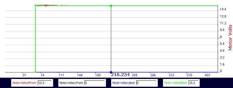

I looked at several of the Motor data values. All of the leftFront and leftBack values are invalid or missing. I think this probably means that the left ESC is fried and needs to be replaced. Here is the Motor:Volts
Note that rightFront and rightBack show around 15.5 volts but the leftFront and leftBack show 0.0.

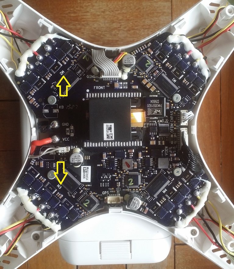

Thanks for the prompt response.
To make it clearer the problem is in the ESC of the M2 and M3 engines?
Right now I'm looking for a new "mainboard V1" compatible with these engines.
Just to know, is there a way to change the ESC and not have to change the mainboard, or is that a job for experts?

Yes, m2 and m3 are the affected motors. I thought there is a separate esc for the left and right motors. But maybe not. @Thunderdrones is an excellent fix-it guy and will know what to do here.

Dear, thank you very much for your help, I have learned a lot with your contributions.
I tell you that on ebay.com I bought a mainboard equal to the current one (center board ORIGINAL MC for 2312 engine). I sent a photo of my broken mainboard to the seller, this way he confirmed that the product is the same.
We'll see how I'm soldering 22 cables :)

With the wonderful tool @BudWalker, I could see that the left side is in ruins .....
I do not have clear the values -1 and 19 in "Motor:state" of the broken side ???
