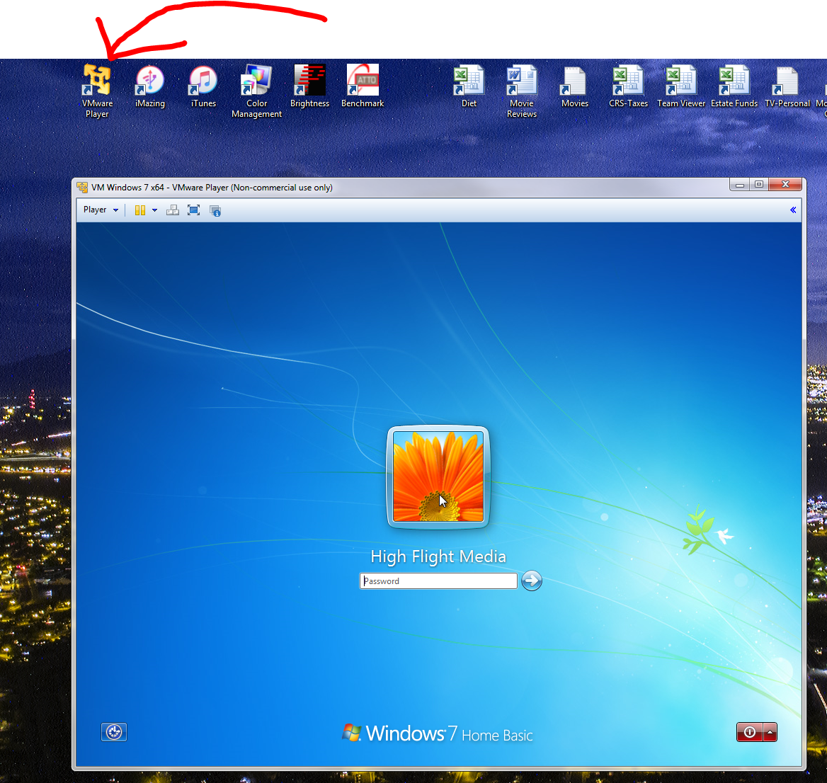

Which Operating System are you using? As crash1sttime eluded to, you may be dealing with an OS incompatibility issue. BUT...I'm pretty sure the NAZA software will run on Windows 7. So if you're on Windows 10, that might be the problem. For issues of this type, I often use VMware to create a virtual environment for legacy software. For instance, on my video editing machine, which runs Windows 7 Professional, I have Window 7 Home Basic installed in a virtual environment for testing purposes.

* Microsoft has their own XP Virtual Machine that works in Win 7, but not Win 10.
* MS does NOT have a VM for Windows 10. The workaround is to use VMware.
* VMware requires that you have a valid COA for whichever OS you're installing. Conversely, the MS version populates the COA automatically. For this reason, the MS version tends to be my first choice.
* Your CPU must support "Chip Virtualization" for these VM's to work.
* Most machines support Chip Virtualization.
* You activate Chip Virtualization in the BIOS, which I believe is disabled by default.
