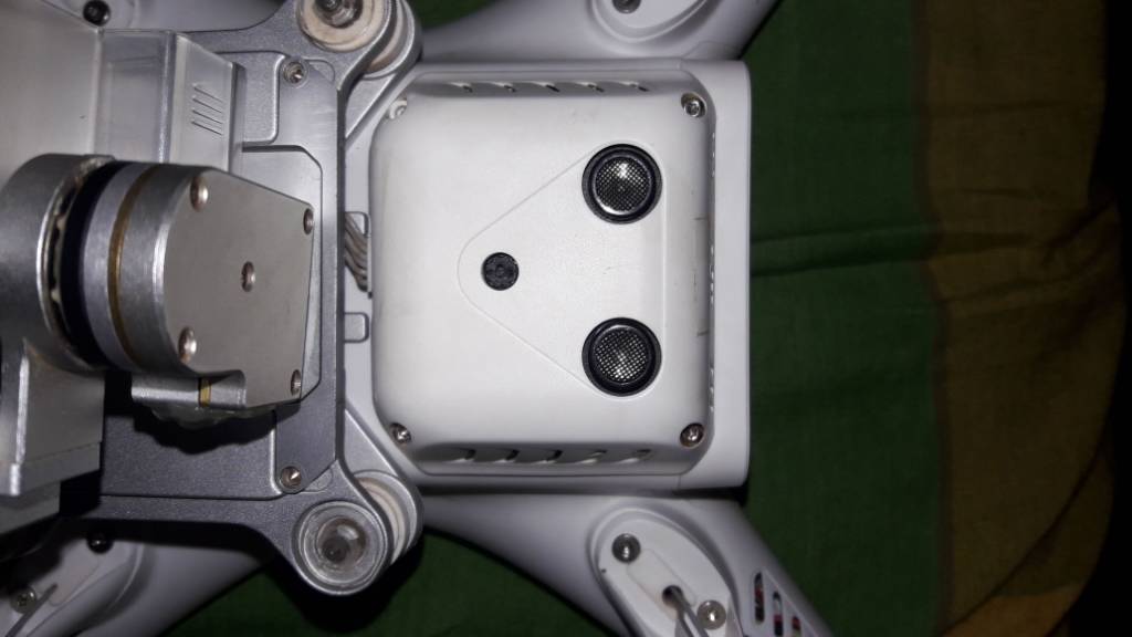

do you ever get the Jello Effect in your videos?
how many drop pins do you have installed on the camera gimbal plate?
There should only be 2 on diagonal corners

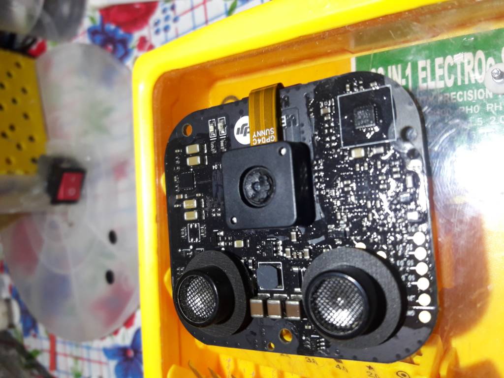

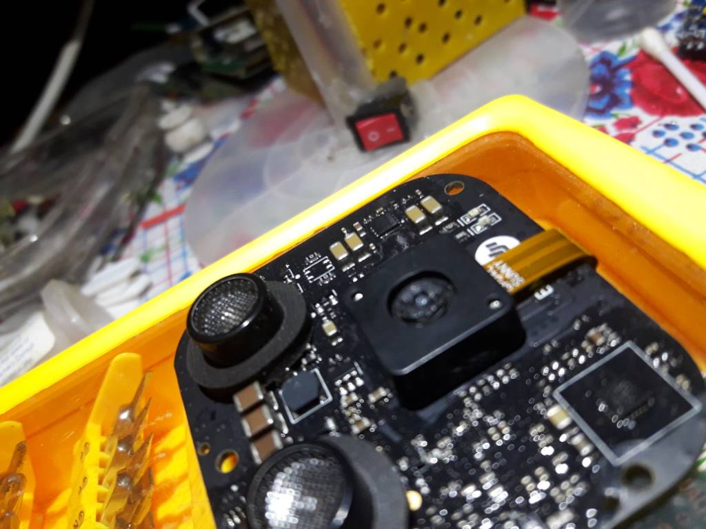

What damage are you talking about? Your issue is probably the area below your AC doesn’t have sufficient illumination or detail to be used in providing a positional reference. Have you made sure vision positioning isn’t turned off?
