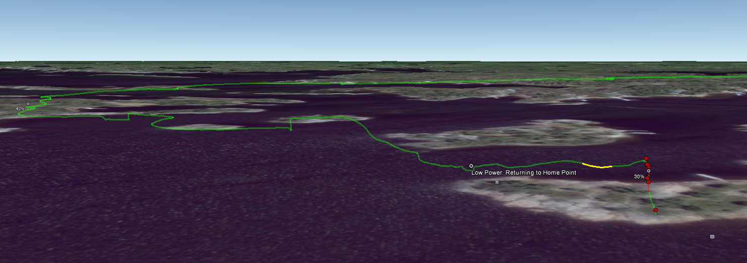

I just located the row showing the initial impact (X-axis accelerometer shows about -12G and other parameters go wonky). It's at 981.613s in the file. In that row, I copied the lat/long and pasted it into both Google and Bing maps which show the point of impact being as indicated in the attached. Bing shows it a little farther eastward of Google, but the nearest tree even from the Bing map is 30 feet away.
Mike

You put a lot of credence in that Bing map ;)
Haha. ;) Not really. The Google map just doesn't show a scale at that level but the Bing map does. My point was that both maps corroborate the pilots account of flying into the rock. And I do think rolling down into the water is a plausible explanation of what looks like a descent at the end. Obviously water is more dense than air so when it enters the water, the pressure in the case will rise (showing a descent) until the electronics are no longer able to transmit. I'm tempted to throw my P3P in my pool and record the altitude. :D
