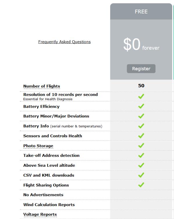

Are you using a genuine DJI battery, because your Healthy Drones battery info has a few bits missing, from what I remember. No external, or internal serial number and no manufacture date. Also, it only shows one charge cycle, so I presume it's never been used before this flight.
I haven't used Healthy Drones since last year, so I could be wrong. :rolleyes:

Yeah, I do have three batteries but this one has been cycled down to 50% three times I think. It is genuine as far as I can tell. I did buy this one in Amazon but got the one that was "sole and fulfilled" by Amazon and it's identical in every way to the two I got at Best But. I was wondering the same though after the HD report but it was my first time using it and the next gent is right, they limit info for free users and the battery is part of it I think.

Well, it doesn't look normal to me. I just tried a test record and the battery data is still included.
I will have to try again and see if something messed up. I agree it looked more like something is "wrong" than "limited". I did charge it up and ran it down to 50% (two more times) and the battery looked perfectly fine in the DJI app.
