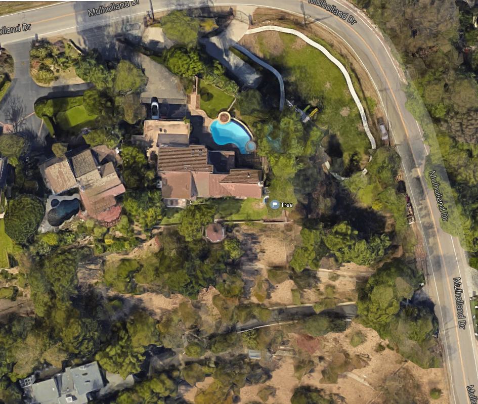

This is the tree your drone crashed in to: https://www.google.com/maps/@34.1294854,-118.4213849,126m/data=!3m1!1e3

Here is a better view of how I didn't realize I was walking on someone's property until I did.
I was where the cars are. If you watch the video (you can't really tell from the pictures), the valley is 100s of feet deep. Now I don't even know if this was my actual path. I just sort of guessed from memory TBH, but I wouldn't lie as there is no reason to. I am not here trying to figure out property laws, I am here to try and figure out why my P4 went off course but to satisfy your desire to know why I ended up on someone's property without permission, I offer this.

So here is a better view of the actual how I ended up there. Of course I would rather have knocked first. I was just looking for my P4 and didn't even know for sure it was not retrievable in a bush somewhere at that point.
*By the way, I did walk around that house that you see there on purpose. I could see that my "feet away" was getting closer but slower as I walked around that house but I did so to STAY OFF THEIR property so that also sort of kills your theory that I ended up on their property. They also asked me how I ended up there and I told them it is perfectly accessible from the valley and they thanked me because now they will put up a fence. Both they and I were surprised I was able to climb up that VERY steep area from the valley to their property.
