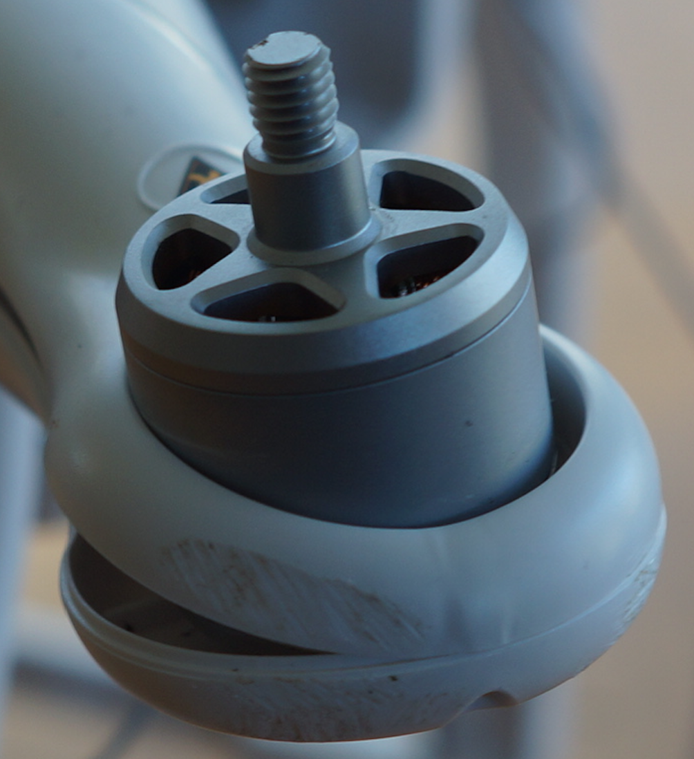

I applaud you for going through the effort to rebuild. I'm hoping someone will buy mine on eBay and combine it with another one they already have and build a "Franken-Phantom". Here is a close up of the top of one of the motors. Comparing it to your post above, I think it's safe to say these are the "new" motors. 2312A.
Yes, those are the new motors alright!
You can tell by looking at the motors. If the bottom is square and does not have the 3 circumference lines just above the motors then they are the older ones. The flat bottom motors with the 3 lines circumscribed are the new motors. It should be noted that the motors are NOT interchangeable. Below is a clip from DJI website on compatibility. I was going to replace the ESC board because I had a few loose connectors after my crash and almost bought the wrong ESC for my motors:

...and the star on top of the motor is "tapered" and flat towards the tip in the new motors. :)
