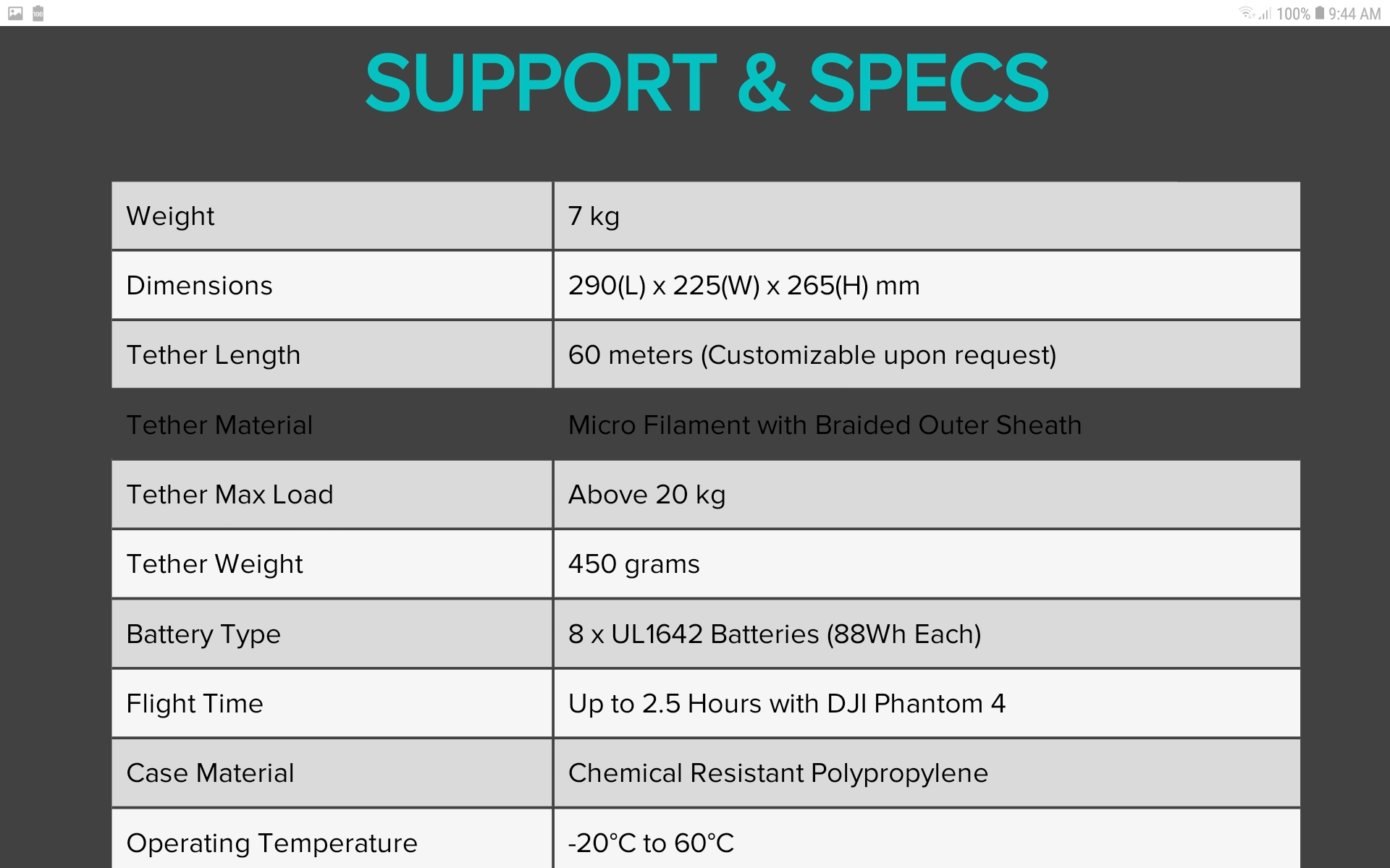

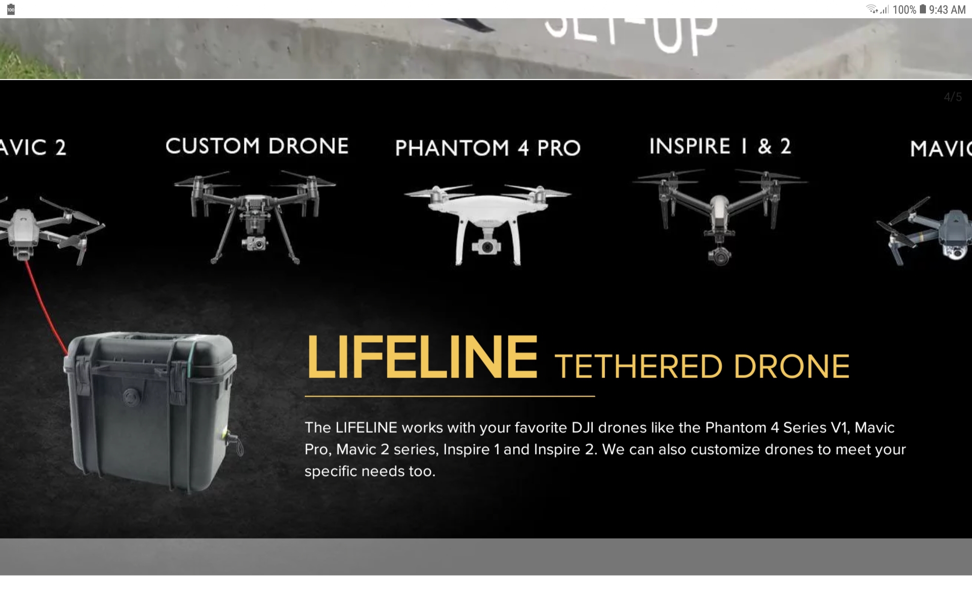

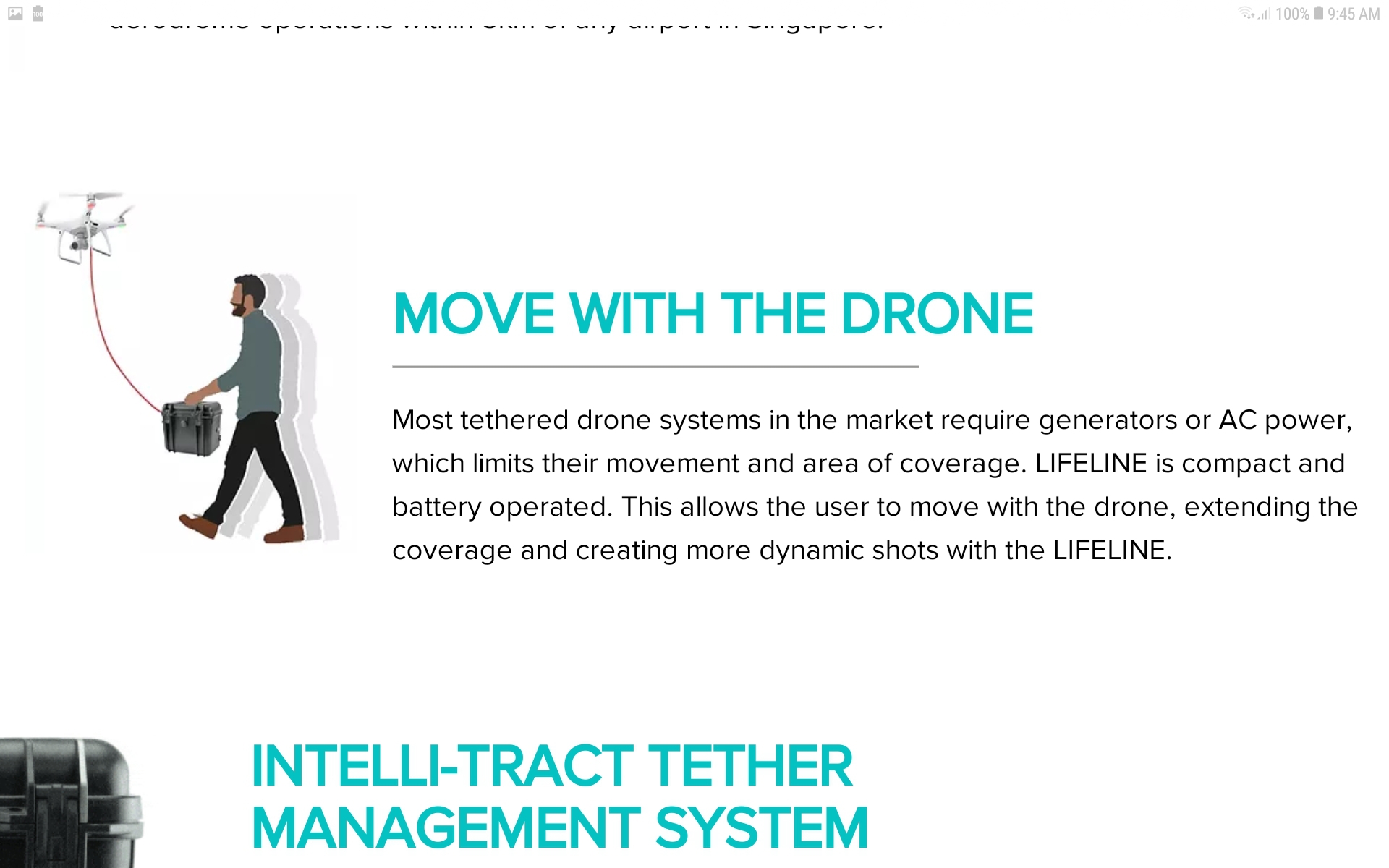

Only if you want it to be on tethered cord like this or you have to invent a battery pack....this set up costs thousands,only trouble in my opinion for long flight times is the internal heat,things get very warm with normal flights,,also add your limited by the battery box compartment on the drone ...good question though

Looking for a mobile option. No point being tethered by a cord.

Yip realize that but there ain't one,,you will have to design it,I'm sure now the 30 min fly time for p4p is max they have made for the phantom.....only way to get round this is buying a upmarket matrice drone with longer flight time and that's not cheap...ps...I dont like extension cords either
