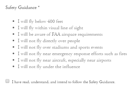

If there is no rule against flying above 400' AGL, I wonder what this pledge is for when you register your drone as a hobbyist.

Notice how the pledge says guideline? Not law. They can make you pledge to "intend" to follow it but it's not lawfully binding. Did you read what I posted from the AMA?
As for the rest, off the soapbox please. Every situation is different. You can't apply a blanket rule to everyone about the 400' guideline and proclaim everyone who flies above it is being reckless. I'm just telling you what the law says, regardless of what some unconstitutional bureaucracy tries to make you believe otherwise.
