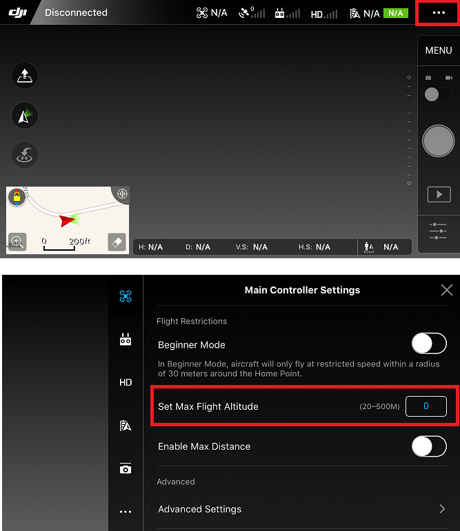

You can increase the max altitude in the following section of DJI GO:
